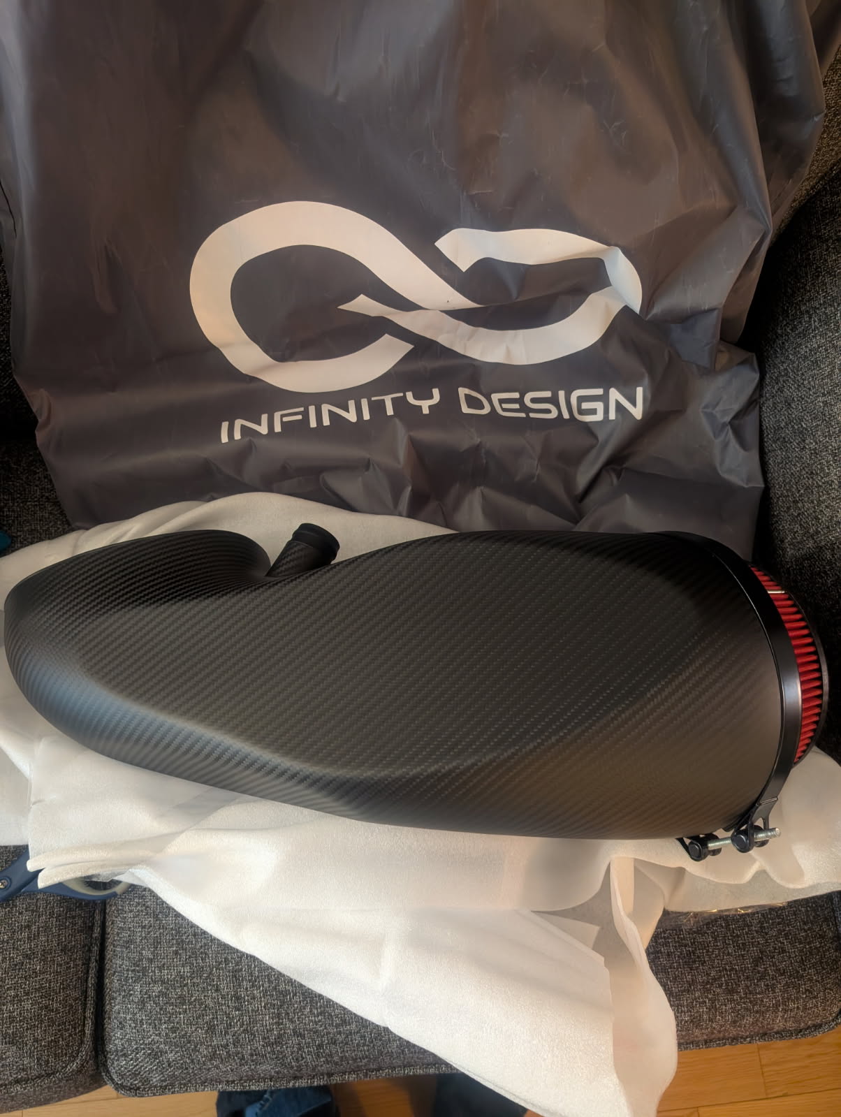

This air intake system has been on my radar for a while and I decided to order one a couple of weeks ago. I finally installed it and I’m very happy with the results. I have to say that this system is worth the price of admission. Everything is top notch, whether it’s fit, finish, overall quality, looks or sound.
The system comes very well packaged in a single box. The complete airbox and elbow(with air filter) are wrapped in foam and are then put into their own separate string bags with the name and logo of the company on it, a nice premium touch.

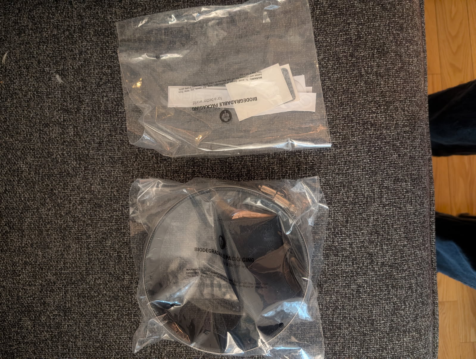

There is a separate plastic bag containing the silicone coupler and clamps for connection to the plenum and the rubber coupler that goes between the front air duct and the airbox. You also get a nice looking certificate of authenticity to prove this is the real deal.
When it comes to installation, it’s nothing complicated, but some steps have to be done in the right order. After removing your old intake system, you can start by installing the bottom of the airbox first. You then have to reinstall the stock front air duct with the provided rubber coupler attached to it and slide the coupler on the airbox inlet.
After the front duct is back in place, you can now install the elbow with the air filter already attached to it. Just make sure the air filter is well seated in the elbow and the clamp is well positioned so the seal is good. I tried installing the silicone coupler on the plenum first, but I had a hard time sliding the elbow in after. Putting the coupler on the elbow first was the better way to do it for me and I was then able to slide the coupler over the plenum inlet.
Infinity provides a warning to not overtighten the clamps as carbon fiber can crack. Only use hand tools to do this job and don't force anything. Just make sure it’s tight and all will be good.
The last step is to fit the airbox lid. You have to slip it inside the rubber coupler that connects to the front air duct and that can be a bit tricky. I used a plastic trim removal tool to stretch and align the coupler so the lid would slide inside. A bit of patience is all you need. The screws that secure the lid to the airbox are pretty small, so having a magnetic hex key to install them would help. I didn’t have that on hand, so I stuffed all the voids around the airbox with microfiber towels to prevent the small screws from falling in the engine bay. I suggest you do the same even if you have a magnetic tool, it might save you a headache.
When you’re done you notice everything fits perfectly and looks as if it could have come from BMW if they had made a full carbon intake. The fit and finish are amazing, this system is a work of art, truly impressive. It looks incredible in the engine bay.
The sounds of it are intoxicating as well. My car already had an Eventuri plenum with a Dinan intake, so it already sounded great, but this takes it up another notch. If coming from a fully stock intake, the difference would be even more noticeable.The carbon fiber airbox, the mammoth elbow and huge 170 mm air filter just intensify the intake sounds even more. Punch it around 3500-4000 rpm and the sound is spine tingling, you can’t get enough of it. There’s a more agressive bark on downshifts that is addictive as well. The throttle response and power delivery feel great, even better and more urgent than before. Maybe the increased noise helps to make it feel that way too. In any case, I think there was an improvement in those two areas and it just feels awesome. I will say that the pairing of the Eventuri plenum with this intake system is heavenly and the absolute best full intake system for this car in my opinion. The finish on both matches perfectly, which is a bonus.
Overall, this is a 10/10. It’s not cheap, but if you have the money and want the best, this is it.
