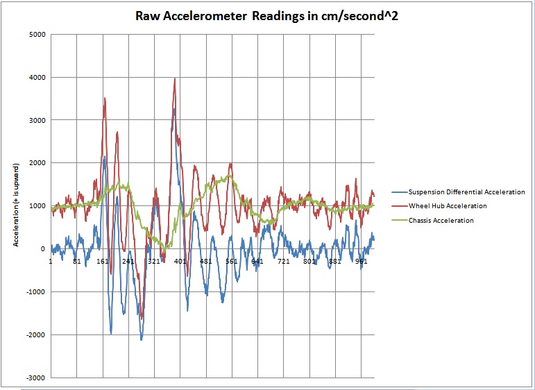

For those of you following this thread, ponder this:
I think it's kinda cool, actually.
The context is that I ran the car at a modest speed over a speed bump. As you can see, the wheel (red line) ran over it, the body (green line) followed with a time delay, and the suspension (blue line) ran out of travel twice on compression at about 3cm upward travel with a 5cm extension in between.
The first "run out of travel" event (the blue line rises to 3 cm or so and stops rising) is when the suspension absorbs the rising side of the speed bump. Once there's no travel left, the body has to follow the rise of the wheel over the bump.
As the wheel goes over the top of the speed bump, it starts to drop, but the body continues rising. The suspension droops by 5 cm until the body starts to descend.
The second "run out of travel" event is when the wheel stops dropping down the backside of the speed bump and starts to roll level again. The chassis keeps descending, compressing the suspension down on the bumpstops until it too stops moving. It bounces a couple of times before settling.
The tire plays a critical role in the ride characteristics of the suspension. The brief descent of the "wheel" below ground level is evidence that the tire squashes (allowing the hub where the sensor is to drop below it's baseline position) absorbing some of the impact as the body drops onto the suspension.
Chassis sensor - attached to the bodywork in the engine bay. I strapped it firmly to the strut brace so it moved with the bodywork.
Wheel sensor - attached to the strut body behind the brake backing plate.
Both sensors on the driver's side.
This is a 1 second snippet of about 30 seconds of data, which in turn is one run out of about 15 segments in that specifci excursion accounting for about a half-hour of total data capture. The scale of the analysis is quite daunting!
The vertical index lines are about 0.10 seconds apart.
What do you mean by 'suspension motion'? Which point/part did you attach your sensor to?
For those of you who find this of interest, here's the raw acceleration data that allowed me to build the motion analysis above. The accel data is sampled at 800 samples a second. 980 cm/sec^2 is the force of gravity (one "G"). The max force at the wheel is around 4 G's upward and the max force at the chassis is around 1.8 G's upward and 0 G's (free fall) downward.
The position plot of the suspension is computed by integrating the acceleration to calculate velocity, then integrating the velocity to position.
I'm theorizing that the roughly 80 ms (12 Hertz) oscillation in the differential and hub acceleration time-series is actually "hum" from the tire. It was a 235/40x18 Dunlop 3D snow tire when I captured the data back in March. Referring to the motion picture (the first post above) the red wiggly line in the wheel position picture (the "hub" position) drops below zero when the tire sidewall compresses and absorbs the fall of the car as it falls off the back side of the speed bump.
It's amazing what you can see.

Impressive, that you did quite some ground work on data acquisition, but more so that your approach of double integration of an accelerometer signal results in a clean and recognizable position curve (~ an under-damped chassis with dry/stick friction).
I should ask what you mean by 'run out of travel' events because these would cause sharp acceleration spikes, whereas your position curve looks to be within harmonic boundaries. Did you feel/hear the hard bump stops yourself during this measurement? Perhaps you do mean highest/lowest position on the harmonic curve?

Getting the "clean" signal wasn't easy - it's very prone to small offset errors and to noise, so a full second of sensible results takes an hour or so to process by hand.
The run out of travel events are the flattening of the top of the suspension compression curve. I didn't go over the speed bump very quickly and it only just touches, so the "impact" is only really visible in the processed output - in the raw data it's buried in the noise and rumble. I don't recall a "thump", but then it was a year ago.

Is the process by hand the elimination of errors or more? Did your integration involve some smoothing or data(n+1) = data(n) + d data(n) / dt * delta t?
Looking at it more closely, I see what you mean now: the top of the wheel/suspension curve is flatter than expected from a harmonic signal. From the technical drawings I recon that bump stops nowadays have their own additional spring and damping characteristics, rather then being hard stops but I still would expect a more significant deviation (acceleration spike) from the harmonic line. It could also be related to the shape of the bump (~flat top?) and/or a dry friction effect? Once I have time I wouldn't mind looking into deriving the shocks damping coefficient [Ns/m] and dry friction force from your curves. The mass (or weight), front-rear balance and spring rate of the measured setup would be useful for that (and if willing to share, the measurement data). My goal here is mainly to get a feel for the damping coefficients used in M3 shocks and in the end to quantify the difference in EDC damping settings vs their drive signal.

Essentially, I couldn't find a string of data points (in an hour or more of data) that would behave sensibly for more than a second or so. You're double integrating, so the process is to integrate from acceleration to velocity, detrend it, then integrate velocity to position and detrend it again. If you pick your start and end points when you can be confident that the suspension is at static height, then you can look at movements away from that static height. You can also look at motion from a "sensibility" perspective to see whether the data says the suspension is in places that physically it just can't go.
For sets longer than a second, you don't get consistent trends for detrending. The accelerometer signal has (what I presume is) low frequency noise components that make the integrated result wander around by 10's of cm over a few seconds.
I started diving into old Matlab stuff and found that it lets you record directly from the PC's line-in, but I would need an accelerometer with the right output signal. Did you consider accelerometers with analog output?
I did a force vs velocity curve for the OEM dampers based on the acceleration data. F=MA, sprung and unsprung masses and known spring rates allow you to compute the forces and velocities of the suspension parts and graph the contribution from the dampers. This is actually easier to do because you only integrate once, and you can get enough samples to see the shape through the noise. It was an interesting exercise, but I can't find the data on my laptop, and I may have chucked it in a fit of cleaning up.
