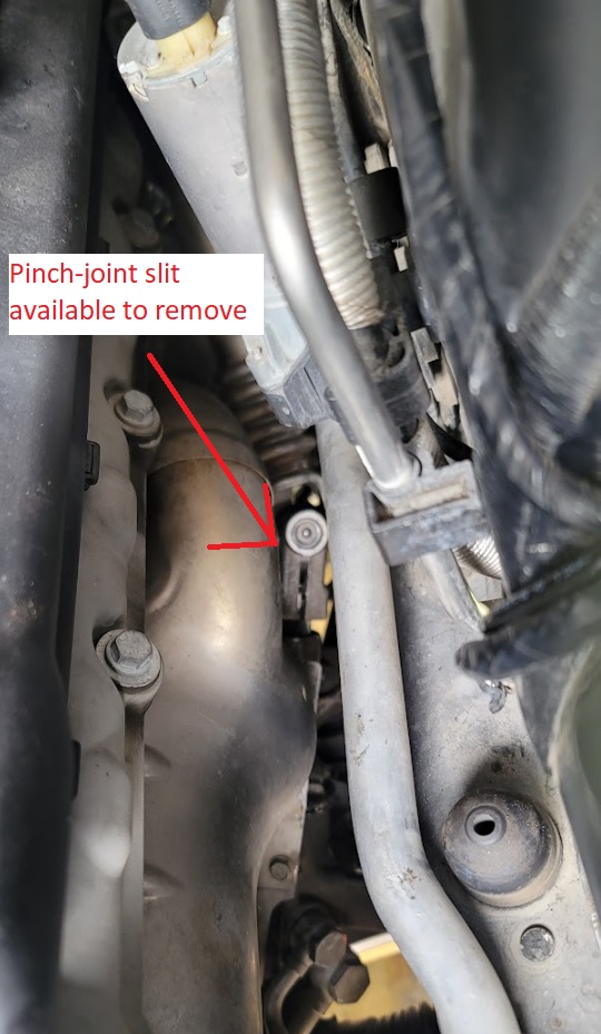

*Find the location of the upper pinch bolt for the steering shaft -- attempt to mark accordingly with paint pen

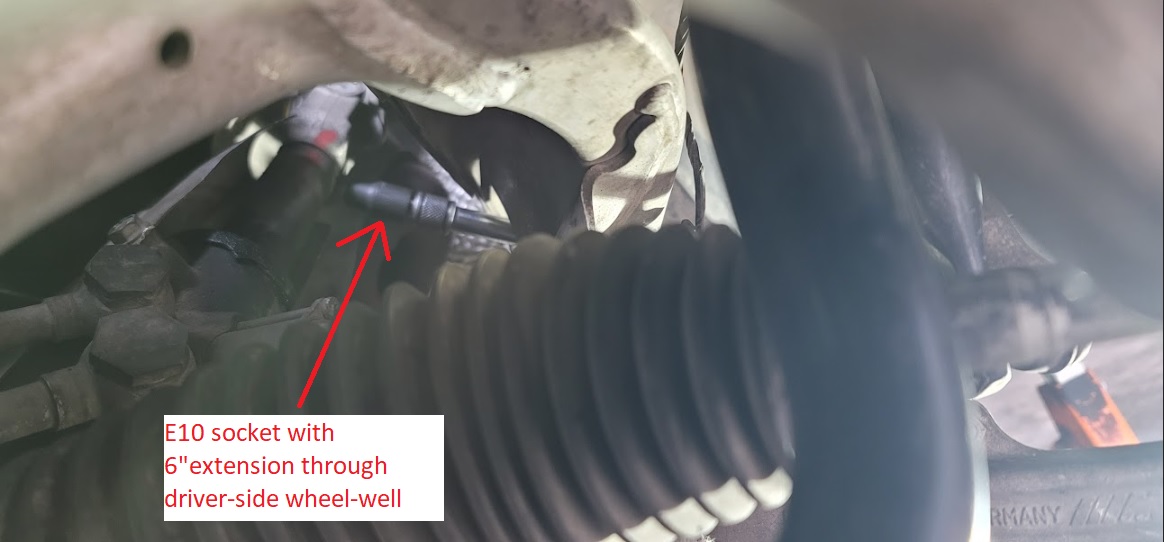

*Move the steering shaft around to gain access to the E10 bolt so that the "slit" is towards the top -- use screwdriver to help "pry" open the pinch bolt

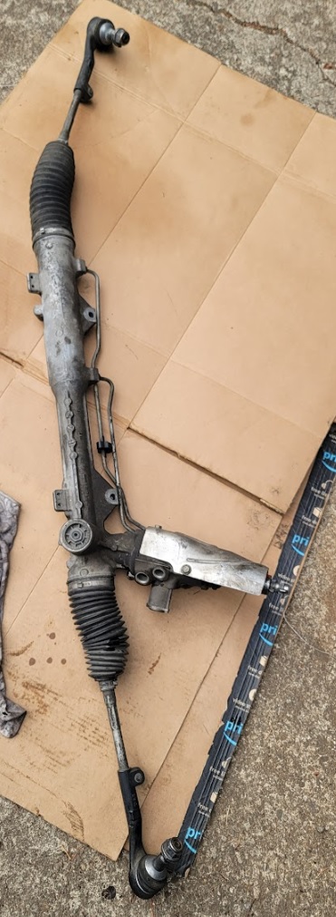

*Get rack out

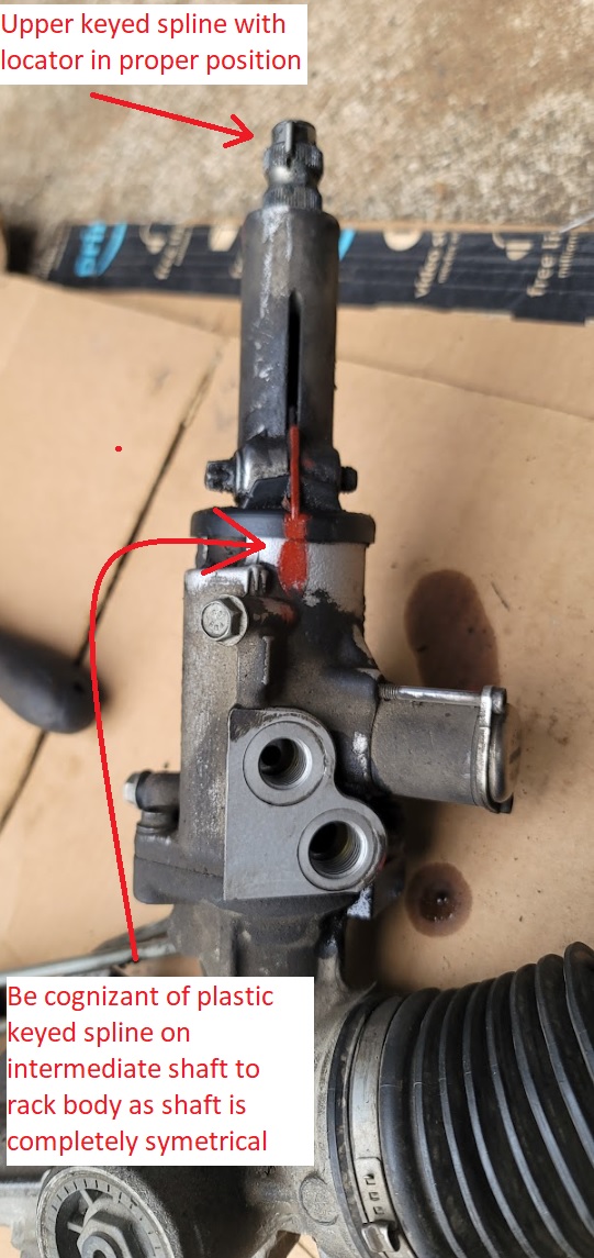

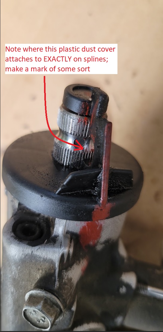

Now you can operate on the rack. Do take care of the position the pinion is in relative to the body! I paint pen this. It's imperative to have the rack go back into the relatively same position. Being off a spline-tooth of two isn't TOO big of a deal, BUT the joint is supposed to be keyed.

*Remove the intermediate shaft -- DO NOTE the orientation of the intermediate shaft to the splines on the rack pinion--this is NOT keyed except by the plastic cover

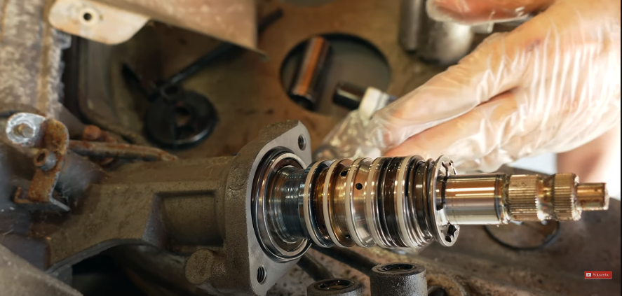

*CAREFULLY remove the pinion body upwards taking care of the *PLASTIC* keyed dust cover -- make sure to note this orientation on the splines!

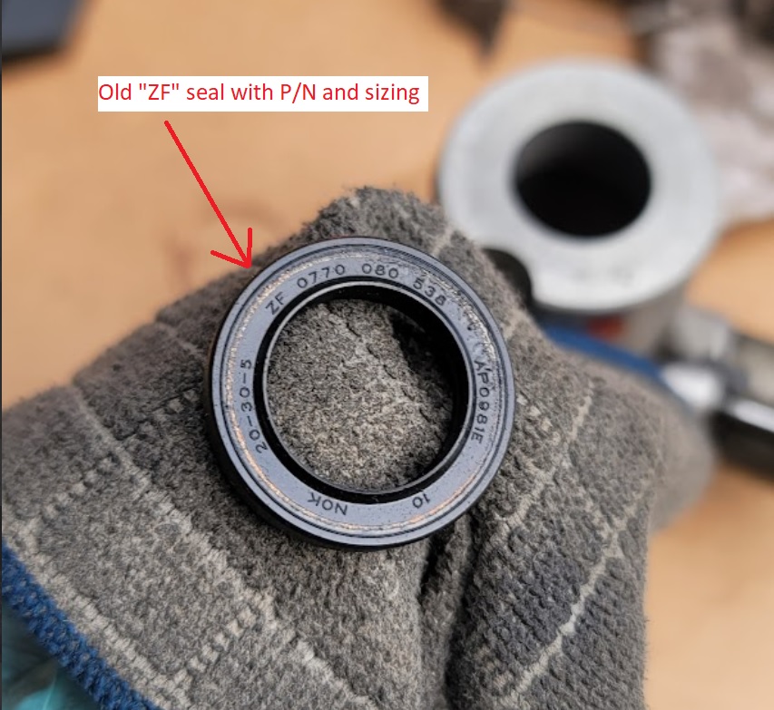

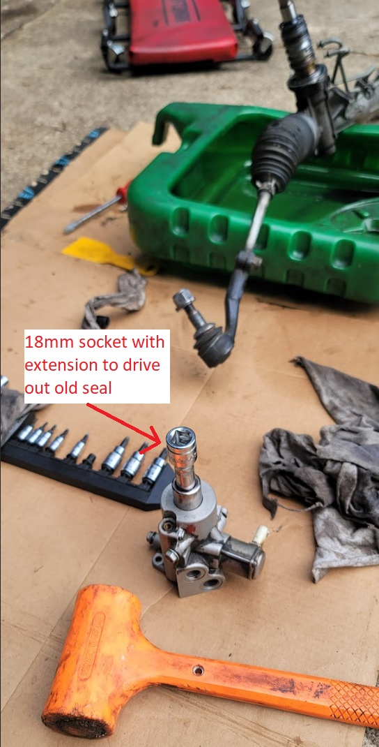

*Slide out of the body and note the offending, leaking seal
*Get a 18mm socket with extension and place the rack body on something soft -- use a deadblow and lightly tap out old seal
*Get a beer and crack open -- hum&haw about how this seal caused so much grief
*Clean the rack body internal (wipe down) and inspect the sealing surface on the input pinion

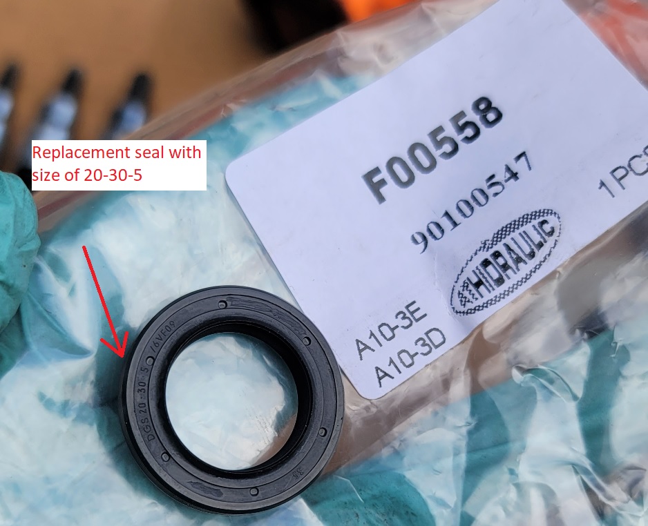

*Get a 7/8 socket and turn around with an extension opposite to use as a driving force for new seal -- PERHAPS lube the seal with grease to help aid with installation of pinion

*THEN take the plastic keyed spline dust-cover and place in same exact position on pinion splines
*Then take intermediate shaft and place back on rack with tightening the pinion E10

1)Undo the pinch bolt securing the bottom intermediate shaft U joint to the steering rack splined spindle. I was planning on turning the steering wheel / shaft it into position to access the E12 bolt via the hole in driver wheel well as outlined on the first page.
2)Then after loosening the bolt I was going to return the steering wheel back to being centered and remove the rack from there based on previous posts about steering wheel needing to be centered. Perhaps this is mistaken. I've read about securing steering wheel centered but I don't quite know how one gets to the bolt that way unless it accessible after removing the airbox.

The intermediate shaft splines that go into the pinch U-joint is technically keyed.
Take the steering wheel and make it "as straight as it can go WITH ACCESS TO THE PINCH U-JOINT." Then what you can do is take your seatbelt on the driver side and WRAP IT AROUND the steering wheel and BUCKLE IT. You want to make sure the steering wheel doesn't move AND it gives you something solid to push onto the keyed splines from the intermediate shaft.
For the old steering rack, try and mark on the casing where that plastic spline key is. Use a paint-pen. On your new steering rack, try and make sure it is as center as you can get it and GUESSTIMATE the location of the plastic key.. IT IS OKAY if you are off a spline or two. You want to be in the "ballpark" as your tie-rods will adjust any slack.
(I'm not sure if your new steering rack comes with the plastic key on the rack's pinion.)
The steering shaft "telescopes" up as the pinch u-joint is removed from the intermediate shaft's splines. I find it is easiest for me to access on the top with the airbox completely removed.

probably too late but for any others I found the EAI 20X30X5mm pinion seal here on amazon:
https://amzn.to/4dHsSG1
But as mentioned earlier, I would prefer to use the CORTECO 01016544B seal if you can find it.
I am still looking for clarification on what the best larger o-ring to use on the base of the servo body from the video is.
