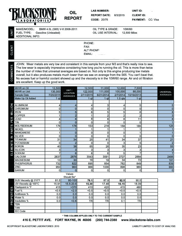

Blackstone Report at 135000 miles. Not quite ready to do bearing yet. I hope.....
4corners wroteFrom what Blackstone is saying looks like your bearings are in good condition, pretty impressive for the mileage.Blackstone Report at 135000 miles. Not quite ready to do bearing yet. I hope.....
4corners wroteWow! 135k miles. Impressive! Have you tracked your car?Blackstone Report at 135000 miles. Not quite ready to do bearing yet. I hope.....
kevin @ eas wroteAs we know oil reports can be completely wrong but it's good to see none the less.From what Blackstone is saying looks like your bearings are in good condition, pretty impressive for the mileage.

4corners wrotefyi im picking up my car from eas either today or tomorrow because of total bearing failure. i had my engine blackstoned 4 months ago with perfect results.As we know oil reports can be completely wrong but it's good to see none the less.
No tracking but I drive it as it should be driven.
steven747 wroteI am certainly aware of this possibility.fyi im picking up my car from eas either today or tomorrow because of total bearing failure. i had my engine blackstoned 4 months ago with perfect results.
