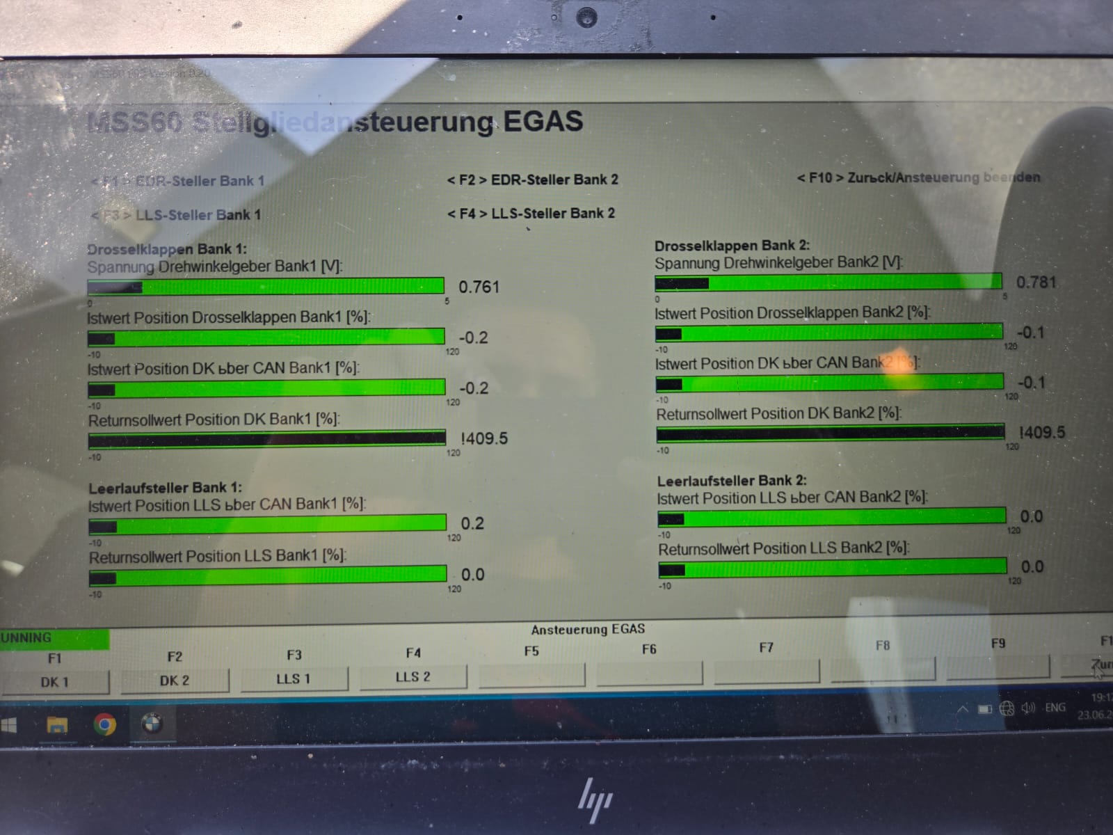

Hello,
has anyone got a known good file for the eeprom on the TA board?
treishu wrote
Hello,
If anyone has one, it will be Jason at Rebuild.org.uk in the U.K.
https://www.rebuild.org.uk/contact.php
tried already but didn't want to share too much about it.
anyway.. after replacing mosfets, power regulators, CAN transciever chip, I am left with an error for predrive check on both banks.
according to INPA it doesn't have it's return position and I'm almost certain that it is a software related issue.
If there is anyone who has a known working dump of the eeprom and possibly also of the main microcontroller, I would appreciate it
Or maybe someone has another idea.

did you ever end up doing this?
i replaced the 5 mosfets
the big voltage regulator
the small voltage regulator
and the can transviever
now i am stuck with 3 TAs that are in predrive check error :))
