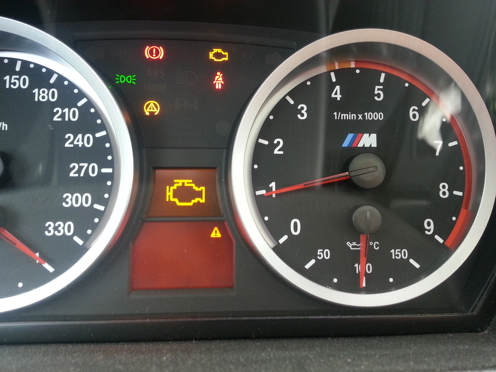

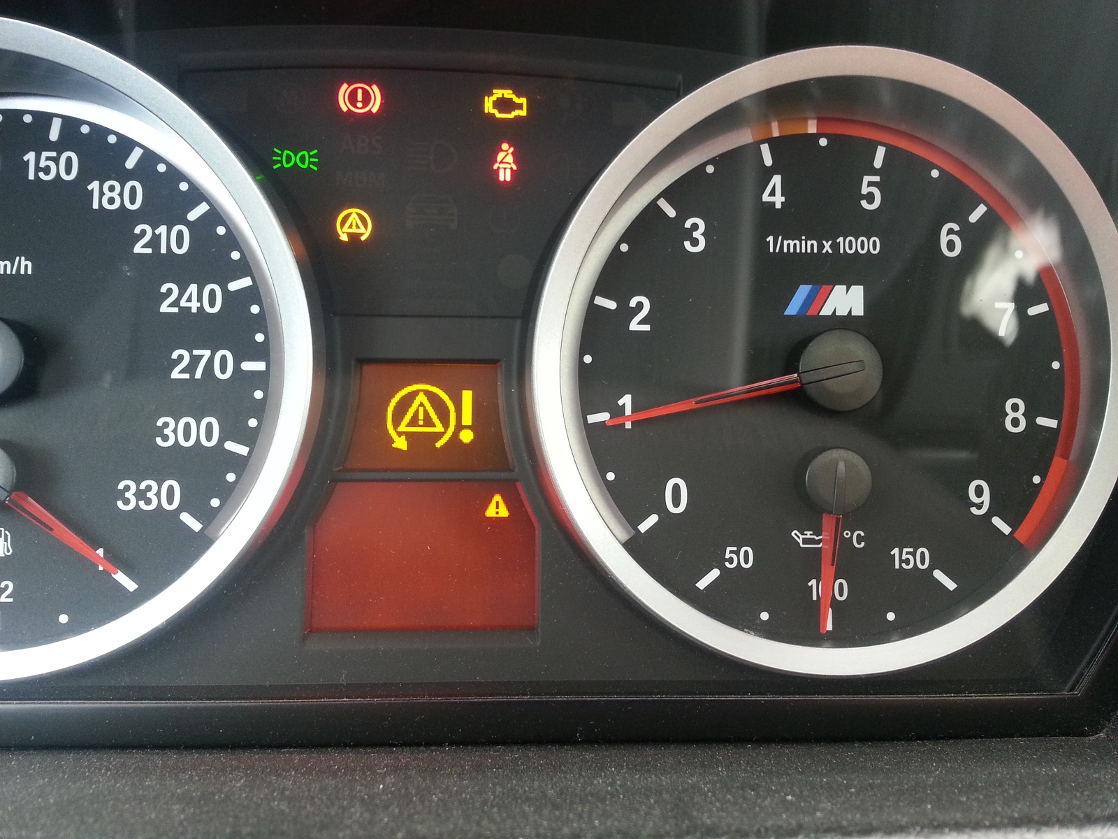

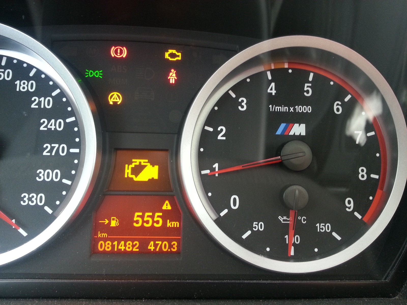

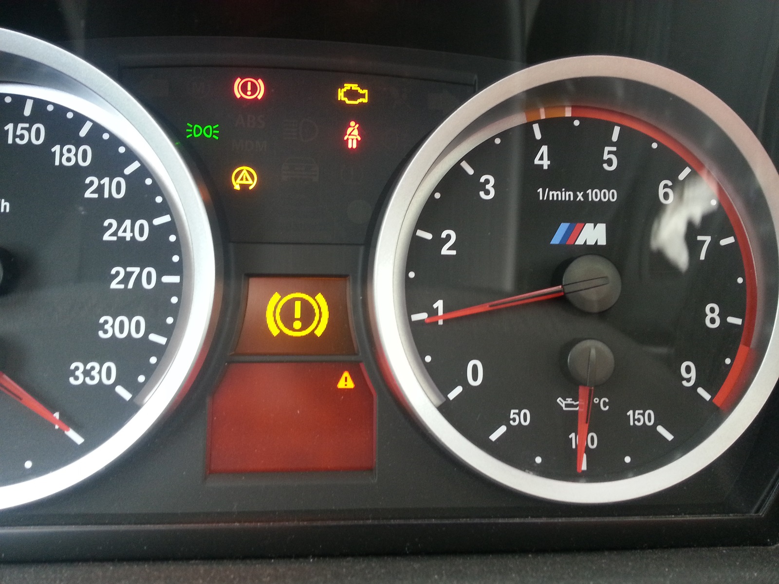

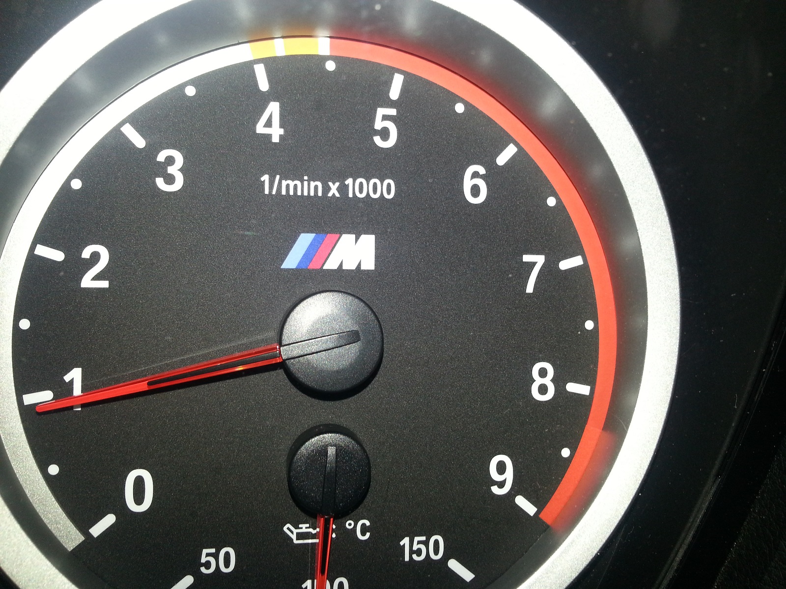

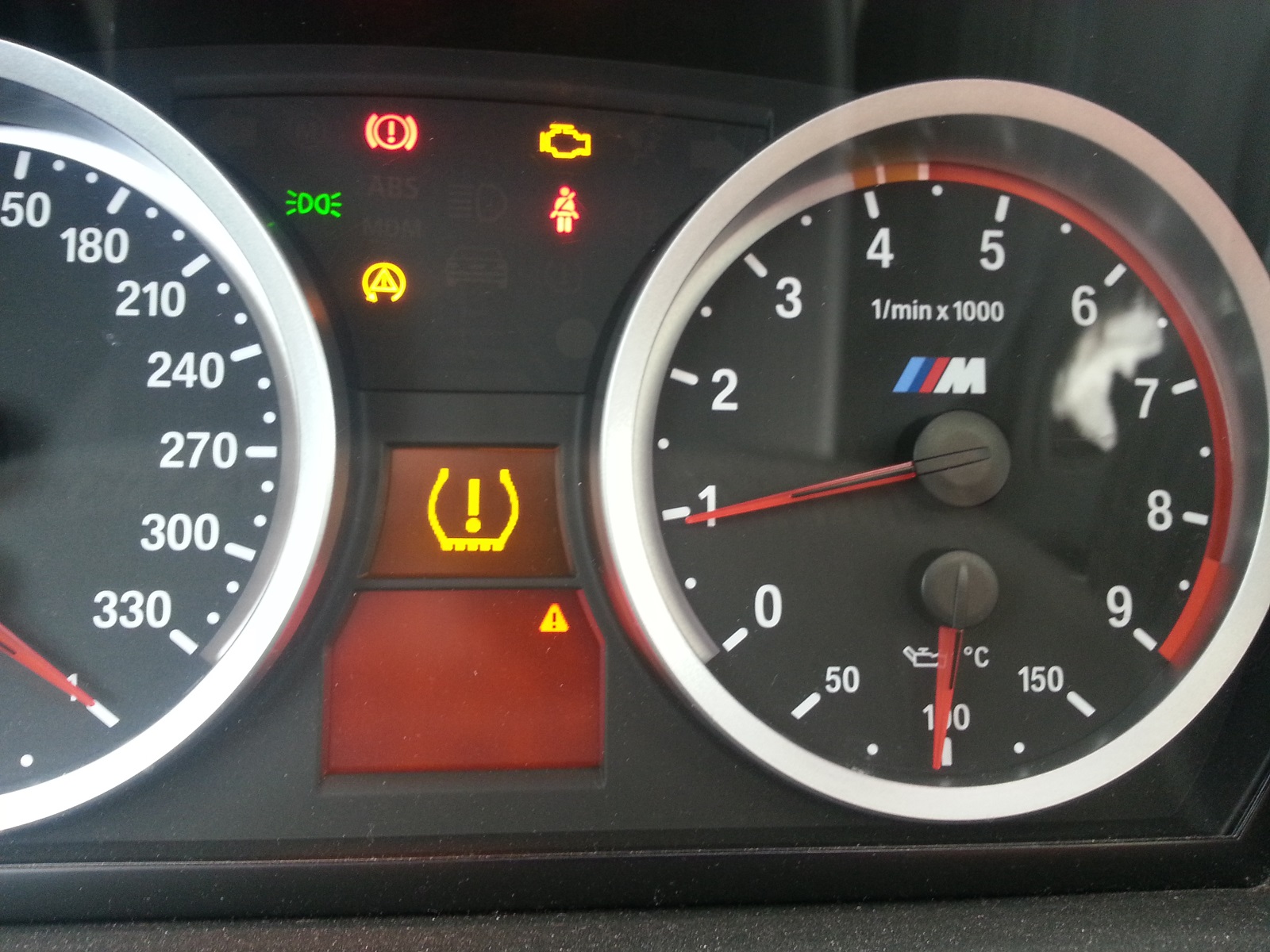

I have this problem just when I start my M3, sometime I dont have this limp mode. This is an intermittent problem, but I am very tired. I take this 5 pictures from my cluster. I need some help. Could you tell me when you have problems with the throttle, do you have the same alarme on the cluster. Excuse my english, I'm french canadian.
So I have 5 check engine in my cluster when the limp mode come and my rpm cutt off a 3500. check the picture below.

breakey12345 wroteI had those exact same codes and the limp mode activate yesterday 5 minutes into my drive. I pulled over, shut down the ignition and restarted the car. The error messages were gone and the car ran fine. Should I be worried about the stupid throttle actuator grenading itself? So much for "German engineering". I should've gone with a GTR insteadmy others pictures from my cluster

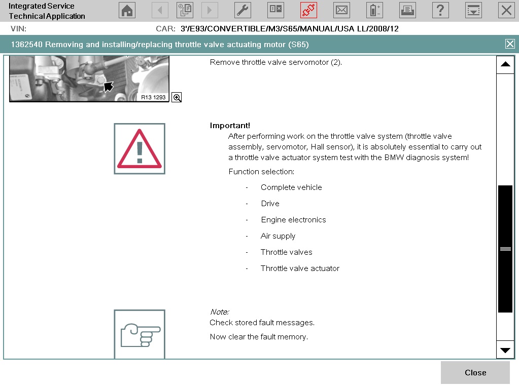

How you resseting the throttle actuators. I dont read anything for reset the throttle.
What is the procedure. I try to reset the code but now is steal there.

Majin Buu wroteGrenading itself? If it goes bad, change it and get on with it. It's not the end of the world.I had those exact same codes and the limp mode activate yesterday 5 minutes into my drive. I pulled over, shut down the ignition and restarted the car. The error messages were gone and the car ran fine. Should I be worried about the stupid throttle actuator grenading itself? So much for "German engineering". I should've gone with a GTR instead
breakey12345 wroteI don't think resetting it is necessary because none of us that did the job had to do it. However, I would use Bavarian Technic to clear all the codes. This is something your mechanic should be able to do if he has the tools for it.How you resseting the throttle actuators. I dont read anything for reset the throttle.

W/// wroteAgreed. A bad throttle actuator will definitely trigger a CEL and limp mode.Are you sure? I'd think the CEL would be the the sign of doom, rather than DSC/ABS. That sounds more like speed or brake sensor? I could be wrong of course
malter2.0 wroteAs far as I know, it's identical. I don't think there has been any redesign or reengineering of that part. Still the same piece of crap part since 2007.The part that replaces this is identical or re-design part number?
RBB wroteYep...just had bank 1 replaced last month at 56K.Agreed. A bad throttle actuator will definitely trigger a CEL and limp mode.
Hey I replaced the actuator today and the problem has gotten worse! Now the car barely starts, stalls on its own, and has a very rough idle. And doesn't rev past 2000 rpm. I never cleared the error codes from the original actuator. Do I just have to clear the codes or is it possible the replacement part is also malfunctioning? So fucking fed up with this shit.

Majin Buu wroteNo clearing of codes required. Do you know the exact error codes led you to the correct actuator?Hey I replaced the actuator today and the problem has gotten worse! Now the car barely starts, stalls on its own, and has a very rough idle. And doesn't rev past 2000 rpm. I never cleared the error codes from the original actuator. Do I just have to clear the codes or is it possible the replacement part is also malfunctioning? So fucking fed up with this shit.
Edit: Re-read posts...The DME conducts a "pre-drive" test when the ignition is turned on before the engine is started. It cycles the actuators fully open and shut and detects any errors in position. So, the error code may be stored, but will not actuate limp mode if the test passes.
jcolley wroteMy code was 2B15 which apparently means throttle actuator governor bank 1. I replaced the actuator for the passenger side, which i assume is bank 1 per this DIY. And after I did it the problem is now worse. The actuator I got was used but supposed to be working properly per the seller. It came from a recycled 2010 M3.No clearing of codes required. Do you know the exact error codes led you to the correct actuator?
Majin Buu wroteSo, I half mis-spoke. ISTA does tell you to perform a throttle actuator test. This may be required to let the DME "learn" the new actuators settings. You can also perform this with DIS. If you don't have a copy, bmtechnic.co.uk sells a nice, easy to use version with a cable for cheap. Invaluable owning this car.My code was 2B15 which apparently means throttle actuator governor bank 1. I replaced the actuator for the passenger side, which i assume is bank 1 per this DIY. And after I did it the problem is now worse. The actuator I got was used but supposed to be working properly per the seller. It came from a recycled 2010 M3.
