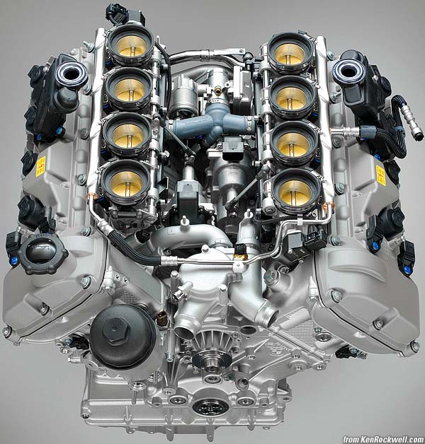

Saw this picture in another thread that I forgot to upload on here. You can see the 2 actuators clearly.
Is there any way to know if these actuators are starting to go bad? What do these actuators really do (sorry I am pretty noob to how internals of an engine work)? I have near 60k miles on my car and my car idles like I need a minor valve adjustment. I probably should have checked these out prior to installing the supercharger.
If you are only having issues at idle, your throttle actuators may be fine. I'm not positive about the S65, but for the S85 there are separate idle actuator from the throttle actuators. When opening throttle, the idle actuator opens fully first, before the throttle actuator is opened.

It is interesting to note that in the picture above, the S65 actuator arms are *almost* vertical with the throttle bodies closed. On the S85, they are *exactly* vertical at idle.
