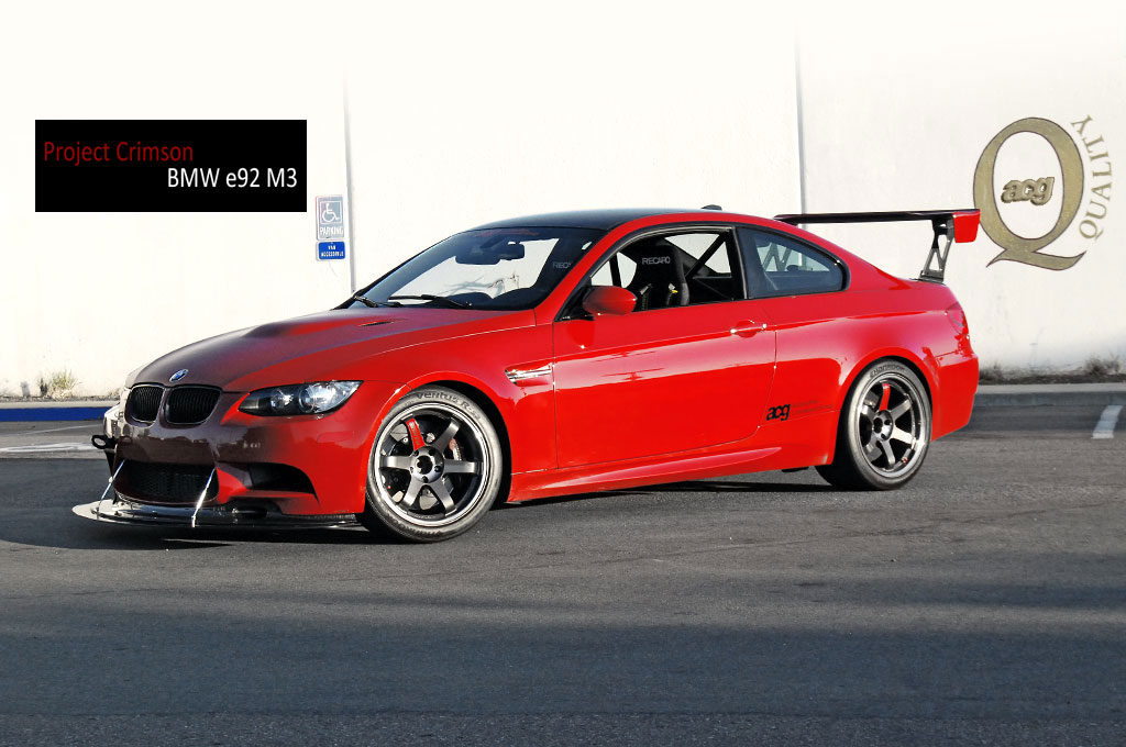

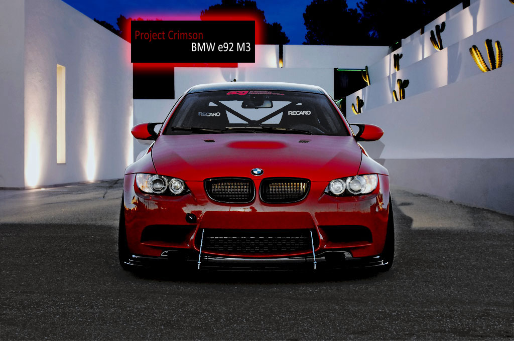

ar: 11 E92
Wheels w/ Offsets: Volks TE37SL - (F) (R) 18x10.5 et20
Spacers: None
Tires / Miles: Hankook RS3 - (F) (R) 285/35/18; New Tires
Suspension: Moton CS with camber plates
EDC Setting: none
Alignment: (F) -2 (R) -1.6 camber 1/16" toe
Fender Modifications: (F) None (R) None
Rubbing?: none.

Wow this is impressive fitment in the front, 18x10.5 ET20 with 285/35/18, and the front camber isn't even that extreme.
What do you guys think about a 18x10 ET25 front with 285/35/18 and -1.7 camber? If he fits shouldn't that setup fit as well?

I'm not sure if you have enough clearance for the inner. I do have aftermarket suspension so it helps a little.
For camber, it's hard to say. You need to feel the suspension and steering feedback to adjust your camber setting though.
It depends on what tires you wanna run. I would recommend 285/30/18 for fronts and keep it close to stock over diameters.
