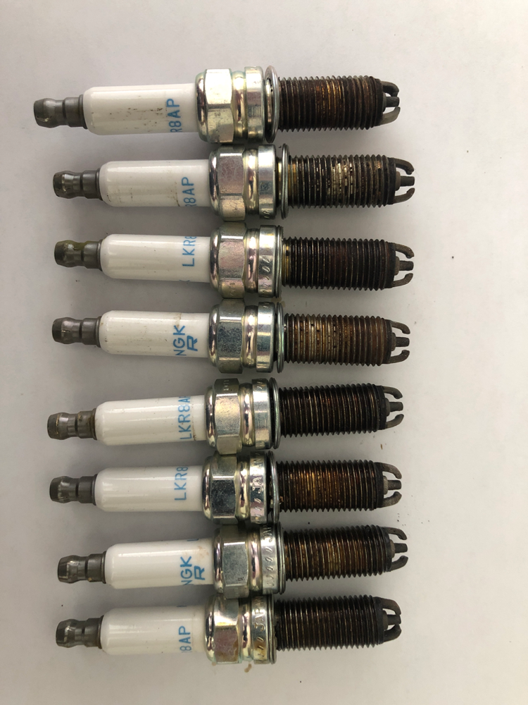

Special tool worked great for me. Did this job Sunday and the car is way smoother now, particularly when coming to a stop, idle is solid.
It was a fairly easy job. 4/10 with the special tools. Electrode tips seem to wear away resulting in a larger spark gap over time. Likely the issue these have.

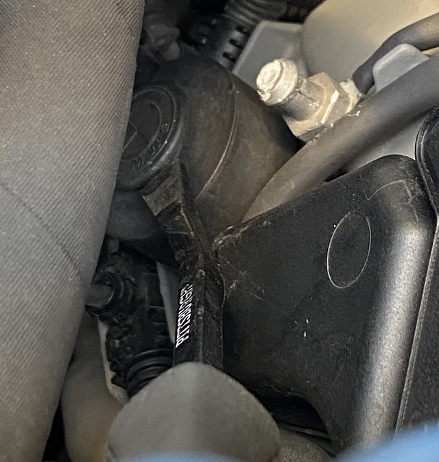

I did my spark plugs today and was able to get a couple easy ones off by coat hanger and a couple by hand. The passenger rear was actually one of the easiest ones to pop up for me. I used a small pry bar with leverage like this and it easily popped right out. The whole job took me about 2 hours so It can definitely be done in a half a day.
The pry bar I used is the smallest one in this set:https://www.harborfreight.com/4-piece-heavy-duty-pry-bar-set-1654.html

You got lucky, that is a good way to snap off the top of the coil pack and also snap the plastic oil separator/pressure regulator on the top of the valve cover you are prying against.

Luck may have been on my side and it may have been looser than the other ones. I was very careful not to put excessive force on any of the components

For that rear one what tends to work best is some speaker wire or cat5 cable wrapped around the coil pack top then pinched so it doesn’t slip. Run the wire up over the top strut tower brace bar and pull using the bar as a leverage point. It works great because the pull is to same angle matching the insertion angle of the coil pack. If you try and pull straight up you’re pulling at the wrong angle.
Your pry bar does have the right angle to the pack, but I would really recommend against prying on the plastic in both places. Maybe get a block of wood across the valve cover and pry off that wood. You still run the risk of snapping the top off the coil pack. It happens way more than you would think and right now you can’t sell your supermodel gf for a new coil pack. Well you can it is just 2-3 times as much as they used to be plus a non damaged core, which you wouldn’t have.

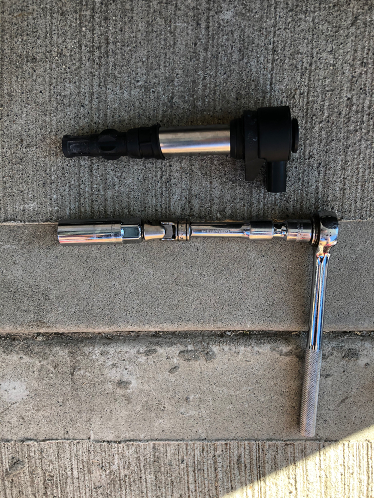

I managed to do all my spark plugs without using a coat hanger or special tool.
The trick is to disconnect it then rotate it back and forth to loosen it.
Then find a solid (non plastic) and safe prying spot for each. Do not pry from the slot on the coil where special tool is inserted. From the very bottom, it's rubber sleeve. Work it slowly from multiple angles where possible. Be patient.
I did not want to use a coat hanger or tool because I think with age they get brittle and that spot designed to pull or any plastic area on it is prone to breaking. Based on experiences in this thread.
But I suspect if you were to twist and work the coil loose and then use the tool you'd be safer. Just pulling on it while it's seized in there is asking for trouble.
