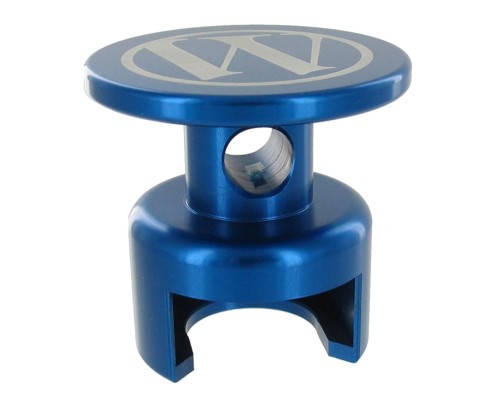

Any chance of a part# or link to the coil pack removal tool?

And here is the coil puller tool
Image hosted on: i264.photobucket.com
Yup that's the puller alright. Worked like a charm. No need to remove the plenum. The coils are on the sides

Where do you get one?
if you can get at the rear 4 plugs (clearance), and with this specialty tool, you probably could get away with not removing the plenum. Anybody know how much this removal tool costs?

I was a BMW tech and it was the special tool that I used to change the spark plug on a customers M3. Not sure if the dealer would sell it directly but I don't see why not. Probably wont be cheap. Its an amazing tool for the job.

Those are your friends:thumsup: Buy as many as you can

Good to hear :thumbsup:. May I ask what tool(s) did you use to lever the coils up? Thanks.
flat head screw driver and rubber lined pliers with firm but not too much pressure. i found that just rotating the coils a little back and forth makes it easier to pull them off.

I've been looking into changing out my spark plugs too and I would love to find this tool. I did alot of googling and I can't find anything with a part number 11 9 980. Does anyone have a complete BMW part number or maybe a source of where to order this tool?
As a possible alternative I found these two tools for BMW motorcycles for removing their coil packs and the procedure looks similar. Just sort of a shot in the dark if either of these tools would fit.
The xxxx237 tool might fit our coil packs (the other is too small), but I don't see how we could remove at least the rear plugs with that; not enough space with the strut wall. BUT what we could do is cut off the big a$$ handle and we could use a screwdriver thru the hole to pull them out instead :D. And that would definitely work even on the rear plugs. How can we find out if that tool works on our coils??? You got my curiosity going. I rather avoid marring the coils with a screwdriver and pliers if possible.
And as far as the tool part number, it might be correct, but only authorized dealers can order them? We need to ask Tischer. We should be able to order them, but I don't think it'll be cheap man. And for using it once, it hardly makes sense. I like your other alternative better :thumbsup:. Let's find out if it fits. How much is that, by the way? And where to buy? Thx.
I'll send a pm to one of the guys at Tischer to see if the official BMW tool is even avaliable.
Regarding the alternative, cost is about $30.
http://www.wunderlichamerica.com/motorcycle/8160237.html
I guess we could confirm it if there was a BMW tech on the forums that has the tool and can take a better pic the official BMW tool.
