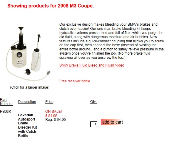

Any feedback between these two units?
You only want to use a reverse bleeder when you screw up and let air into the system, AND can't purged it out with regular bleeding. This rarely happens on vacuum-assisted brake systems, like on most cars.
Only vehicles that might need it are those with servo-assisted brakes (4 independent systems), depending where you suck air. The circuits to the calipers can be bled normally even if you open the wrong line (like I did once - oops), But if you let the reservoirs gulp air, which feed pressure to a special diaphragm that pressurizes the caliper circuits, reverse bleeding is the only way to get them to work again. Many BMW bikes and some MB cars of a few years back have them. My K1200 bike had 11 valves to bleed, so you get the idea how complex the system is. I really liked them since with the brake lever you activated all brakes, but with the pedal just the rear. And all you needed was a finger for a 'panic' stop. They still had great feel IMO, but many purists argued they lacked feedback. Or they were spooked that you needed much heavier pressure without the ignition on. I never had any problems, but just like many things with our M3s, it was an unnecessary complication.
Anyway, I have a bleeder from Griots, but it's the larger one. The little one you linked is enough for the job, however.
And yes, you can reset any maintenance item yourself; do a search on instructions.
So with the Griot's bleeder, you suck out the fluid from the reseviour to the filter and then refill with fresh stuff? Then bleed from the calipers? Or does someone have to pour in fresh fluid as you're bleeding?
Then with the Motiv, you just pour the brake fluid into the Motiv unit, uncap the brake reseviour and screw it on. Then pressurize and bleed at each caliper into the water bottle? Thanks.

1. My brake fluid maintenance is due (I believe is every 2 yrs) and the dealer is charging me $200.00, so I decided to buy the bleeder kit from Bavarian Auto. I read that if I flush the system I need to replace all 4 brake pads? My car is showing like 18K left for Front and 28K for Rear...I don't track my car. Do I have to replace my brake pads also??
