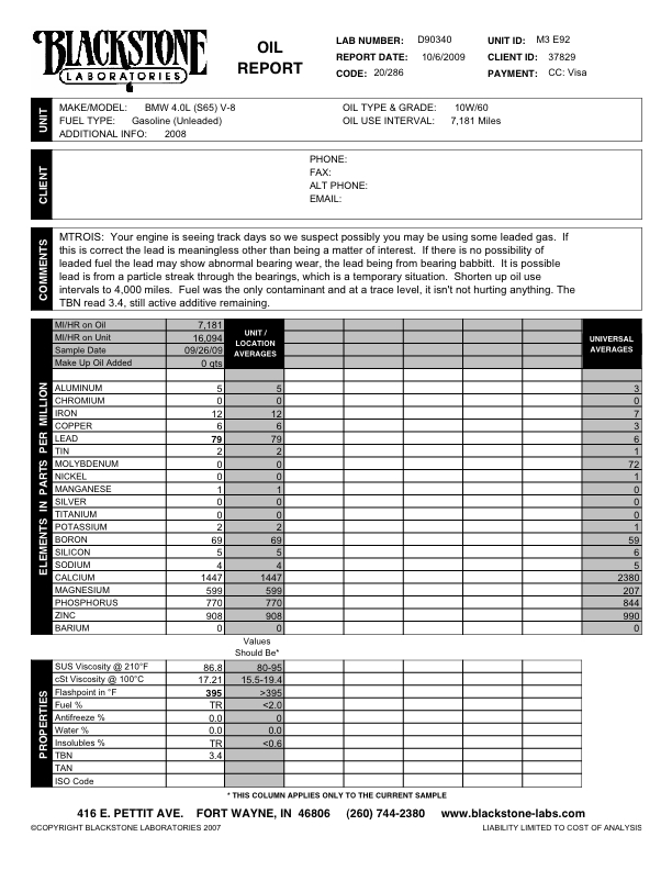

Following the example of JonM, I decided to have Blackstone Labs analyze the oil when I recently had it changed.
Just to clarify the report:
* the engine had 16,094 miles and the oil had only been used for 7,181 miles (I double the frequency of oil change).
* type of use: I would say rather mild/medium 85% of time, one track day (4 X 20'), engine always warm when spirited driving
* As you will see, overall everything looks ok, with the exception of the lead value. I remember having taken gas after my track day at Lime Rock Park but that was only 2.240 gallons of 112 and I did not use it during the track session, only on my way home. I still believe that this is the root cause for the above average lead value but I need to double check that that gasoline was indeed leaded.

A few thoughts on your oil sample results:
First off, if you did indeed use 112 octane race gas...it was definitely LEADED.
Better cross your fingers that it was the leaded fuel that caused the spike in your LEAD levels. Otherwise, you may have a bearing problem. It's too early to tell, but I'd get another oil sample out to Blackstone after 3,000 miles just to be safe.
If it does turn out to be an internal bearing issue, these oil analysis reports can be very helpful. This independent third-party oil report can be used to help convince BMW NA, in case any engine repairs or replacement is necessary in the future. ;)
By the way, the other trace metal levels look good, and the total base number of 3.4 is still pretty good. (fresh 10w-60 TWS has a TBN of 8.1)
Question:
How much time lapsed between using the leaded fuel, and taking a sample of the oil for analysis?

Thanks LeMans for your comments! I took 2.240 gallons on May 15th and had the oil changed on September 26th.

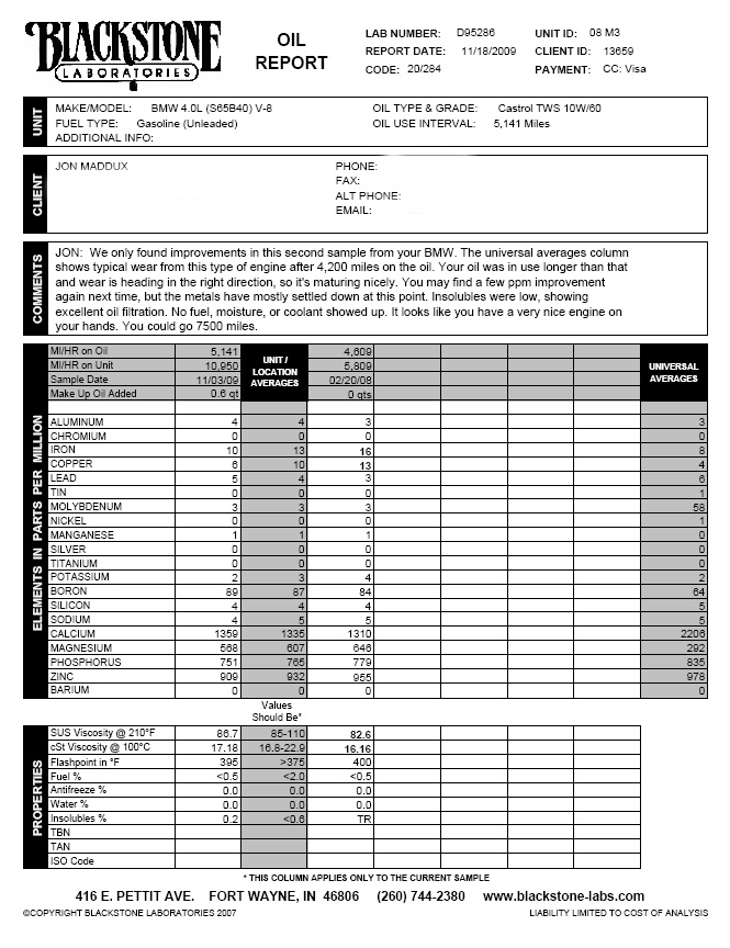

First sample from 808 MGuy @ ~ 8k

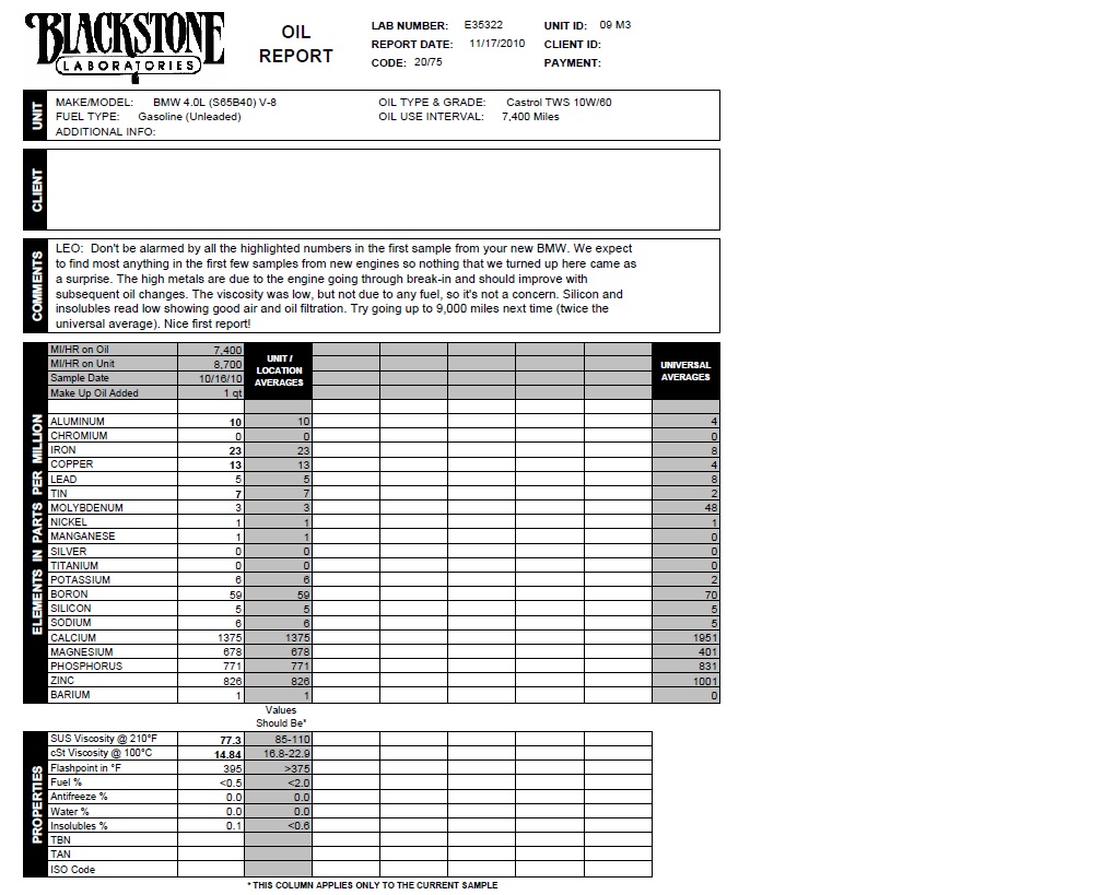

Here is my first report. I had about 7200 miles on this oil. Seems like many of us have high iron and copper readings. Probably will taper down after the full breakin. My lead readings are very low though compared to some of the reports in this thread. Not sure why.

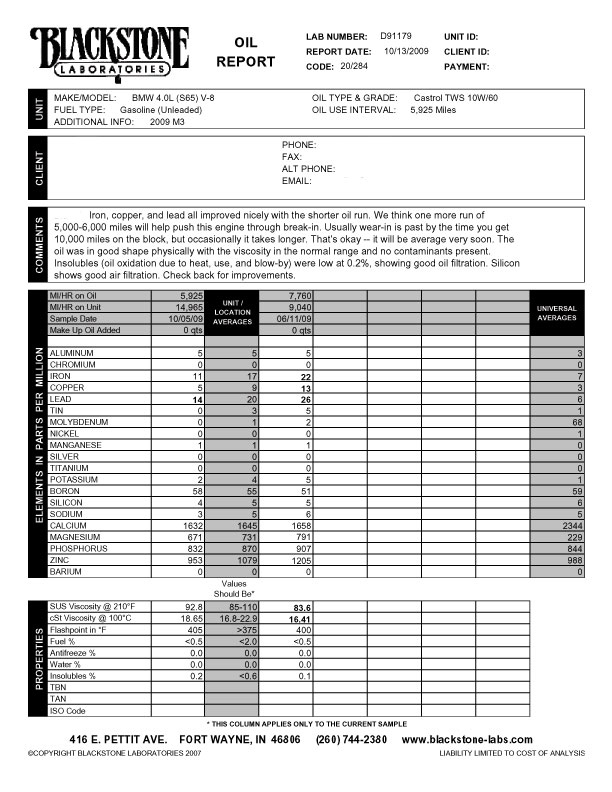

Here is my second report.

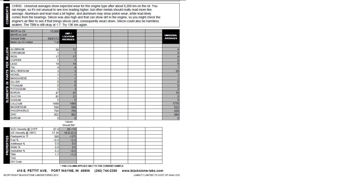

Here`s the first one i`ve sent to to Blackstone for my 08. Picked up the car at 52000 kms and changed the oil at 60000 kms. Based on service records the car had the last oil change at 47000 kms in October.
I'm wondering if the high wear and metal content from the weak of REALLY cold starts this past January (around -22 ºC and a couple around -33ºC) maybe its time to think to switch to a lighter weight oil for winter? Any thoughts from anybody?
