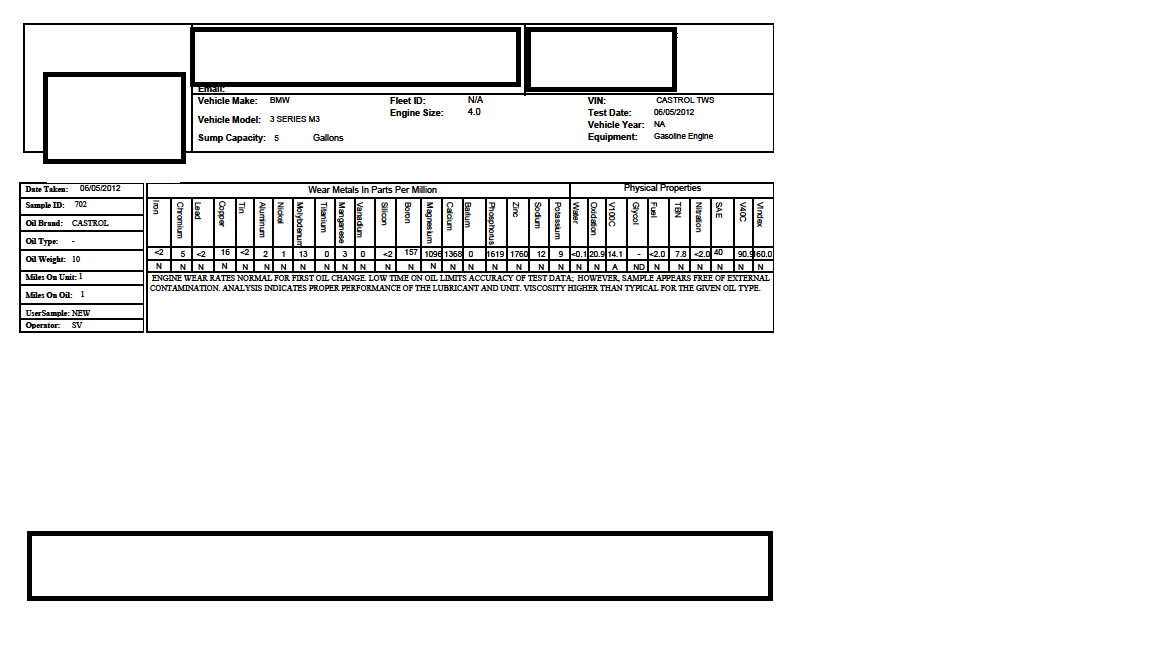

Here is my latest report at 37,000 miles
Singletrack wroteThat is the opposite. The tighter the clearance the less wear there will be. I have ran a test report on fresh 10w-60, here is the report in case anyone was wondering.Although again, there has been some hearsay that the 08 bearings are even tighter than the 09s, and therefore could wear worse. You also don't know how the previous owner treated the engine.
We have a oil machine at work so it is convenient. I had to block out certain things, sorry.
kawasaki00 wroteEhhhh. Obviously there is a happy medium. Too tight or too loose is going to be a problem. At least one experienced mechanic on this board has given his opinion that the clearance is too tight.That is the opposite. The tighter the clearance the less wear there will be. I have ran a test report on fresh 10w-60, here is the report in case anyone was wondering.
Thanks for the report.
