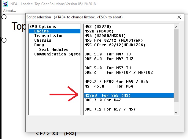

Then utilize INPA and find the report out.

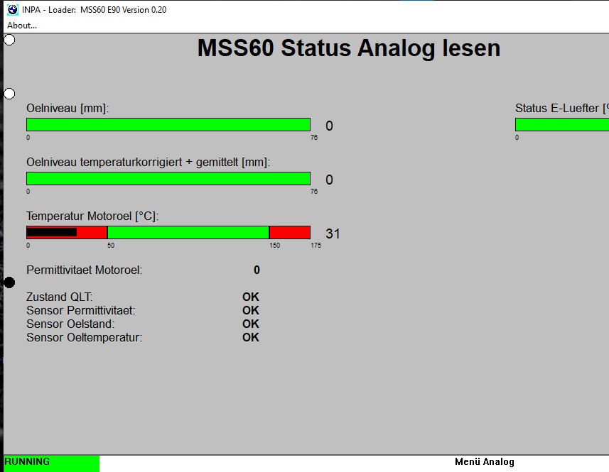

Next find the "analog" section of INPA and you'll see a section where "Oelniveau [mm]" as an option. This is what the actual sensor is reporting a distance up in mm of the sensor.
In this example, I completely drained the oil in my car to verify this. Thus, 0 [mm] was reported.
NOTICE: the permittivity was reported also as 0 -- this would indicate there is NO OIL in the sump; not safe to start the car. The KOMBI would also report this as "NOT OK" when trying to evaluate the oil before starting the car.

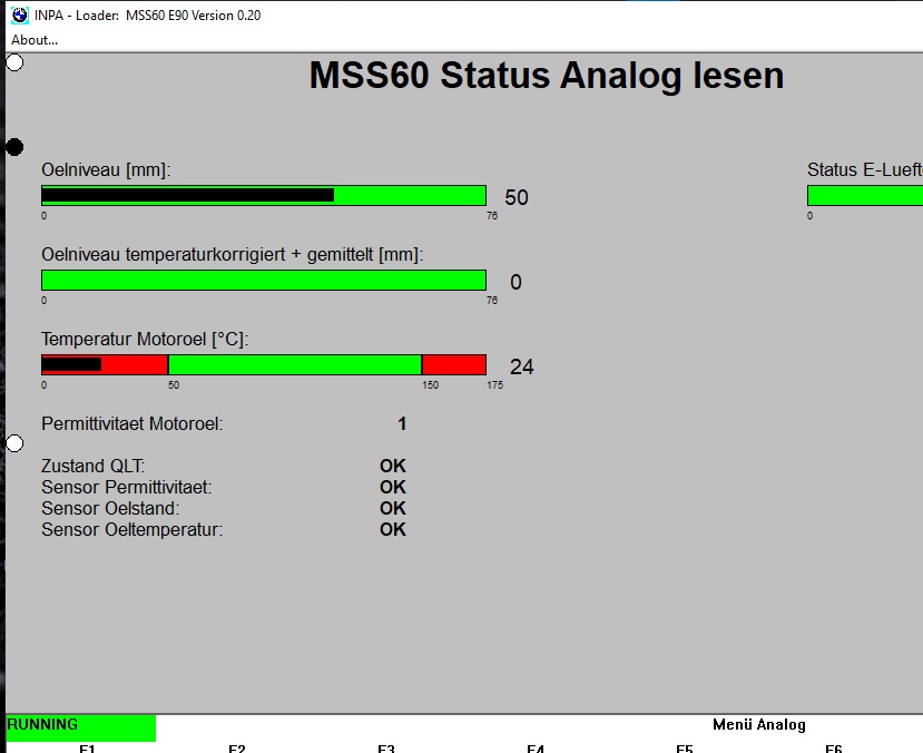

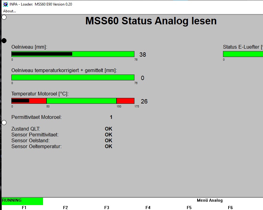

Now verifying this response when filling up the sump with oil, I can see the sensor report increasing values when adding in the last 4 quarts of oil.
KEEP IN MIND, there is a sort of hysteresis on the oil level sensor as you're adding oil. It takes time for the oil to drain down into the sump from the valve cover, thru the head, into the first sump, then overflow into the main sump. Thus, give the oil time and the sensor rebound time.

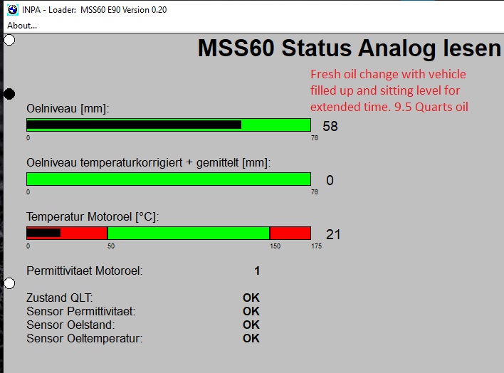

Here is the reading after letting the vehicle sit a long time so that all the oil would drain into the sump after only 9 quarts of oil.
50 mm would be somewhere around the "minimum" reading for a "full" mark--but keep in my the oil temperature is relatively low. The volume increases as temperature increases.

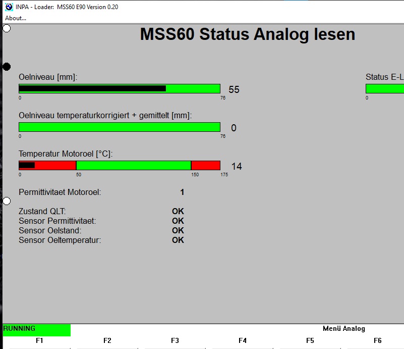

This shows the oil level of 58 mm with 9.5 quarts of oil in a non-started engine.
Now finally after running the engine and going for a drive here is a static reading after letting the engine sit overnight with 9.5 quarts of oil.
Here we see 55 mm of oil level. This is what I would consider the "FULL" mark on a fresh oil change checking it statically. I consider this to be the goal of a full oil level.

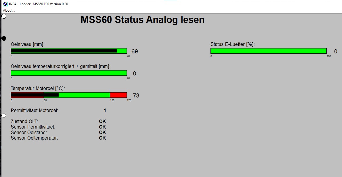

Lastly, here is a full, HOT level reading after shutdown for around 10-15 minutes. The oil level was still evaluated as "FULL" on the iDrive not being overfilled.
