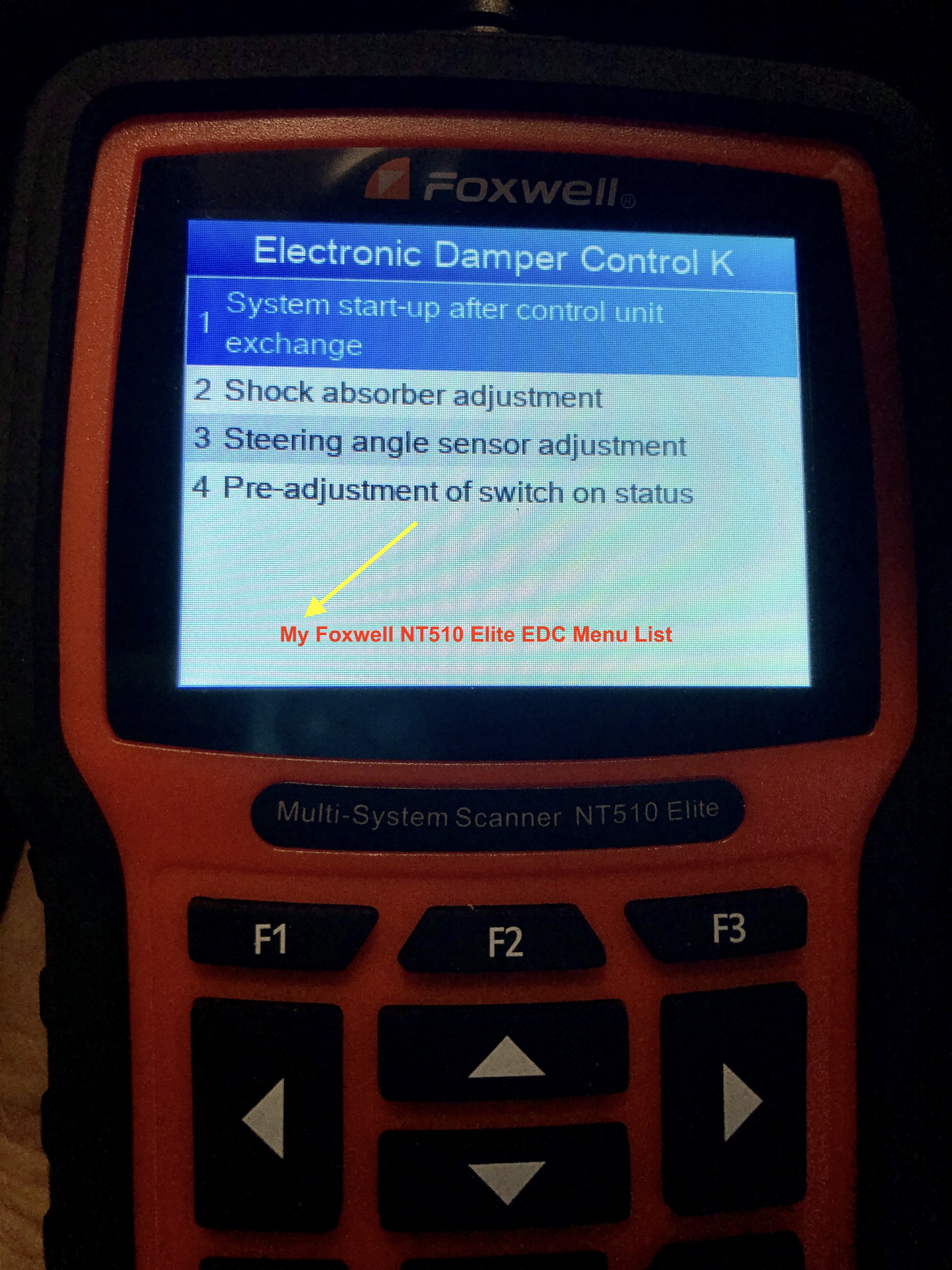

Thanks for this information. I bought a Foxwell NT510 Elite scanner tool and successfully reset the EDC front and rear axle shocks using the "Shock absorber adjustment" menu choice (3rd image below). However, my NT510 Elite doesn't list the "Shock-absorber Performance" menu item - as shown on your own scanner photo below from 2022 (2nd image below)? Do you have any idea what the "Shock-absorber performance" menu function actually does? Thanks in advance.
chutak's user avatarchutak and derbo's user avatarderbo, just in case Tommysalami's user avatarTommysalami is no longer around (after selling his M3) could either of you also help answer my question above? I don't see the "Shock-absorber Performance" menu option on derbo's user avatarderbo's image from ISTA either... (1st image below)..
Image hosted on: i.imgur.com
Post referenced by DrFerry in Solving EDC deterioration? 12-10-2025
chutak's user avatarchutak and derbo's user avatarderbo, just in case is no longer around (after selling his M3) could either of you also help answer my question above? I don't see the "Shock-absorber Performance" menu option on derbo's user avatarderbo's image from ISTA either... (1st image below)..

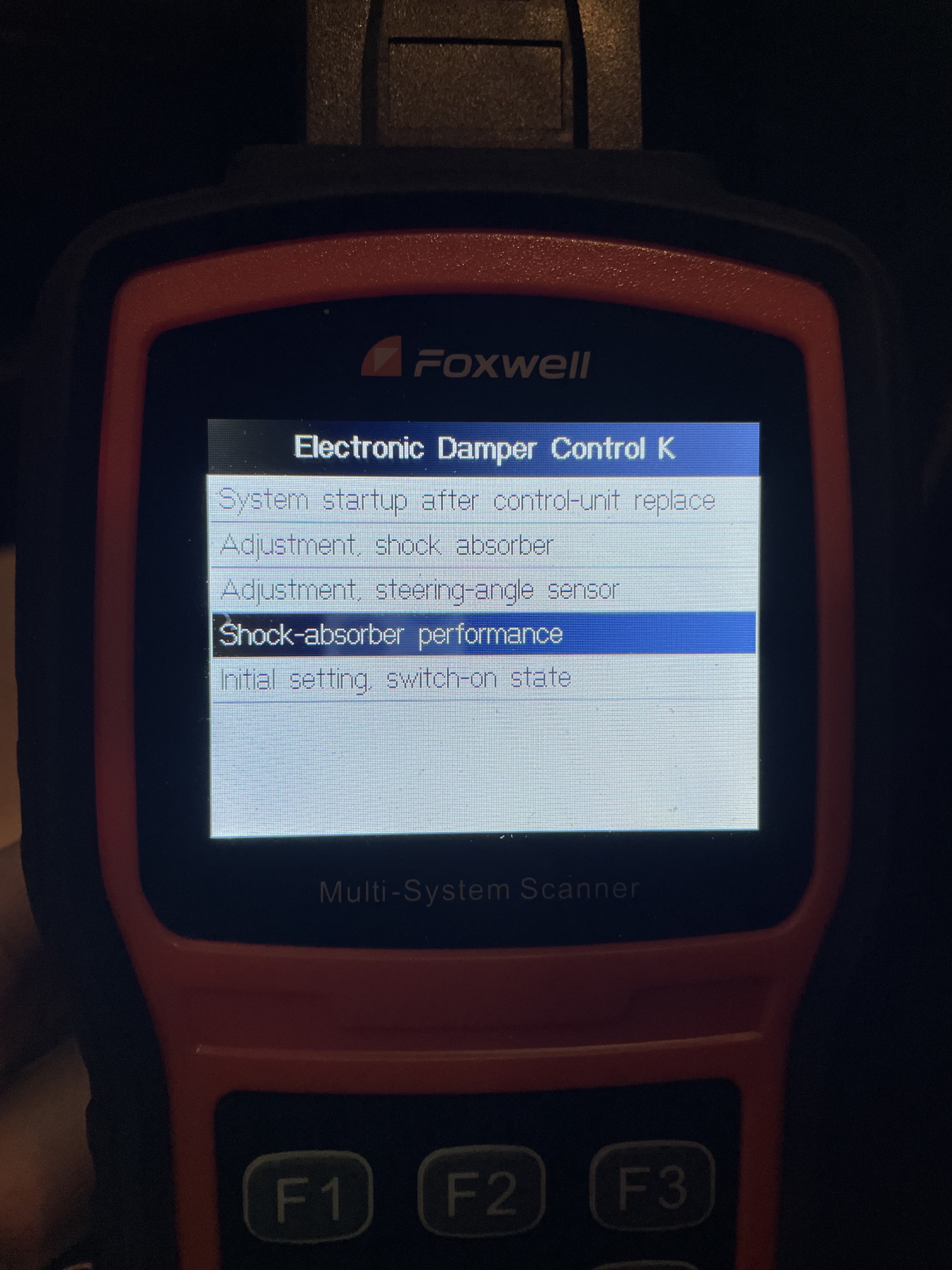

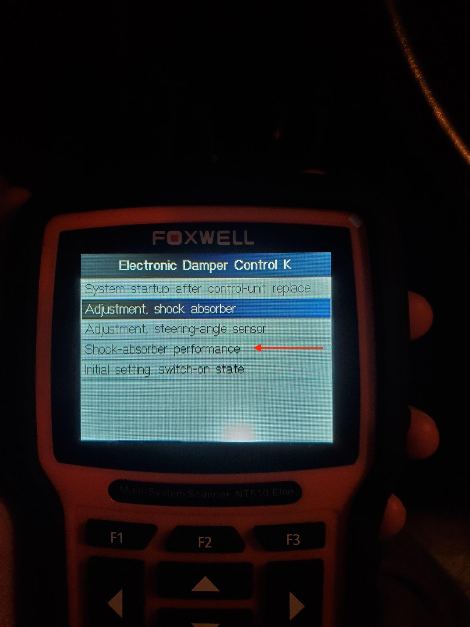

Hey, sorry for the late response. I was able to take a look at this. “Shock absorber performance” seems to be an option on my NT530 but not your NT510.

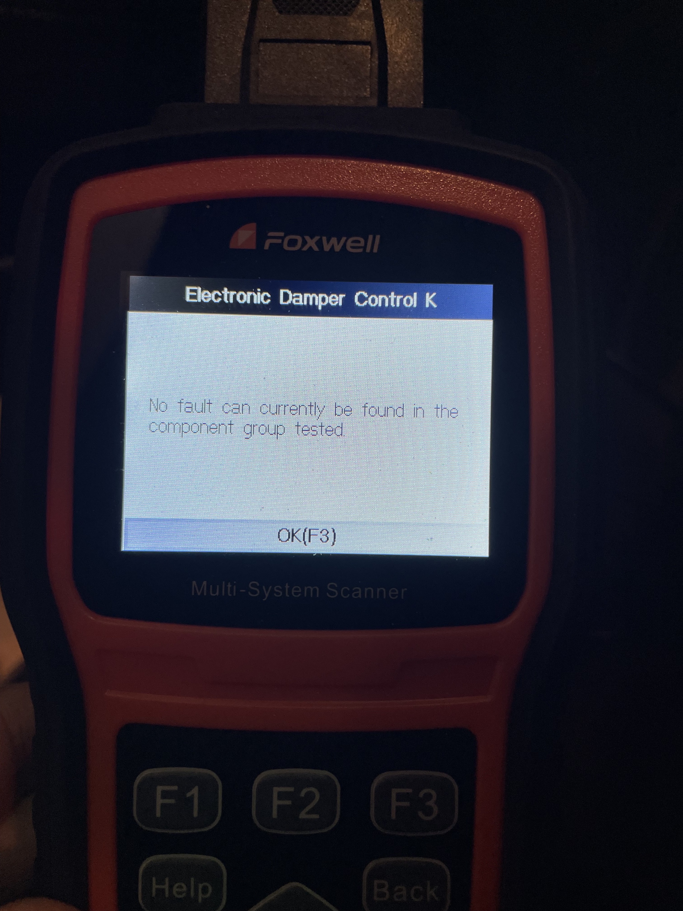

So I clicked on that option and but it didn’t really tell me much. See the screenshots posted:
Edit: pics won’t post for some reason. After clicking on the Shock Absorber Performance option it read:
“No fault can currently be found on the component group tested.”
Note that I’m in the Service function and not Diagnosis.
