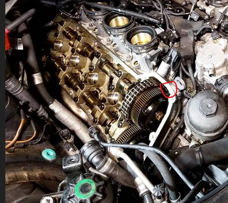

One thing I didn't see called out here, is there is supposed to be some sealant applied where the cam cover meets the cylinder head, on both sides.

drwankel wroteYep, the Drei Bond, mentioned in OPs BOM.One thing I didn't see called out here, is there is supposed to be some sealant applied where the cam cover meets the cylinder head, on both sides.

drwankel wroteIf you replace that gasket it is already applied from factory. If not Drei Bond will also workOne thing I didn't see called out here, is there is supposed to be some sealant applied where the cam cover meets the cylinder head, on both sides.
Vedubin01 wroteBelieve it is on the metal gasket for the timing cover, but does the valve gasket have sealing on? (preparing for the job)If you replace that gasket it is already applied from factory. If not Drei Bond will also work

Helmsman wroteYou are correct nothing on the gasket. I only used Drei Bond in the valve cover rails to fill in any pitting from removing the factory coatingVedubin01 wroteBelieve it is on the metal gasket for the timing cover, but does the valve gasket have sealing on? (preparing for the job)If you replace that gasket it is already applied from factory. If not Drei Bond will also work

Vedubin01 wroteSeems OEM usage is in the corners towards the timing cover only. Any feeling for whether more extensive usage of Drei bond around the rail (in order to seal + keep gasket in place) will make it tricky to loose the day its time to lift the valve cover again?You are correct nothing on the gasket. I only used Drei Bond in the valve cover rails to fill in any pitting from removing the factory coating

Helmsman wroteI only applied Drei bond inside the rails like pictured in the DIY. Once the gasket was pressed in, none escaped around the gasket. I don't feel it will create an issue later if I had to remove the covers for what ever reason. The gasket will be pretty easy to remove and just a cleaning/scraping to remove leftover Drei bond in the rail would be simple enough. Being powder coated the covers will last much longer than the stock epoxy coated covers. I guess only time will tell.Vedubin01 wroteSeems OEM usage is in the corners towards the timing cover only. Any feeling for whether more extensive usage of Drei bond around the rail (in order to seal + keep gasket in place) will make it tricky to loose the day its time to lift the valve cover again?You are correct nothing on the gasket. I only used Drei Bond in the valve cover rails to fill in any pitting from removing the factory coating

As for the timing gasket, once squeezed it pushes its sealant up in that area circled above. It mates with the gasket. No need to apply anything if you are changing your timing gasket
Vedubin01 wroteAh, didn't realize the timing gaskets seal was squeezed up, ordered some drei bond but will probably come handy anyway.I only applied Drei bond inside the rails like pictured in the DIY. Once the gasket was pressed in, none escaped around the gasket. I don't feel it will create an issue later if I had to remove the covers for what ever reason. The gasket will be pretty easy to remove and just a cleaning/scraping to remove leftover Drei bond in the rail would be simple enough. Being powder coated the covers will last much longer than the stock epoxy coated covers. I guess only time will tell.
