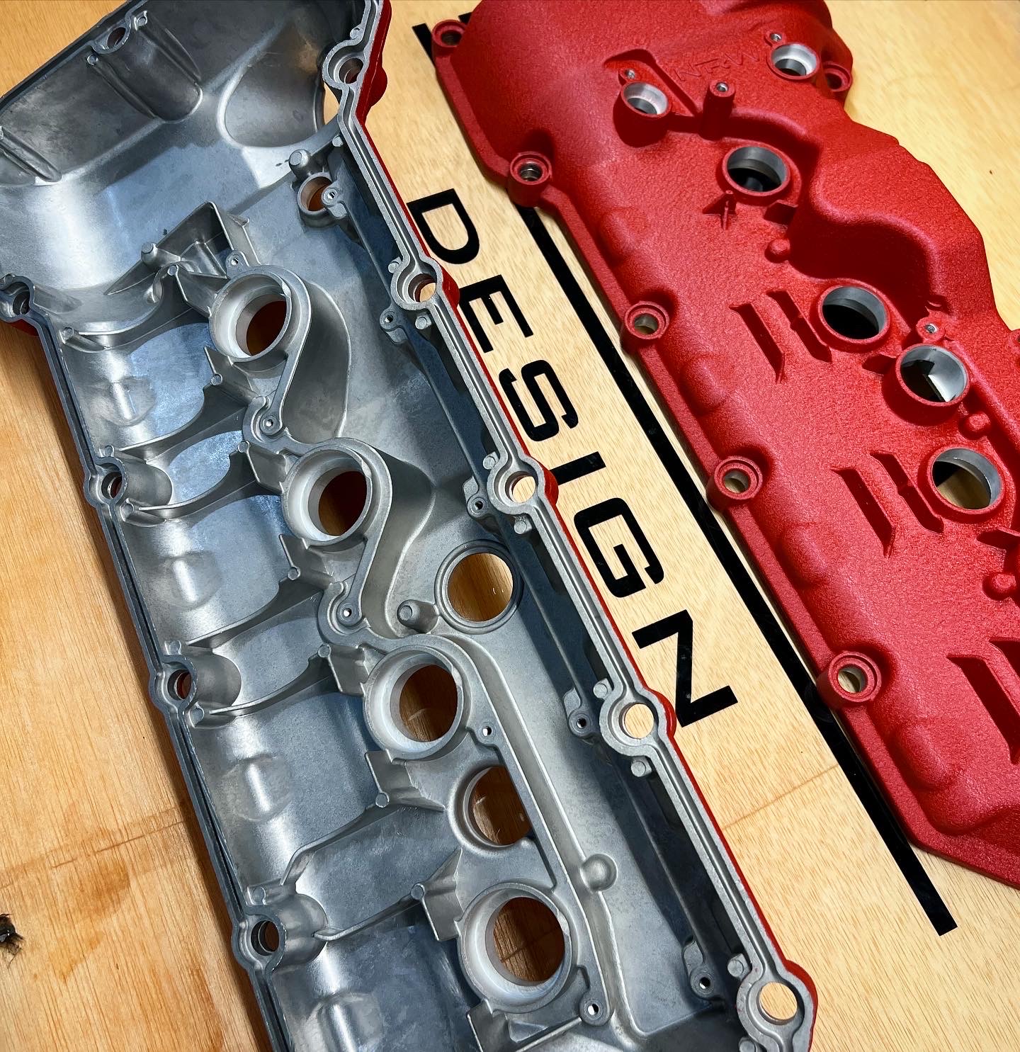

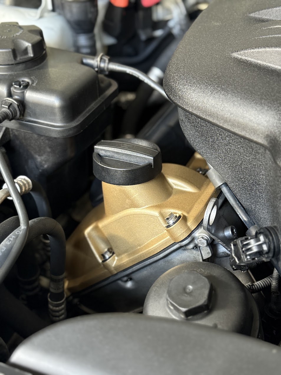

herbertt wroteI’ve kinda upped the game and now making aluminum valve covers that have a lifetime warranty.are you still offering this service? I'm interested if you are.
Feel free to PM me for details

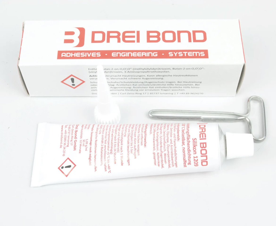

Looks like the Drei Bond (07589062376) has been discontinued and replaced with BMW Loctite 5970 Chemical Sealant - Genuine BMW 83190404517, according to FCP. I am going to use new valves covers and replace the timing cover gasket so I won't be needing any, but just a heads up for those that need it!

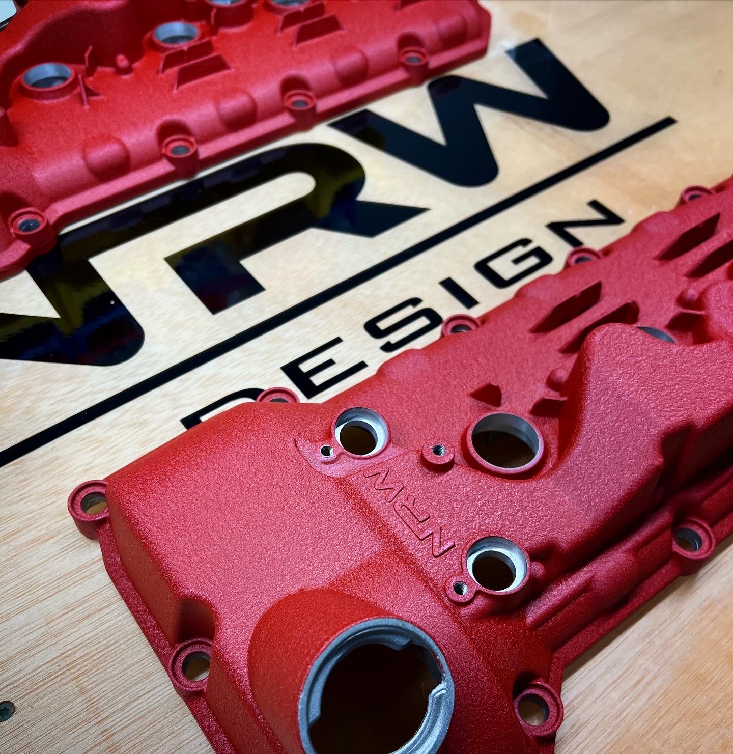

NRW also makes just the rubber grommets for the valve cover bolts. I am thinking about getting them and reusing the bolts. Has anyone done this yet?
agenator wroteYou can still get the Dreibond…just search for Dreibond 1209 and that’s what the BMW one is without the BMW part number.Looks like the Drei Bond (07589062376) has been discontinued and replaced with BMW Loctite 5970 Chemical Sealant - Genuine BMW 83190404517, according to FCP. I am going to use new valves covers and replace the timing cover gasket so I won't be needing any, but just a heads up for those that need it!
agenator wroteI spoke with them about this and am going to try them out. I'm currently doing an engine out service so I'll post pictures after the valve covers with nrw grommets are installed.NRW also makes just the rubber grommets for the valve cover bolts. I am thinking about getting them and reusing the bolts. Has anyone done this yet?
agenator wroteSold over 300 sets so far and not one issue or complaint.NRW also makes just the rubber grommets for the valve cover bolts. I am thinking about getting them and reusing the bolts. Has anyone done this yet?
Vedubin01 wroteAny pics of this set installed? Looks gorgeous!I’ve kinda upped the game and now making aluminum valve covers that have a lifetime warranty.
Savage_M3 wroteI thinkAny pics of this set installed? Looks gorgeous!

boostin1004 wroteWere you able to find out if you can use the new grommets with the old bolts?I spoke with them about this and am going to try them out. I'm currently doing an engine out service so I'll post pictures after the valve covers with nrw grommets are installed.
Quick question, the NRW grommet set has 26 grommets for the valve cover bolts. Are the 2 extra grommets for the collar screws 11127841218 or just 2 extras for the 24 bolts 11127841217?
rated_m3 wroteYesWere you able to find out if you can use the new grommets with the old bolts?
Mr. M3 wroteCollar screws as well.Quick question, the NRW grommet set has 26 grommets for the valve cover bolts. Are the 2 extra grommets for the collar screws 11127841218 or just 2 extras for the 24 bolts 11127841217?
