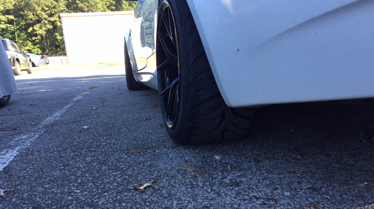

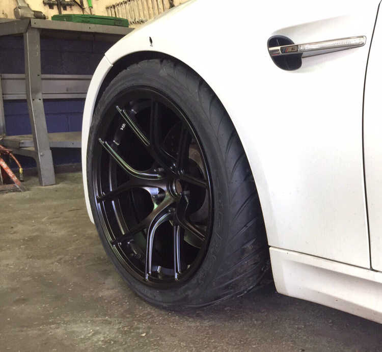

gerikivan wroteThat looks great! 10.5 all around? Any reason you went with those tires?yea i was able to fit with it no problem.. thx again!!
nishfish87 wroteso far no rubbing and yea 10.5 all around..why go with federals or you meant why 275 all around? well federals is cheap and its good enough for me for its price... i wish i went 285 all around but it depends on the brand because some brands has thicker sidewalls..gerikivan wroteThat looks great! 10.5 all around? Any reason you went with those tires?yea i was able to fit with it no problem.. thx again!!
