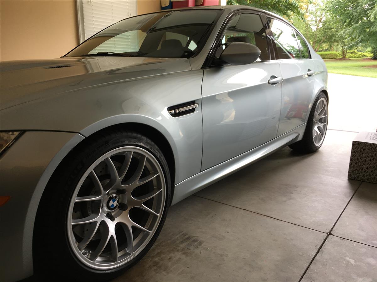

I recently bought another set of street use wheels for the M3 and decided on a staggered set from Apex, EC-7 in 9.5x19 and 10.5x19 sizes in their summer sale; also bought PS4S in same sizes (255/35, 275/35) I was previously running on the 220Ms with PSS'.
For general street driving these feel outstanding. I can tell right away the wider wheels giving a nice taught feel to the tires, especially out back where it's nice and taught in transitions. The wheels/tires feel great, are wider and significantly lighter than the 359Ms, and look good too imo (race silver). The perfect condition 220Ms are boxed and stored for now.
That looks very nice CSBM5!
Thanks! That's exactly what I've decided to do too! I just don't have the money for a bit longer thanks to our good friends in between the throttle bodies
