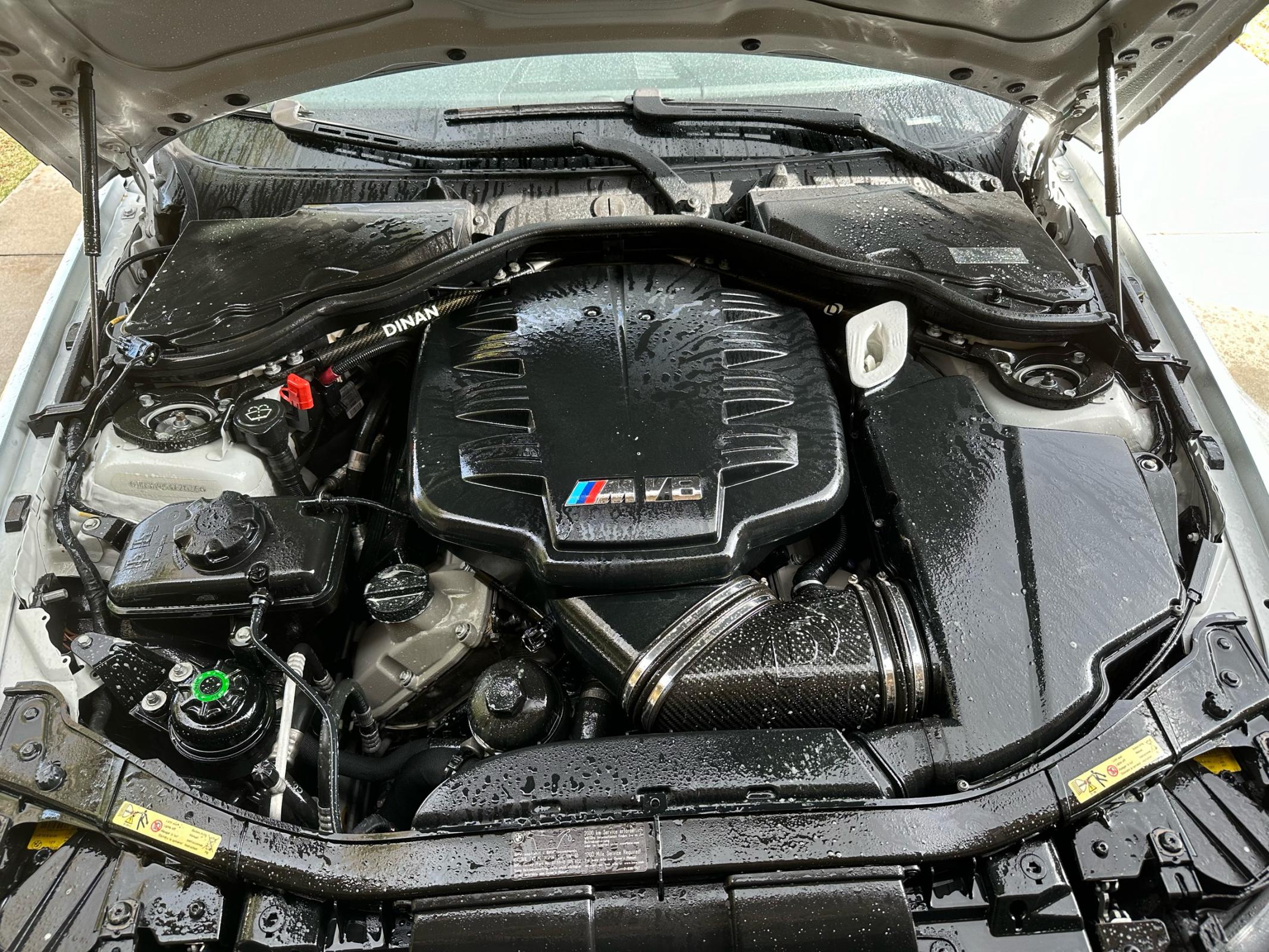

End of the year engine bay wash, brake, and engine oil changes. Feeling blessed to have my daily cars to be able to keep the m3 still at 135k

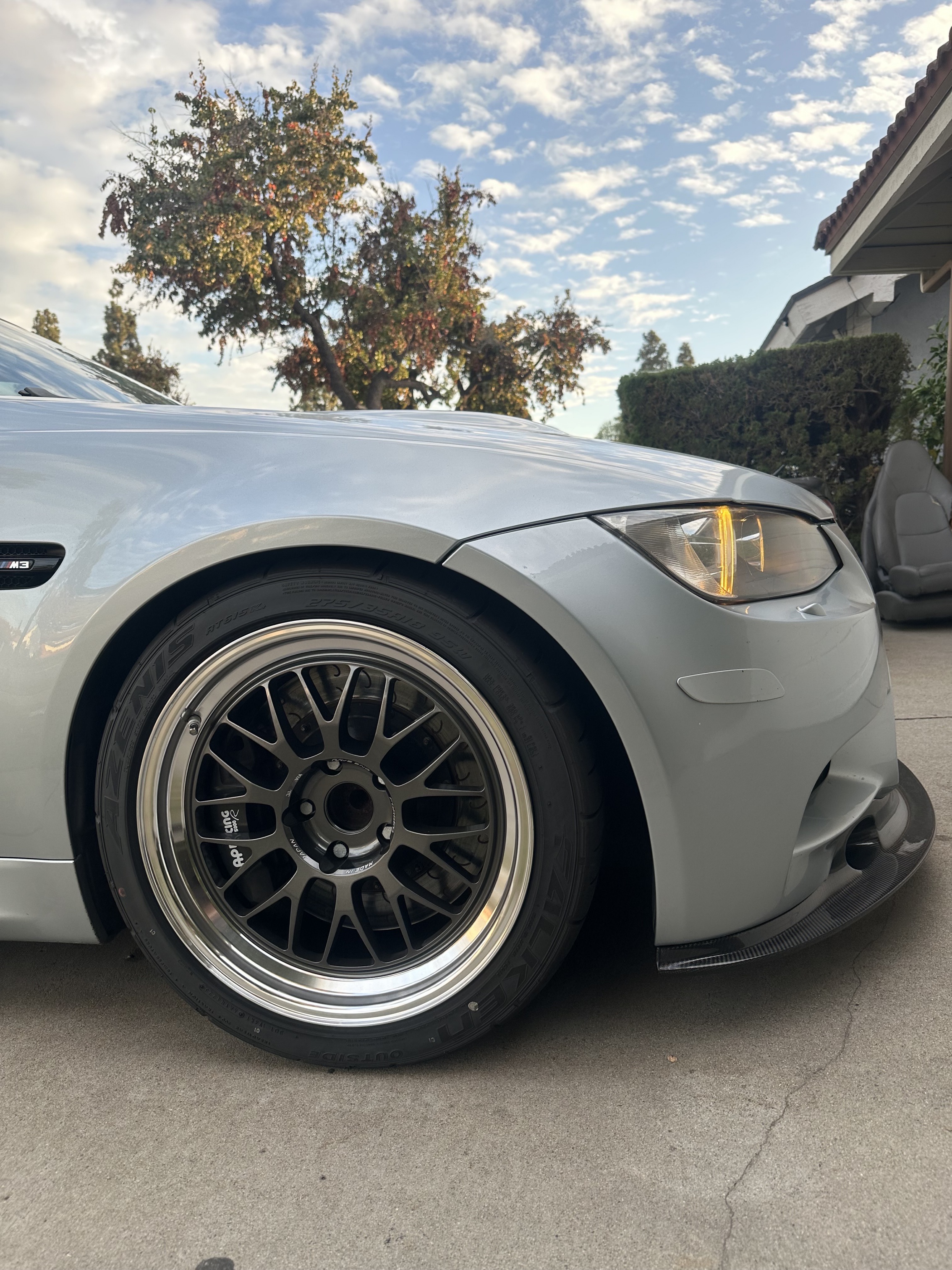

Brand spanking new 275/35 falken 615k+ & 18x10 +25 enkei nt03 for my baby
feels great to be on some light weight wheels and some meaty 200tw again 🥩
At 20 lbs a wheel!!! they unfortunately do not allow much brake clearance though. Could not clear the f chassis m sport brakes.

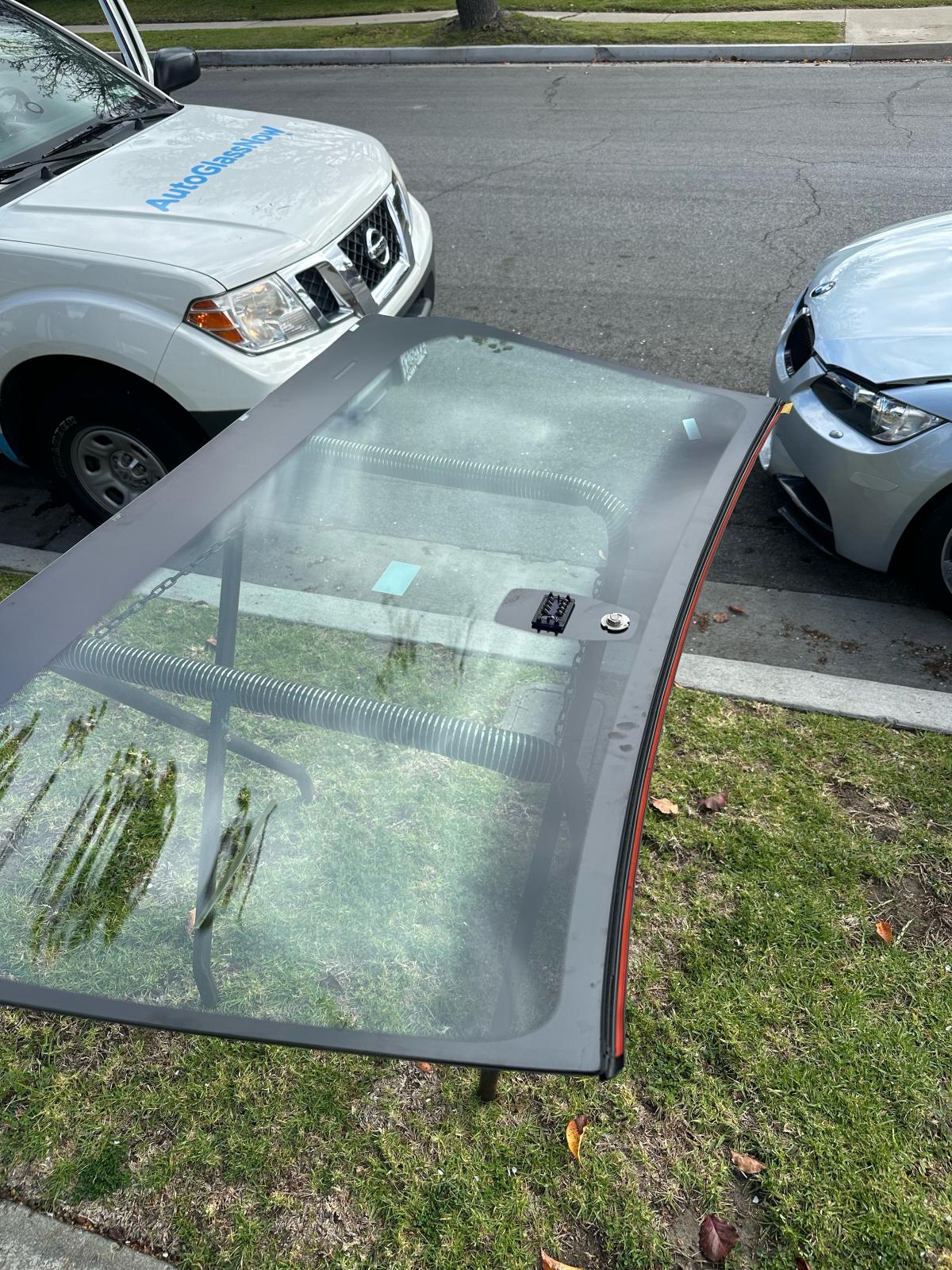

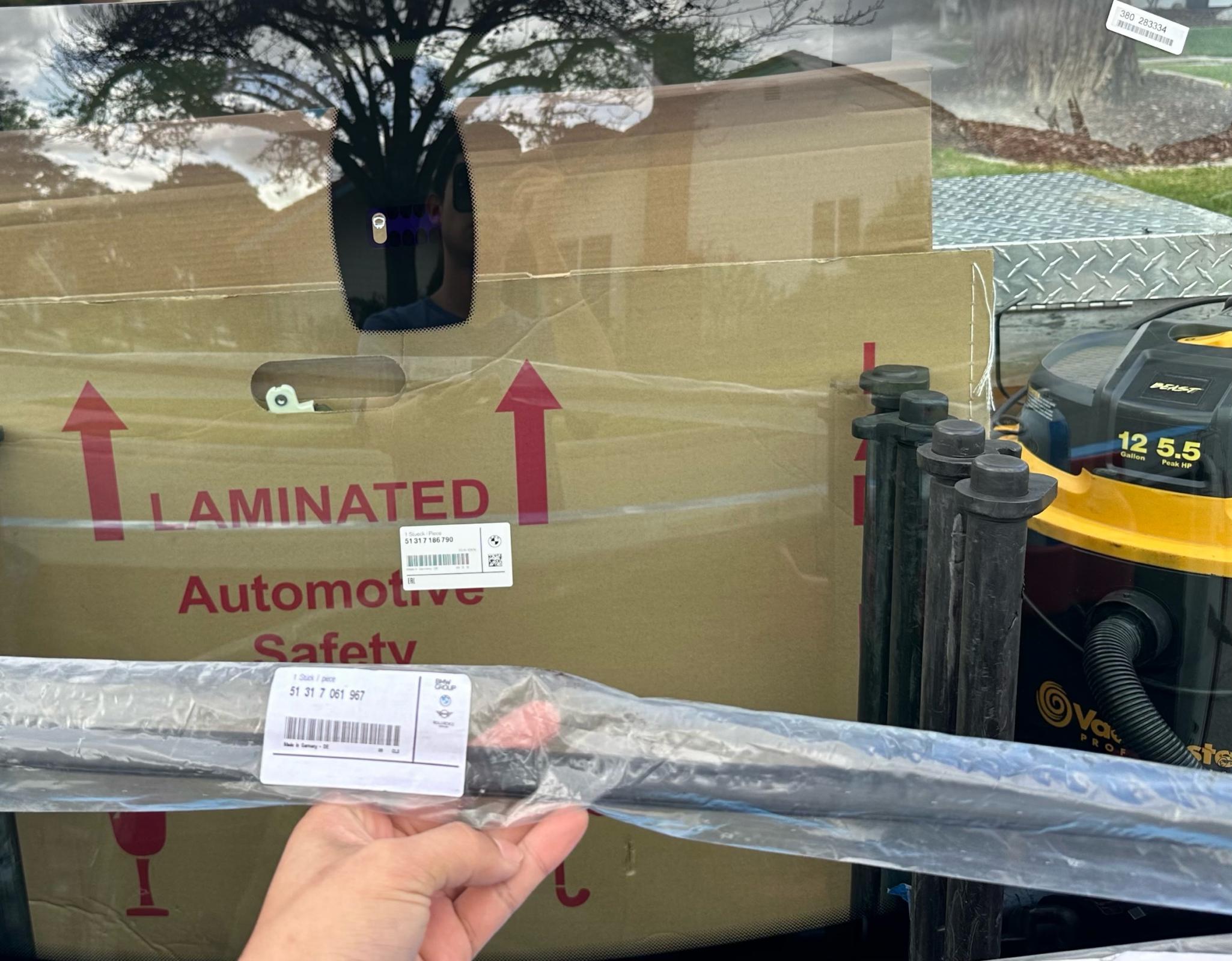

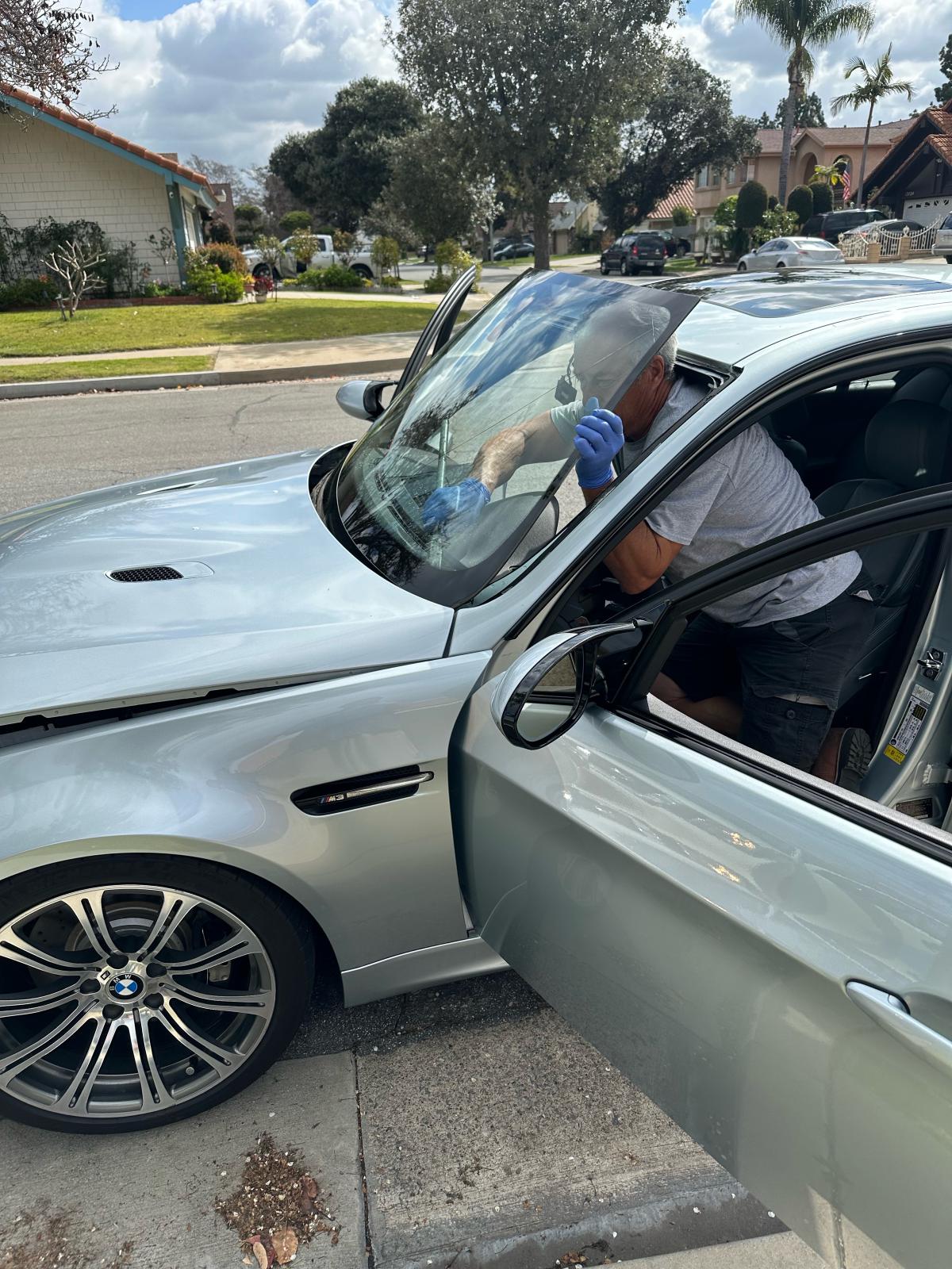

Bmw windshield and seals: pilkington bmw stamped all the way around 🔒 feels nice having no rock pitting and cracks. Never experienced that since I purchased it
That windshield replacement makes a world of a difference.
Eric, I recommend you get the front windshield Exoshield'd.
It's PPF designed for the front windshield...it's a necessary step to preserve your now new glass.
reidetailing wroteThat’s a good idea! I’ll definitely check it outThat windshield replacement makes a world of a difference.

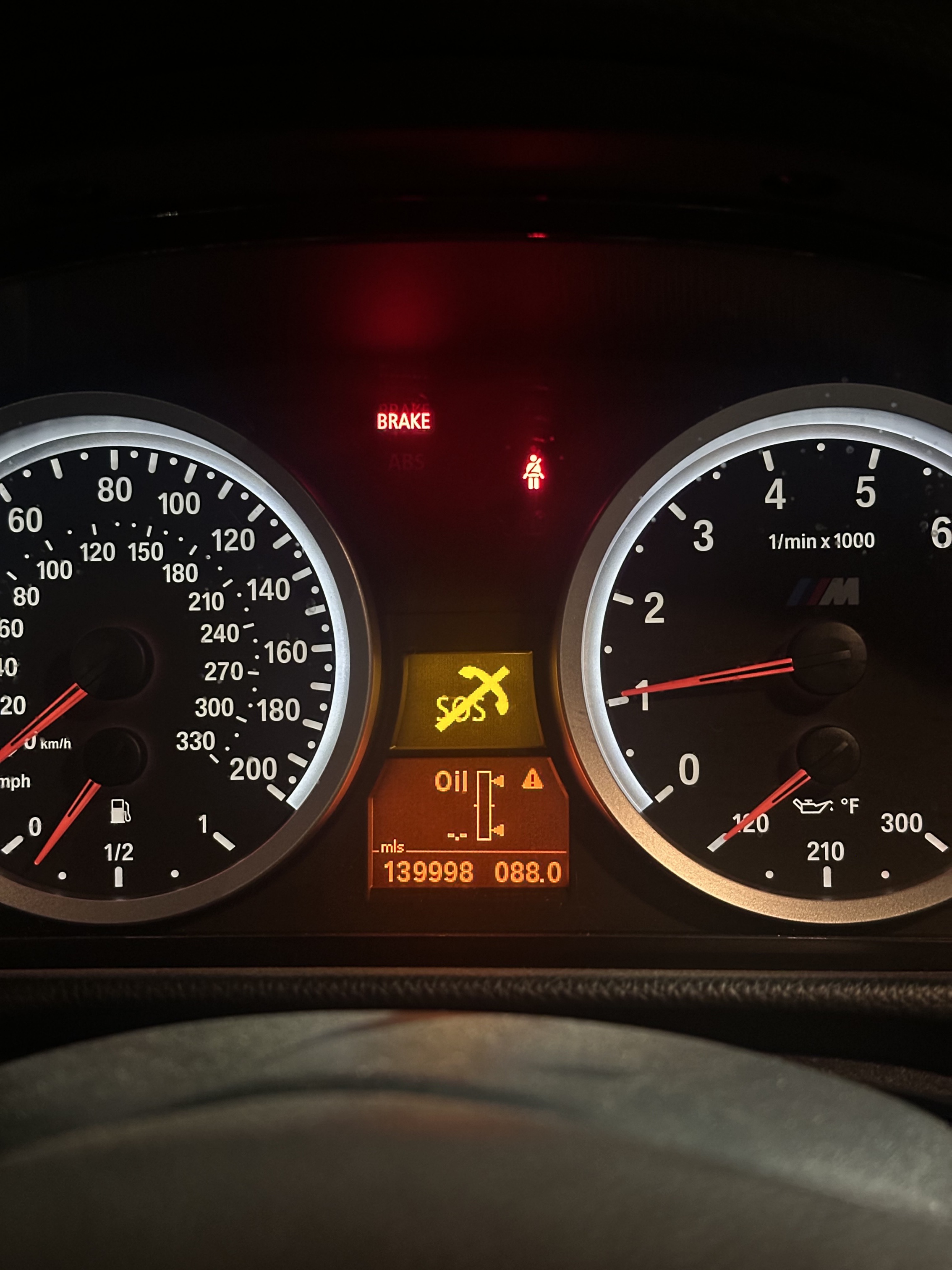

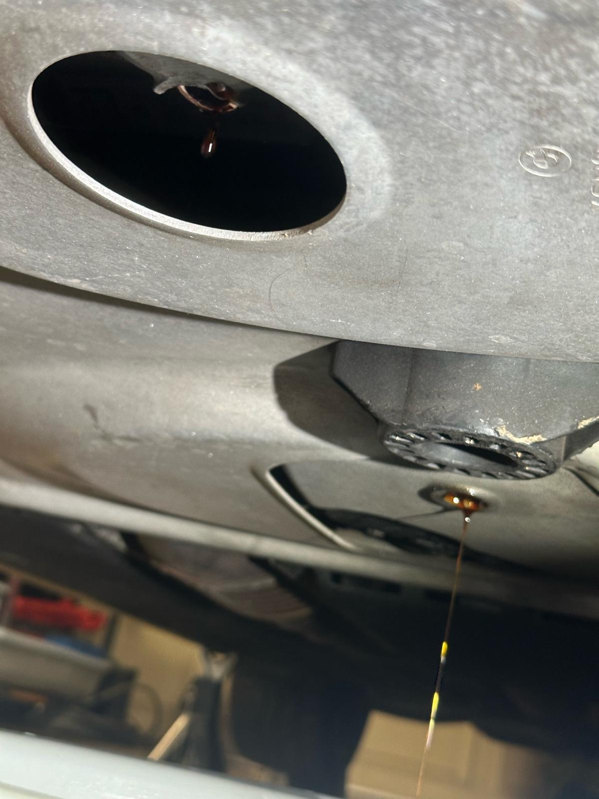

138000 mile or 222000 km oil change 👍 trying motul 8100 10w60 out vs liquimoly 10w60

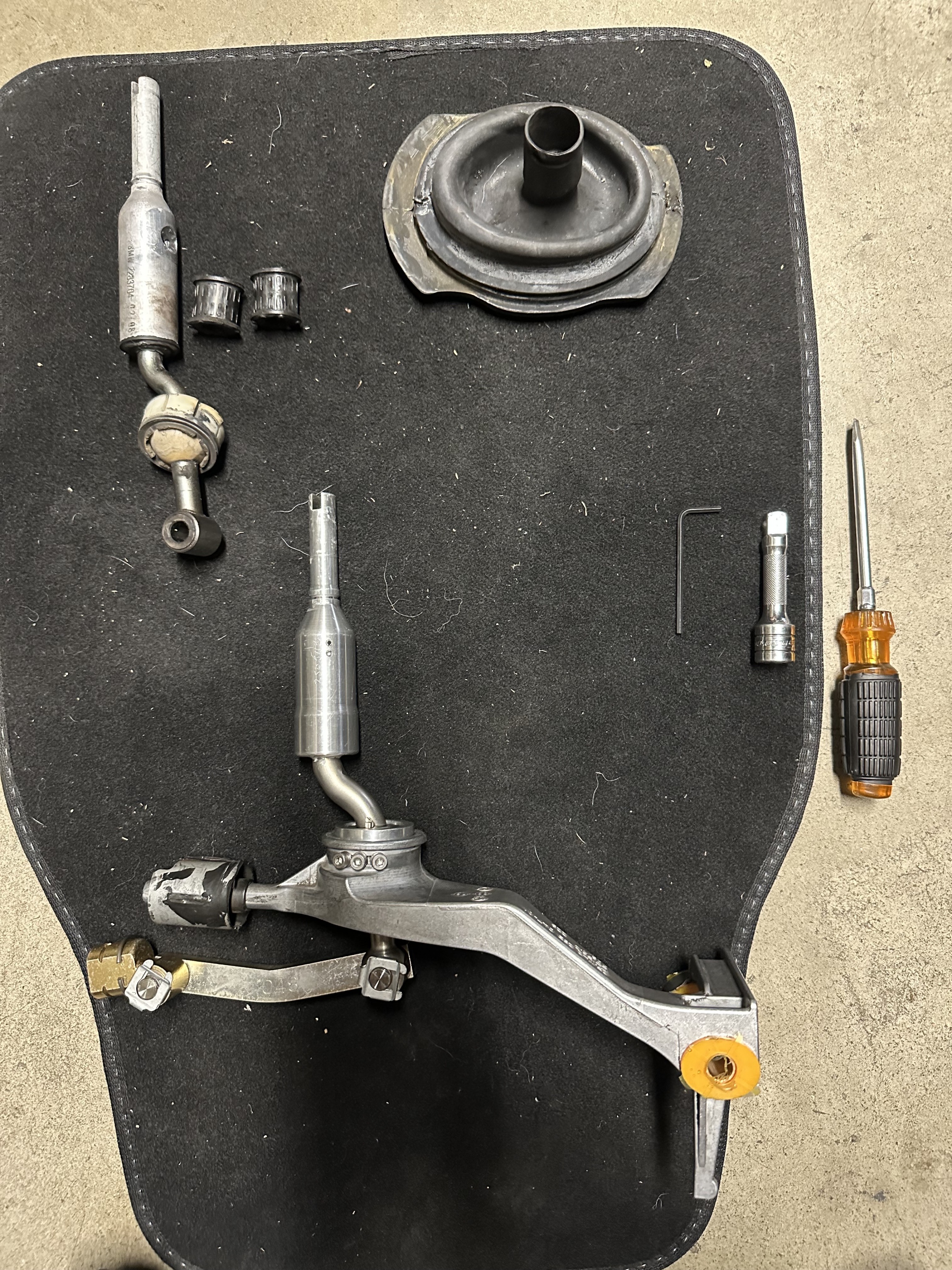

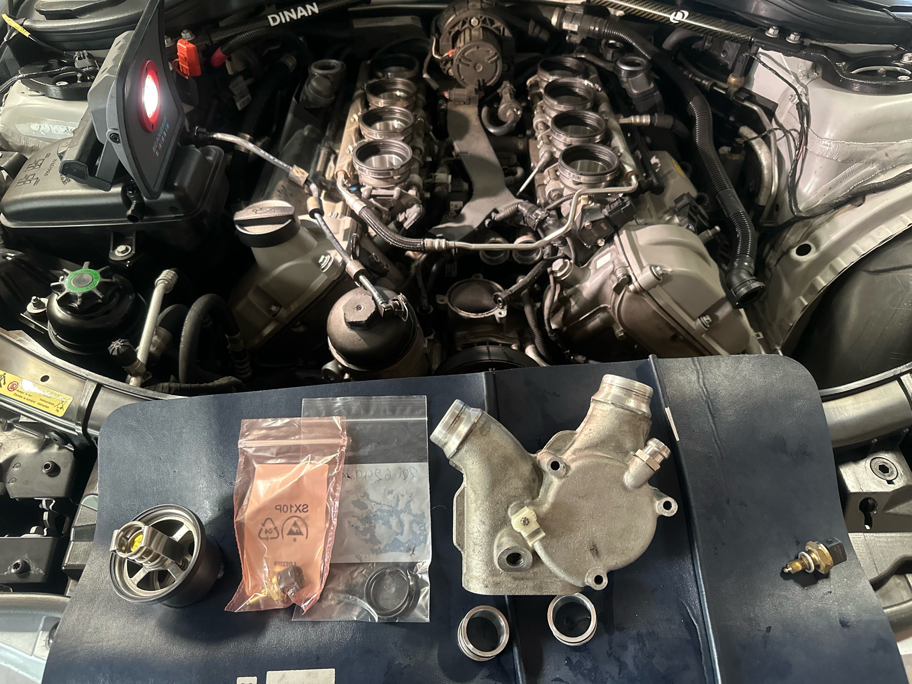

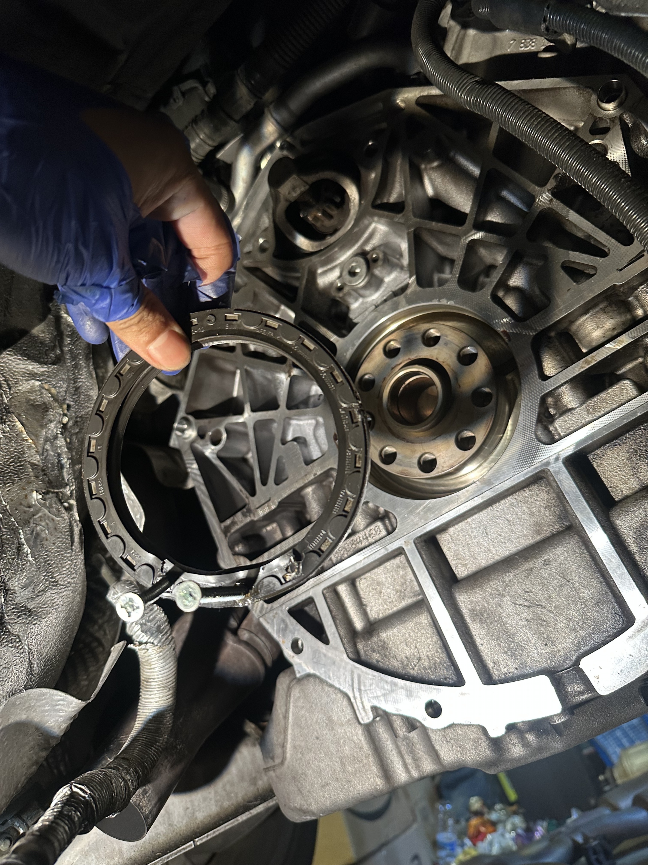

Big mainty: 141000 miles

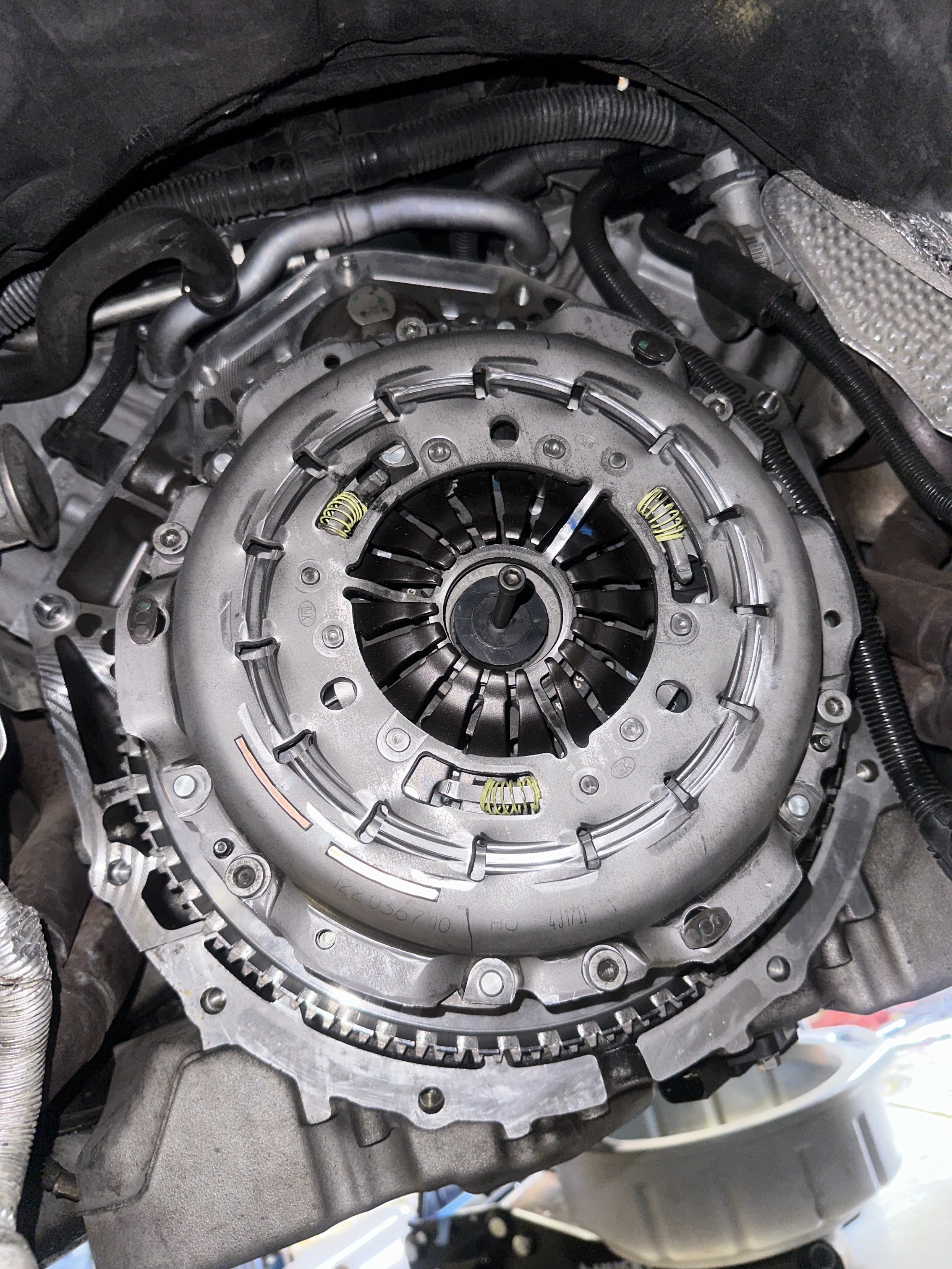

Thermostat, water pump, clutch, flywheel, slave cylinder, all possible seals, and an autosolutions 21.5% reduction shifter

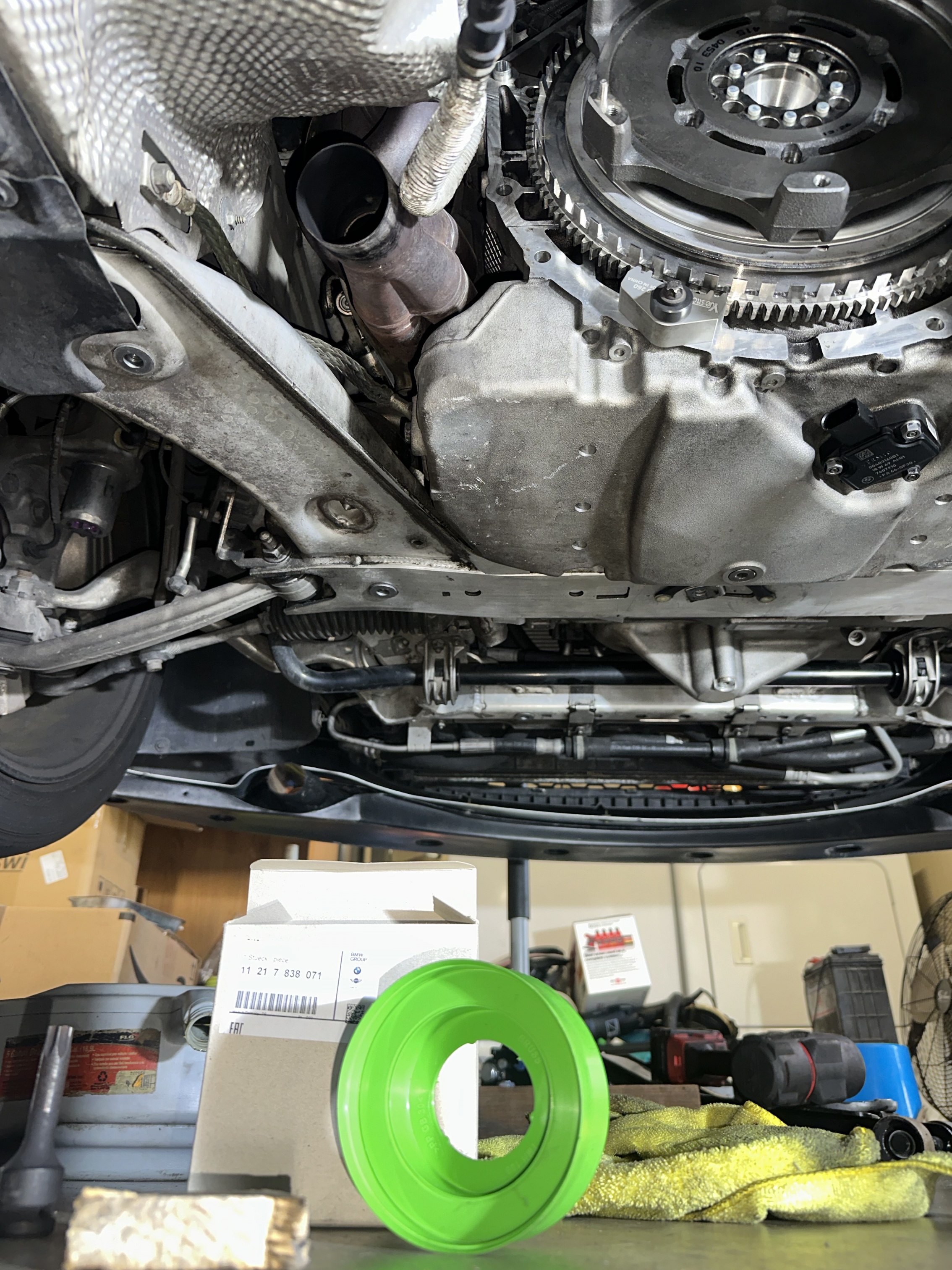

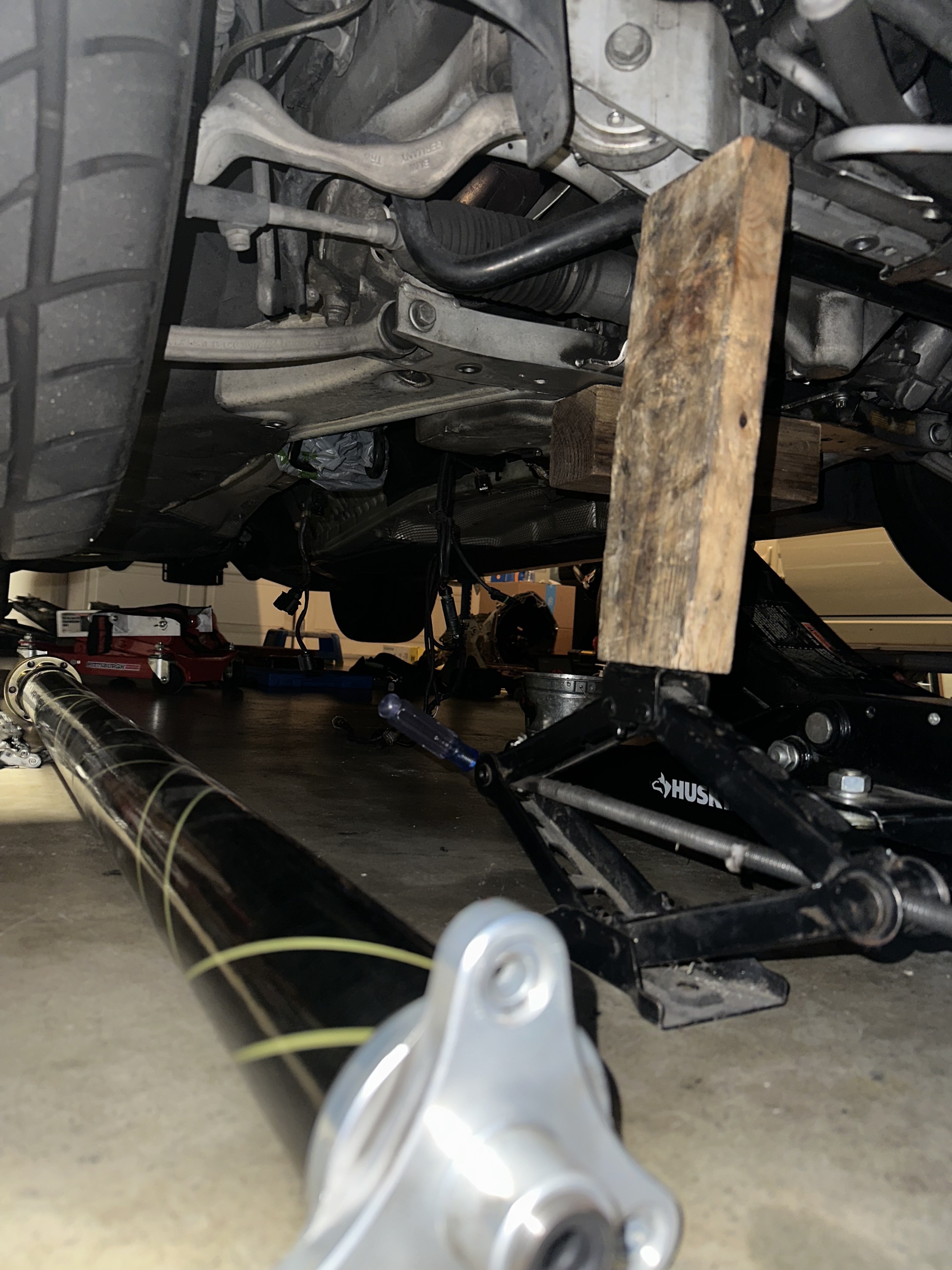

If you are working on the floor like me I used a scissor jack and wood to tilt the engine
Buy the oem rear main seal because it comes with the green fitting tool that makes installing it a breeze. And don’t forget the drei bond for all you oem heads

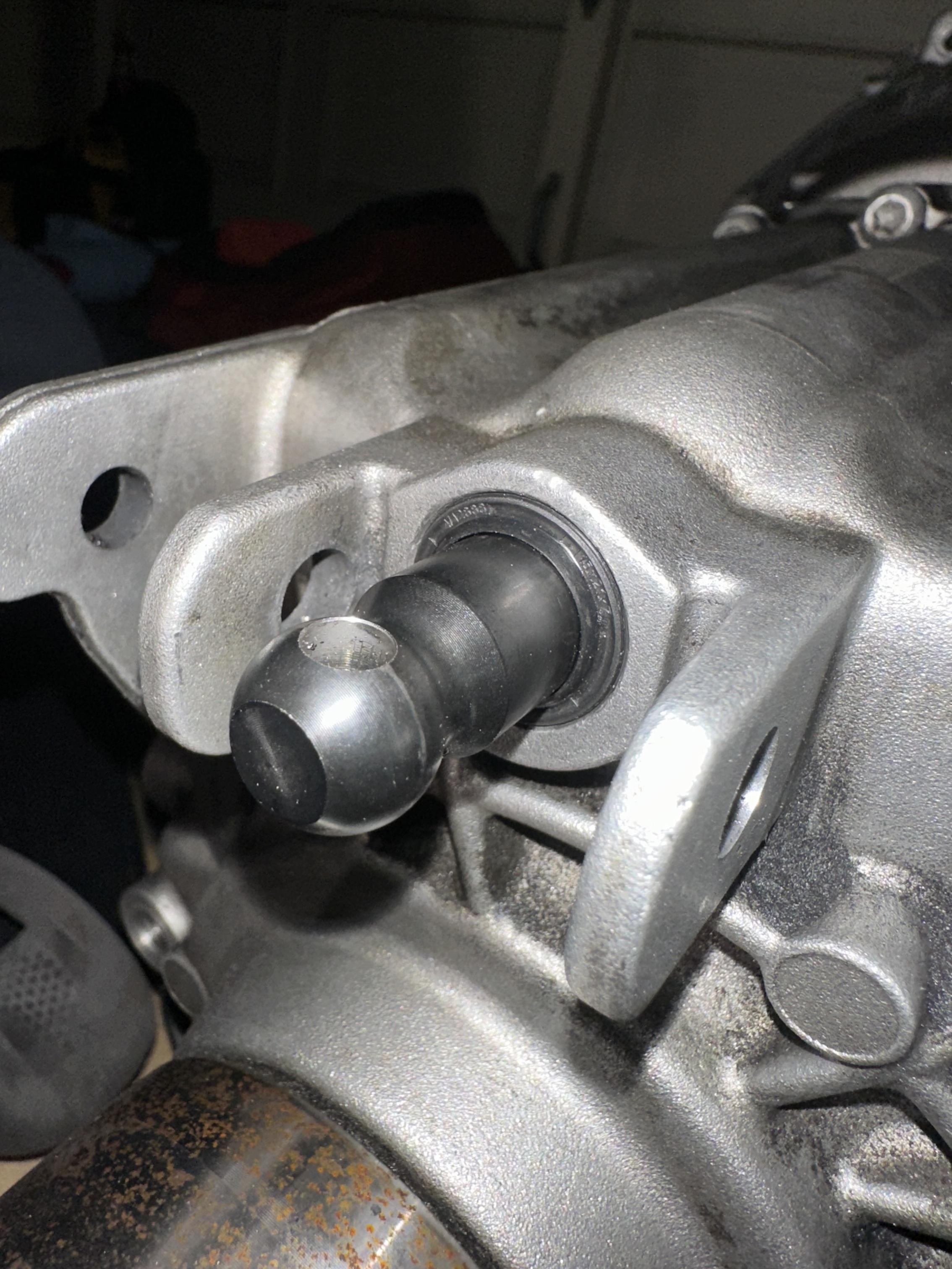

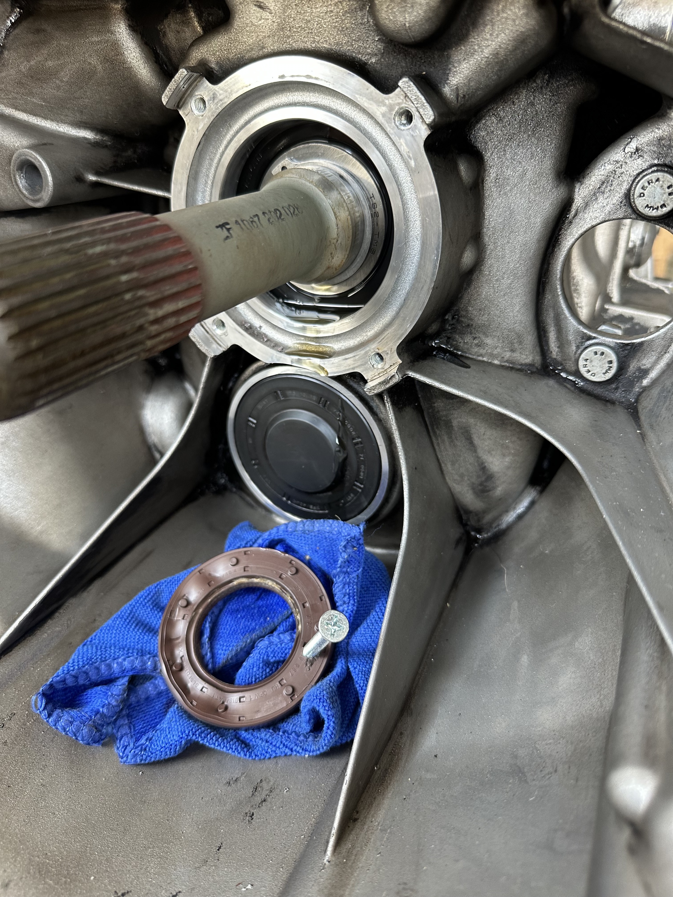

a long 16mm socket seats the selector rod seal perfectly. That was the only seal that was obviously leaking & brittle at my milage. The rest were ok but I replaced since I was there.
Good post there about your clutch job and more. It is clear you take your car work and documentation seriously.
I've been on Facebook looking for the torque spec for the pressure plate bolts and I think I have it figured out. You've helped me there as well.
It looks like you just went through this, so I'm curious if you can describe the process for installing the loose clutch disc, the pressure plate, and releasing the pressure plate. Like, how does that all work and what is the order of operations? This is the first OEM/LUK twin disc and self-adjusting-clutch I've ever dealt with...
Also, see the plug in your picture below the starter snout and above the rear main seal?
I'm kind of curious if there is an o-ring there that I should replace while I have the flywheel off. I'm going to check RealOEM to see...
Edit: Yah, looks like an aluminum crush-washer/o-ring with part number 07119963252. Might as well I figure. Similar torque spec as the transmission fluid strainer I'd imagine.

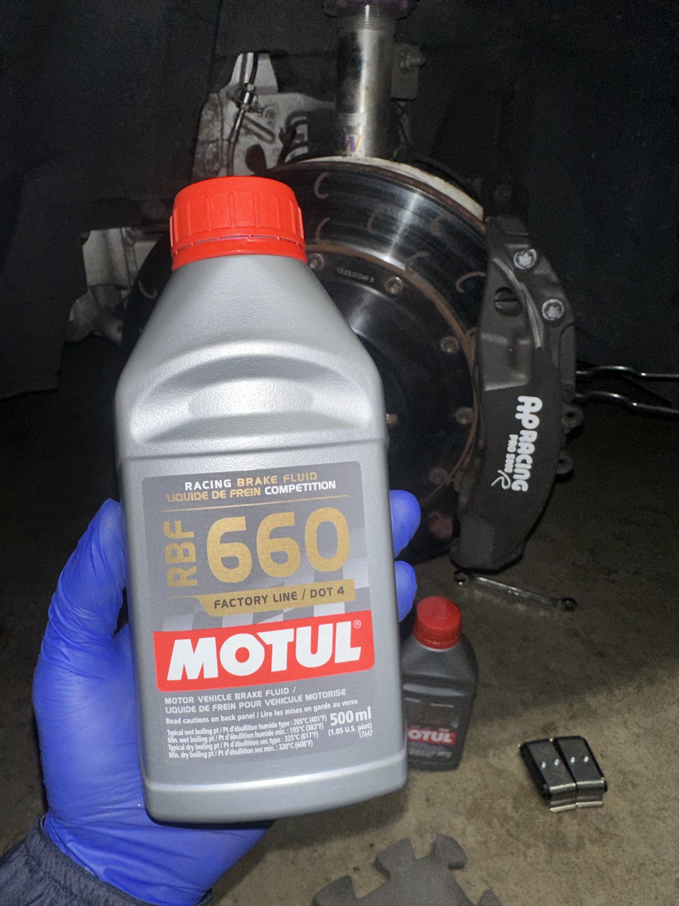

I've not seen many people use Motul RBF 660 brake fluid, but maybe I'm in different circles.
I would suggest you consider Castrrol SRF next time (or maybe Torque RT700 if that is more your speed).
Read on: https://www.sr20-forum.com/brakes-and-suspension/!72709-brake-fluid-recommendation.html?post_id=994375#post!994375

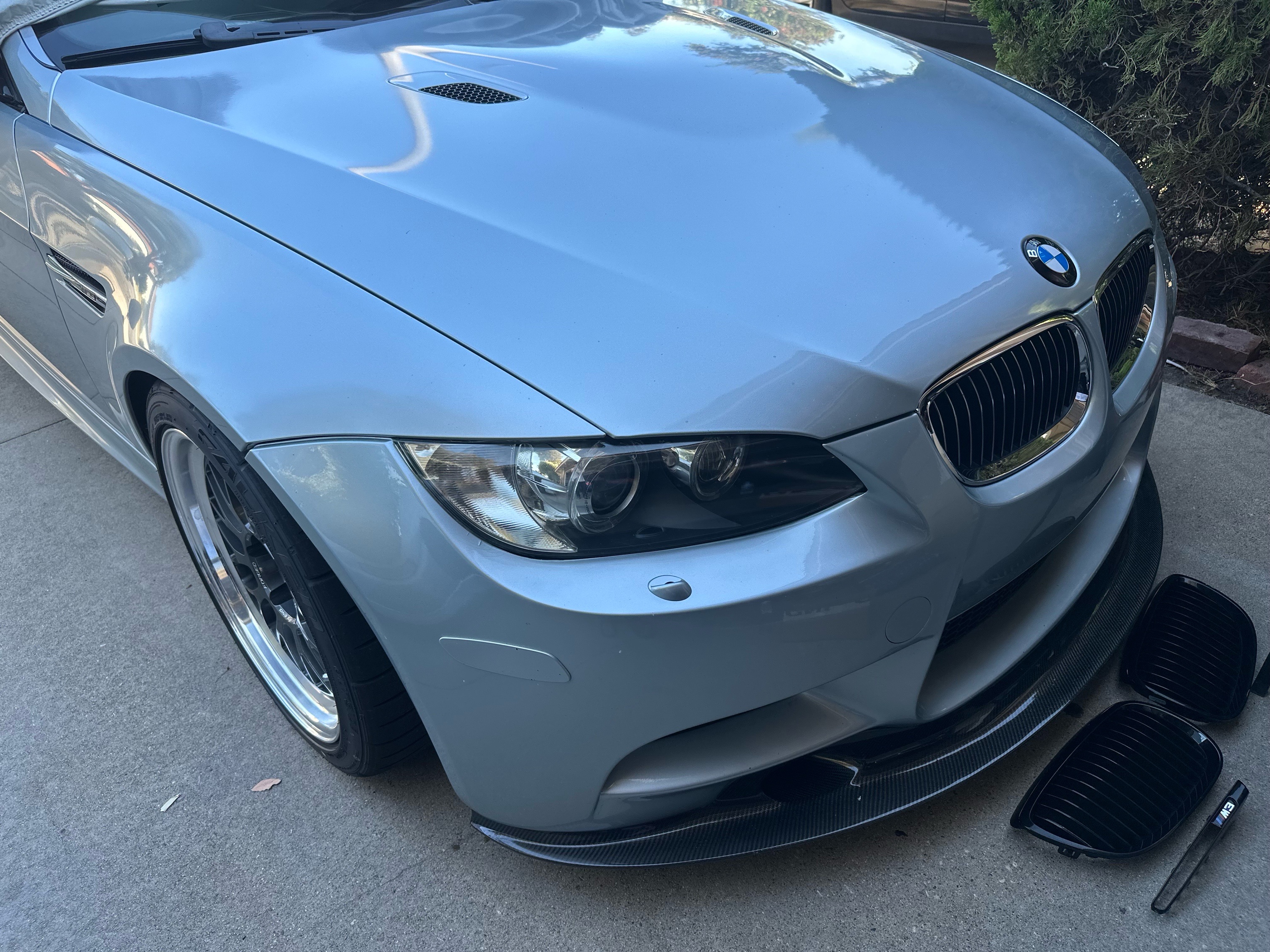

Dusted off my oem chromies that have been in the box since 2017. Am I getting older and liking unmodified cars or do I just like the chrome that matches the wheels
Erickuokwa wroteI'm in both camps this year. I'm getting rid of my black rear spoiler for a paint-matched item and swapping the black kidneys on both of my cars to chrome.Dusted off my oem chromies that have been in the box since 2017. Am I getting older and liking unmodified cars or do I just like the chrome that matches the wheels
Erickuokwa wrotechrome grilles, orange reflectors, no lips/diffusers is the wayDusted off my oem chromies that have been in the box since 2017. Am I getting older and liking unmodified cars or do I just like the chrome that matches the wheels

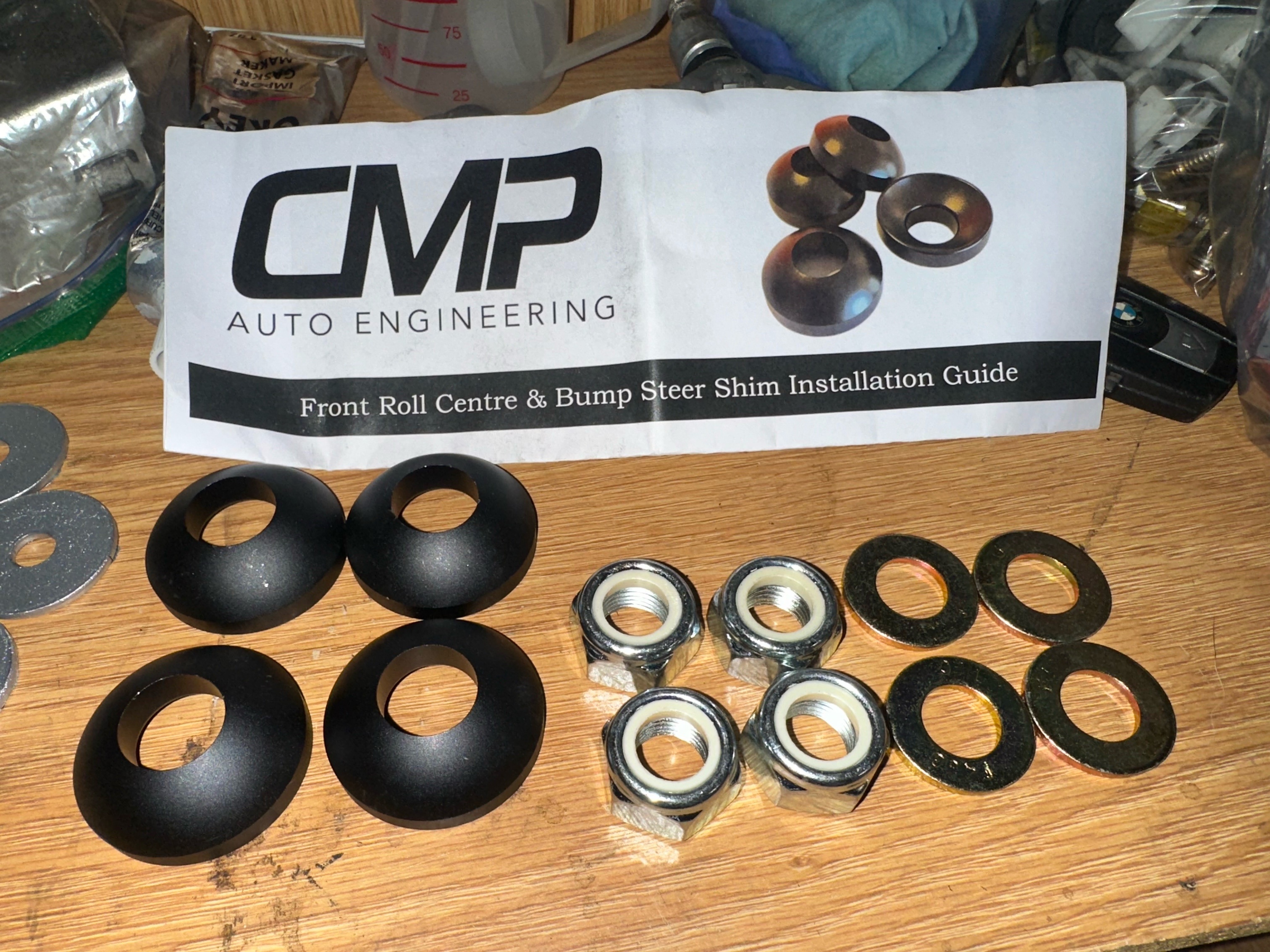

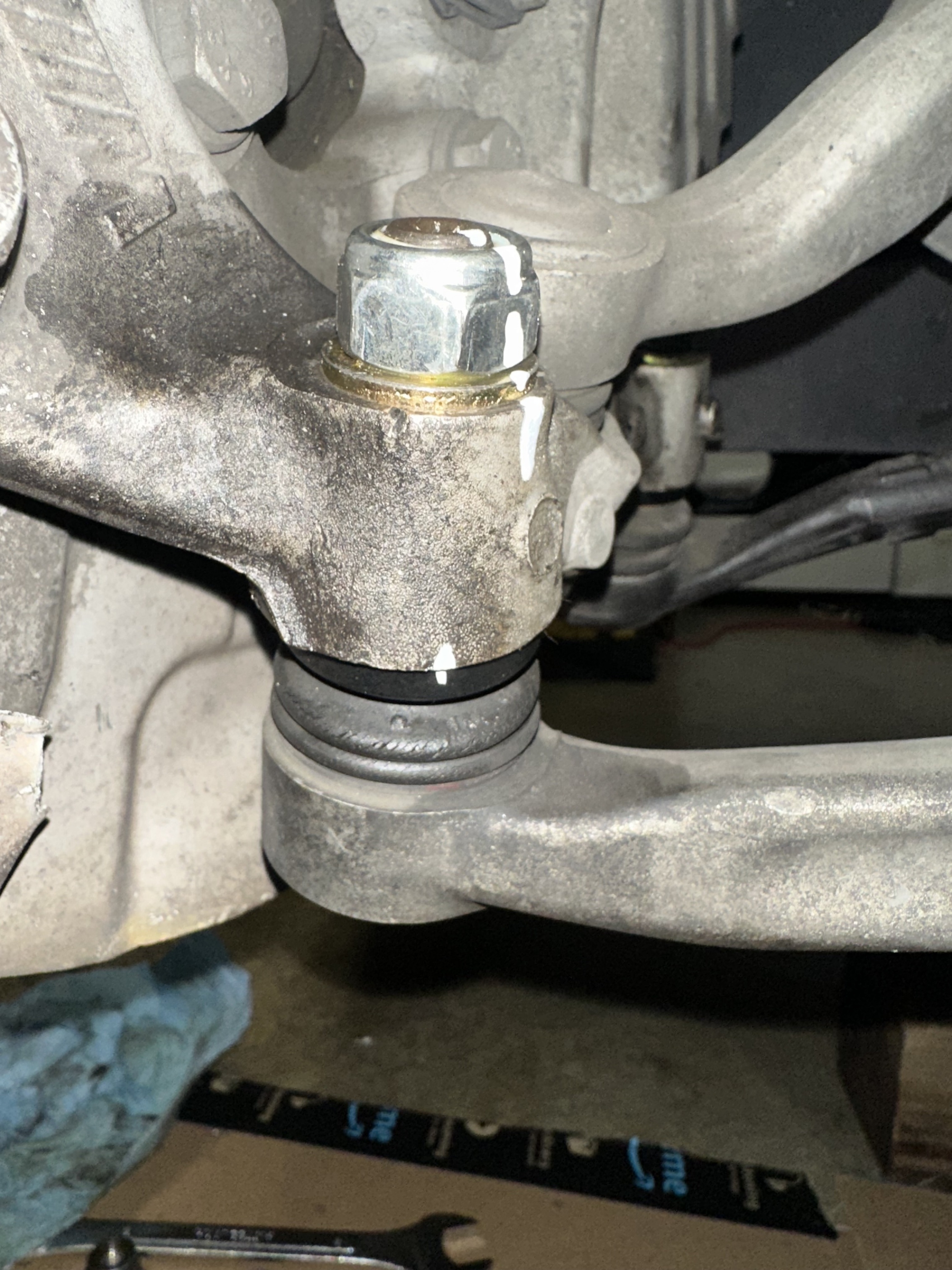

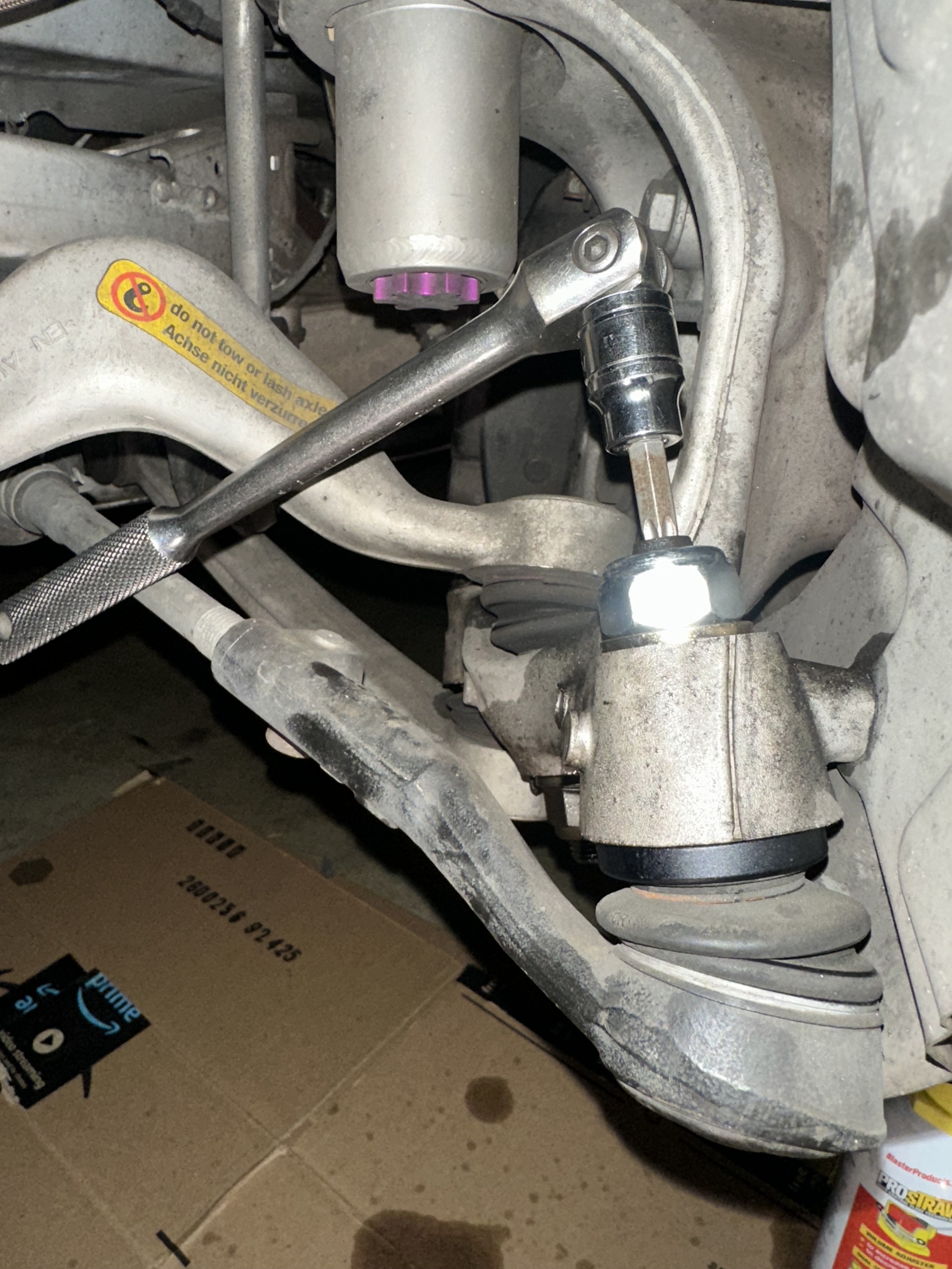

Installed cmp engineering tie rod and lower arm shims to help improve bump steer and roll center for lowered cars
Will update how they feel
Wow! The cmp shims helped tremendously! The best I can explain it, after 80mph, big bumps and drop offs of uneven road do not unsettle and drop the front end as much. It easily feels like I gained more suspension travel. Great great reverse engineering scanning the cone seat and adding a perfect shim to correct lowered cars

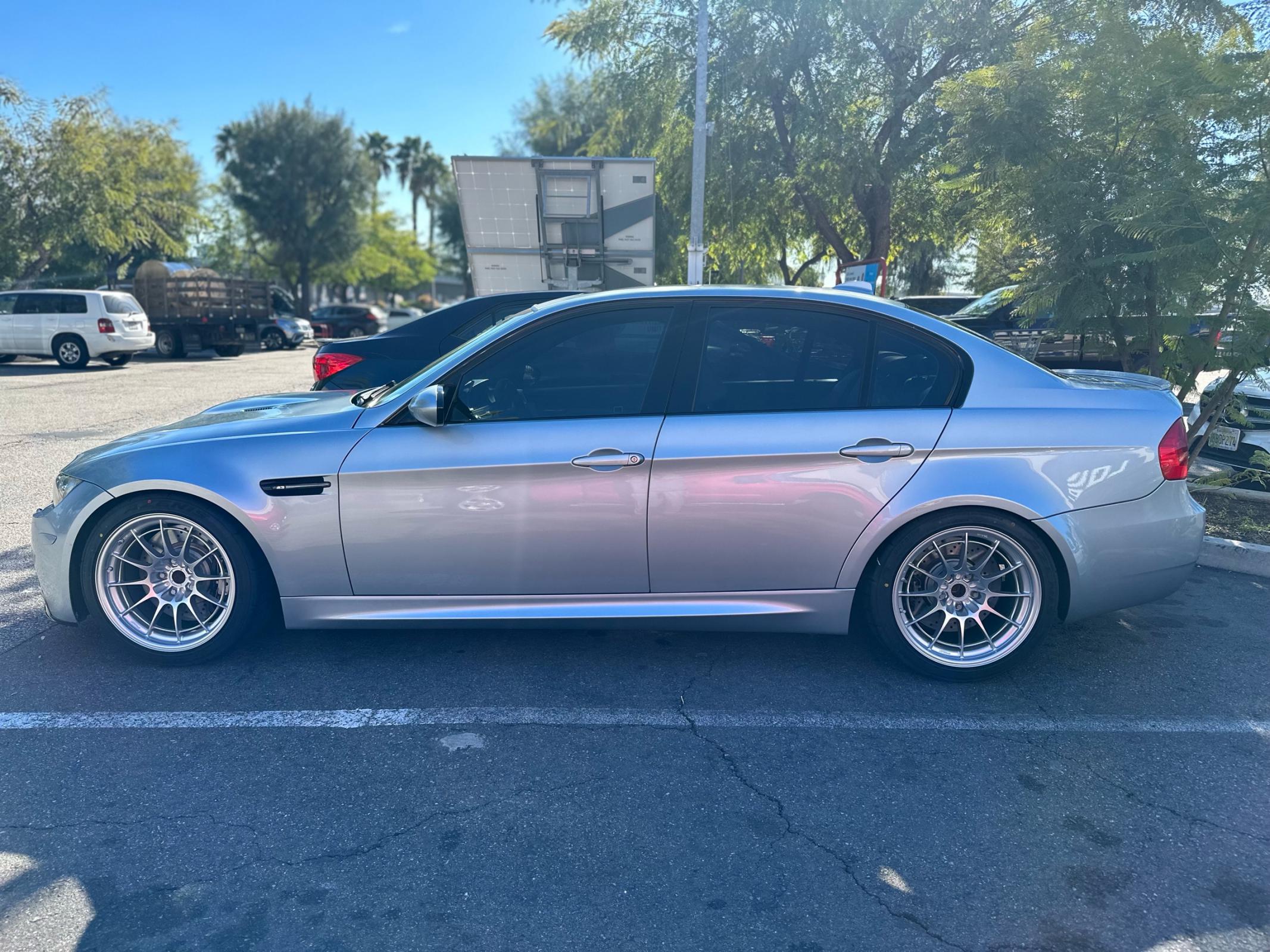

Ever since my stolen mag blues, my new to me 18” te37sl 9.5+22 10.5+20
I honestly been loving the stagger wide rears to stabilize the car. Matches my driving style a lot better
Erickuokwa wroteCar looks mint. Those 'Pressed' color TE's really do look the best on these. Aggressive yet still classy.Wow! The cmp shims helped tremendously! The best I can explain it, after 80mph, big bumps and drop offs of uneven road do not unsettle and drop the front end as much. It easily feels like I gained more suspension travel. Great great reverse engineering scanning the cone seat and adding a perfect shim to correct lowered cars
Ever since my stolen mag blues, my new to me 18” te37sl 9.5+22 10.5+20 as well. I honestly been loving the stagger wide rears to stabilize the car. Matches my driving style a lot better
Never heard of these shims but curious to try them out myself. In my Subaru days the bump steer and roll center kits were mandatory when lowering a car, and I had wondered why it was never mentioned on this platform. I'm guessing ride quality in general wasn't affected much by this, if at all?
