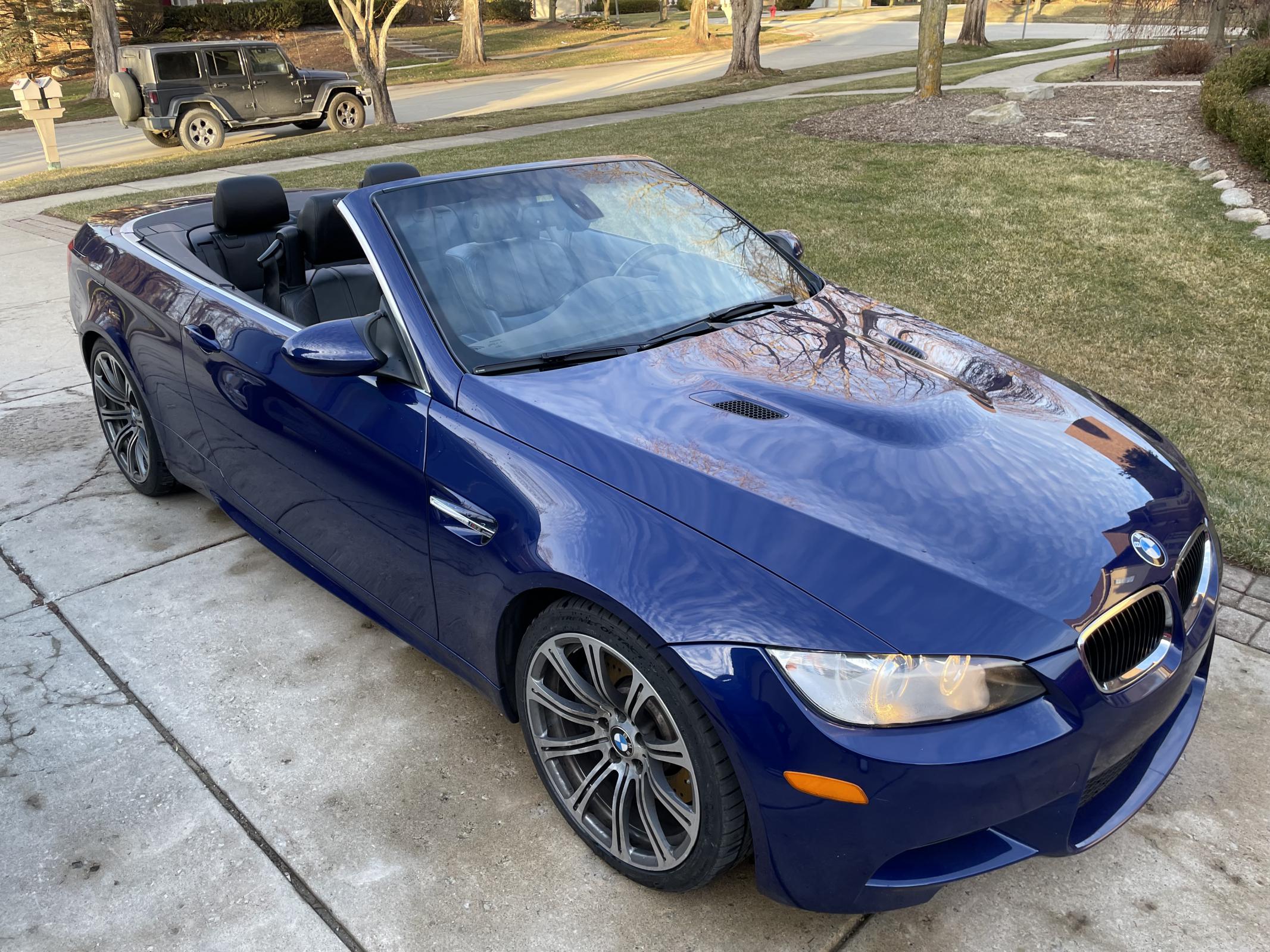

Thanks. Here's one...I've since cleared the headlight mist, washed, clay bar cleaned, buffed, and waxed - looks great :)
Very nice:cool:
Interlagos blue? That's one of my favourite colours! :)
I do believe that is the color name...it is nice. Initially, I was just looking for a 4-seat hard-top convertible with a descent engine - there's few options. That this used car popped up, also being an M3, last year with a V8, in a cool color, 45k miles...I'm very happy - found at a HONDA dealer no less.
