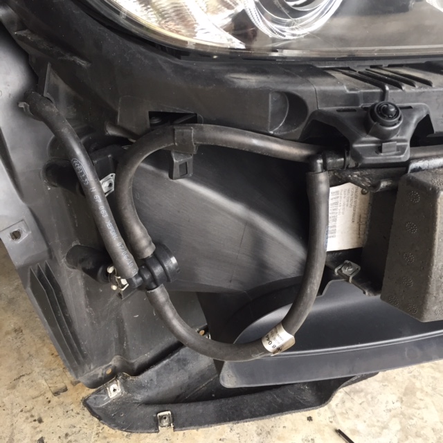

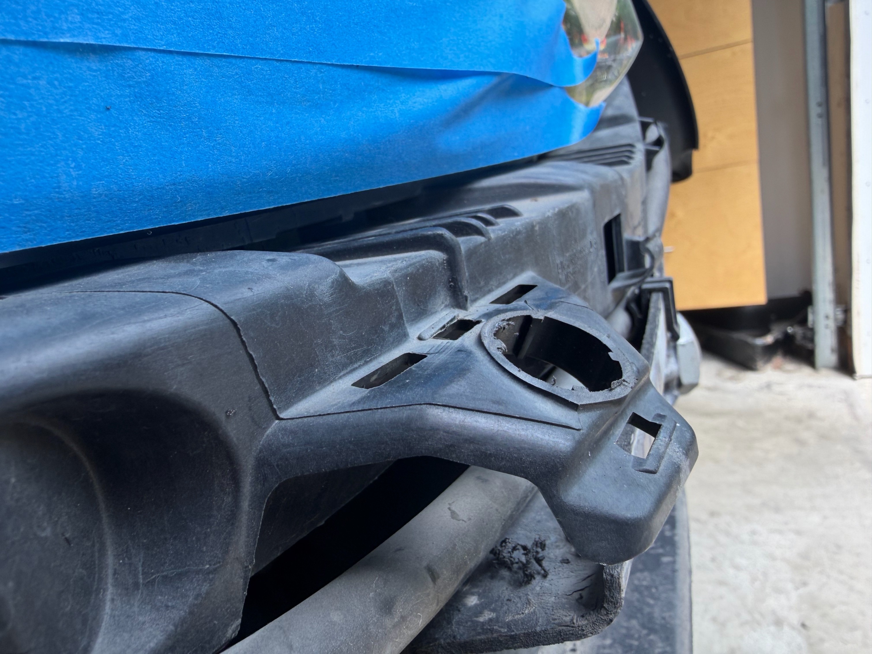

Took off my bumper today and finally got to see what the headlight washers look like. There were 2 not-good surprises:
1) the hoses are pretty thick and big, and the one coming from the pump looks to be pretty deep into the engine bay, gonna be fun trying to track it to the pump....
2) the nozzle brackets are part of the bumper support and look like they cant be removed...only the nozzle itself. I wonder if just removing the nozzle will be enough clearance to mount my euro bumper that doesn't have headlight washer holes?

BigRussia wroteDid this end up working out? Did you have to cut anything or change the bracket?Took off my bumper today and finally got to see what the headlight washers look like. There were 2 not-good surprises:
BigRussia wroteThat looks pretty straight forward... disconnect the T junction and plug it. Remove the rest of the tubing/nozzles/etc thats running across the bumper support there. Code out headlight washers in the JBBF module. Done.Took off my bumper today and finally got to see what the headlight washers look like. There were 2 not-good surprises:

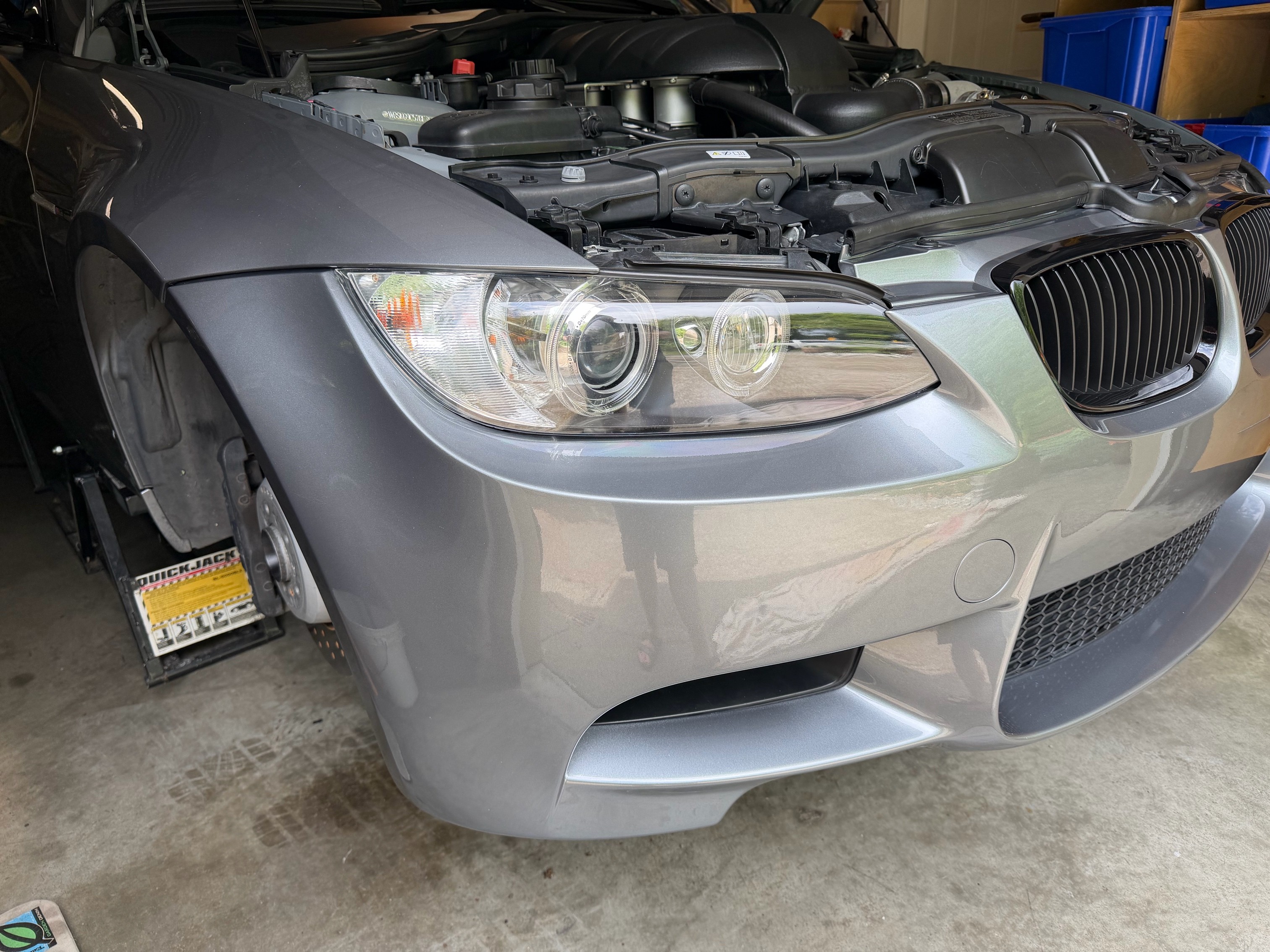

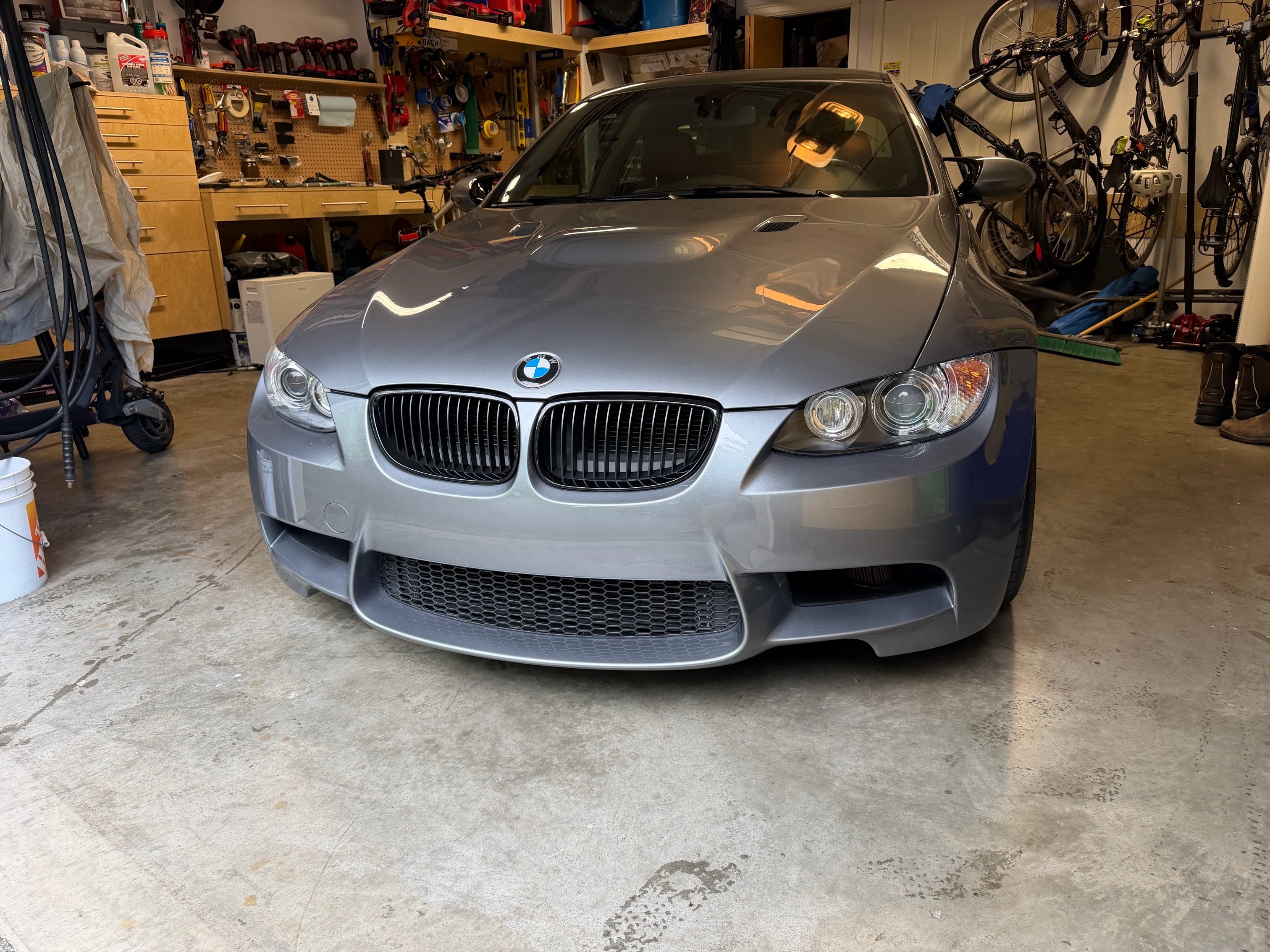

Just deleted mine. Needed to shave down the washer nozzle holders.
I think it looks great.
I am curious why you had to shave the headlight arm/bracket? As far as I can tell there aren't different headlight arms (which is the piece that supports the nozzle for the headlight washers below the headlights) for cars with/without headlight washers. That piece you shaved shouldn't interfere with anything on a Euro bumper, once the washer nozzles are removed.
I just went through this with an ECS Euro bumper and it fit fine without shaving the headlight arm on my car. I just removed the nozzles and the hoses back to the T junction on the passenger side.
