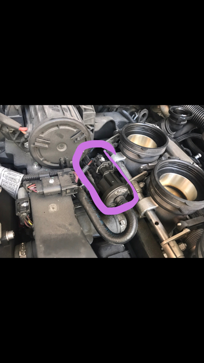

This won't help much but once you take the plenum off it's in the top right drivers corner. It's really an easy swap, about an hour DIY at most if you have ever had the plenum off before, if not then maybe 1.5 hours.
I don't know how you guys are pulling off the connector, I had a bad time trying to get the connection off the valve. What are your secrets?
Mine came right off.
If you unplug it from the other end you can take the valve and back hose out completely and it’ll be a little easier. It’s a coller connection and it’s along the drivers side where the wheel well indent is. I saw a video that said to use a pick set but I resorted to fighting with it until it broke so either way works

Honestly it’s really self explanatory take the plenum off unplug and disconnect old one reconnect and plug new one

Yes that back connector is difficult. As recommended before follow the hose along the firewall. There is a twist connection there. That way you can work with the piece without leaning over the engine. It seems you have to push the fitting towards the valve before pressing the tabs.

that rear clip that everyone is talking about sucks. i took the front tube off, then i removed the actual valve from it's mount, and i was able to rotate it to get a better grip of the clip. i actually used some pliers to pinch the collar instead of the lower part of the clip and it came off pretty easy. when i reinstalled the clip- i saw how it confuses everyone. the stippled part of the clip slides rearward, rather than pinches together. its an odd clip.

It is definitely worth doing. The only issue is disconnecting the valve from both clips as others have mentioned. But you will be fine.
My replacement part came in this past Friday and swapped it out later the night. Job took me a little over 3 hours, given it was my first time taking off the air intake plenum and I was taking my time. The only part that took some time was taking the tubes off, other than that it was straight forward.
