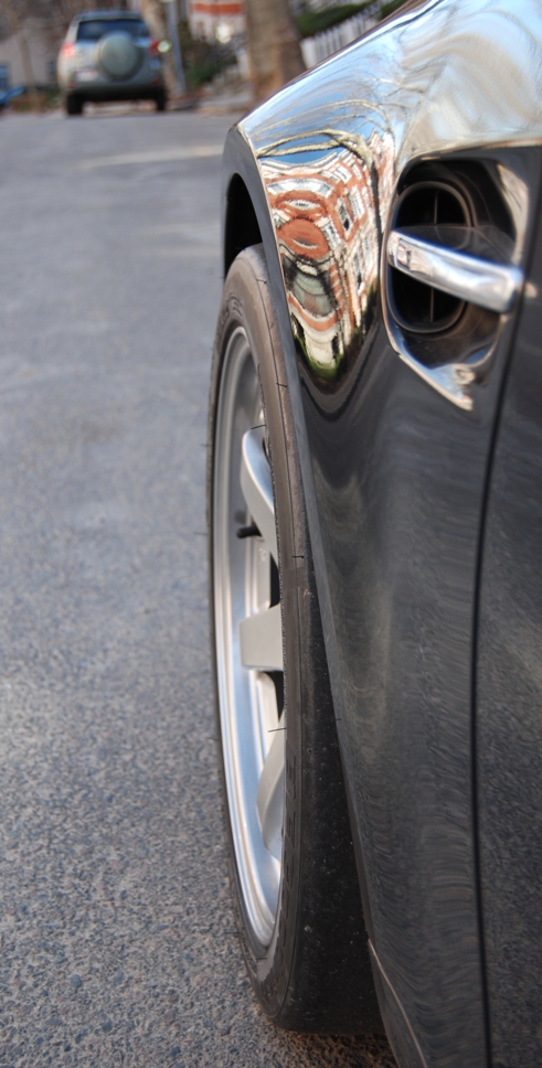

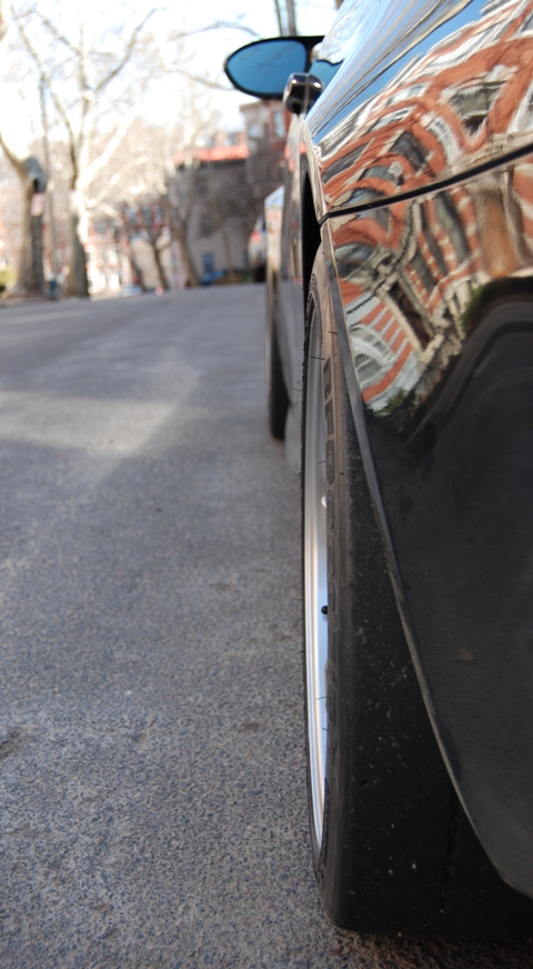

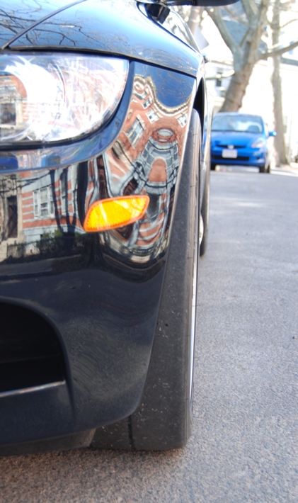

I mounted the TE37s I purchased last month to check for fit. The specs are:
18x9.5 ET28: 265/35 BFG
18x10.5 ET30: 285/30 BFG
Suspension is stock for the time being. (I don't want coilovers on this car--at least not yet.)
I might run spacers in the back, but haven't decided what size...
Here are some pics, including the stock 19" wheels with PSCs on for comparison.

Looks good. I was wondering two things: Did you measure the front and rear track? I would like to sompare it to the stock track measurements. Second, does the rear feel loose? It looks like you could use spacers in the back, as you suggested. The track actually "looks" narrower than the front.

I didn't measure the track width. Track width, as measured by the distance between the center of the tires on the same axle, should not change much with the front setup since the offset is only 1 mm off from stock. The rears are about 7 mm off though, so that would translate to a track reduction of 14 mm. I don't think that is significant enough to make the rear feel loose, but I haven't driven the car hard with this setup yet. The stock track is 60.5" front and rear.

Nice track setup. Strange but to me they look smaller than the stock 18s for some reason.

You are correct. The tires have a smaller diameter. Stock 18" PS2 are 25.7" F/26.3" R. These are 25" F&R. You are limited by the sizes BFGs come in.
