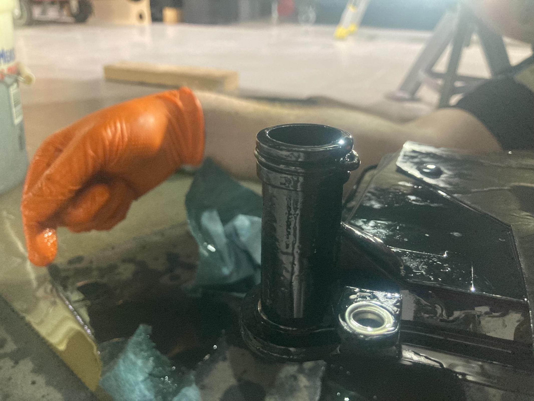

This thread has gotten a bit off topic but I figured I'd update on my situation. I dropped the pan again this evening to find that the o-ring at the top of the suction filter rolled out of its groove upon installation. Easily avoidable mistake as you can see all the way around the seal if you crawl around a bit. Luckily the bore it sits in has a hefty chamfer, so the seal was still in fine condition.
I also had actually been trying the URO cast aluminum pan that Hivand mentioned earlier in the thread:
Originally Posted by Hivand_M View Post
A bit off topic but anyone try below DCT oil pan? Seems like a carbon copy of the OEM one but made in aluminum and is a bit cheaper, $156 vs $183 for OE.
https://www.fcpeuro.com/products/bmw...ts-28108070791
but it was weeping fluid at the back so I returned it and got a Getrag pan to replace it. I would advise against the cast pan, it had a lot of flash and sharp edges left over from manufacturing, and the seal is a different design that did not seem to want to seal. I also think the metallic pan may have amplified the noise, some searches led me to other threads linking metal pans and weird DCT noises.
After reinstalling and refilling with the OEM pan, the sound was still there but was much quieter while laying under the running car.
With the undertray installed and the car on the ground I could barely hear it, making me question whether I just didn't notice it before my initial service, and the combo of the slipped o-ring and aluminum pan amplified it.
Either way, at this point I have checked and rechecked everything I could so I'm going to try to move on with my life and will keep and ear out for any change.
DrFerry6730.00

Dear uhhh_maks
So you think the basic solution is to change the o-ring? Can you please upload some photo which o ring is this, or just add here the OEM number
You would help a lot since i have the same sound but not that often You have it, i have 7 times each 48 seconds! And only in neutral. Would you be so kind to check, do you have it also in 1 or R?
Thank you mate !!!!!!!!!!

Dear uhhh_maks
If you haven't done a transmission service ever, I would recommend that. The o-ring was part of the filter: https://www.fcpeuro.com/products/bmw...ag-28107850148
I didn't measure the size unfortunately.
I just checked and it only happens in neutral. The noise stops as soon as I press the brake pedal. I can definitely still hear it but it is very faint with the car all buttoned up.

Originally Posted by uhhh_maks View Post
If I lay under the car I can feel the noise very clearly with my hand on the transmission pan, so I'm 99.9% sure its the DCT.
The only thing I can think about regarding the brake is that the car is assuming you're about to shift into gear so it does something to prepare?
The idea of the braeak sounds reasonable.
So just to summarize:
- Is this sucking thing is happening in all DCT, just another dct has no loud noise together with it?
- Have you ever checked any other dct where at least its possible to feel on the dct with hand as you wrote, but no stupid noise with it?
- What I'm thinking about, that maybe it's a software or a sensor issue? and normally this should not happen in neutral, just only driving, cause it's so crazy that many people never ever hear it.
- Basically the noise is done by the jet pump or the failed suction because of the old sealing, what you think is more logical?
And again thanks for your thoughts
      03-07-2024, 01:15 PM   #66
uhhh_maks
11
14
Drives: 2012 135i
Join Date: Nov 2023
Location: Boston, MA
- I have no idea
- I have not
- Again not sure, it's clear the noise is controlled by software or something given the rhythm that it happens
- For my car, it was pretty clear that the noise was made much louder when the oring was not seated properly
