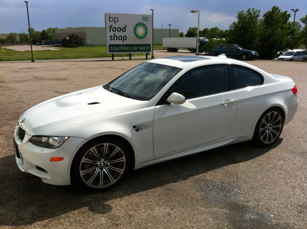

Well, I found the car that I wanted. A manual 09 coupe with the tech package, 19' wheels, premium package, cold weather package.
Drove yesterday to Chicago and took delivery.
