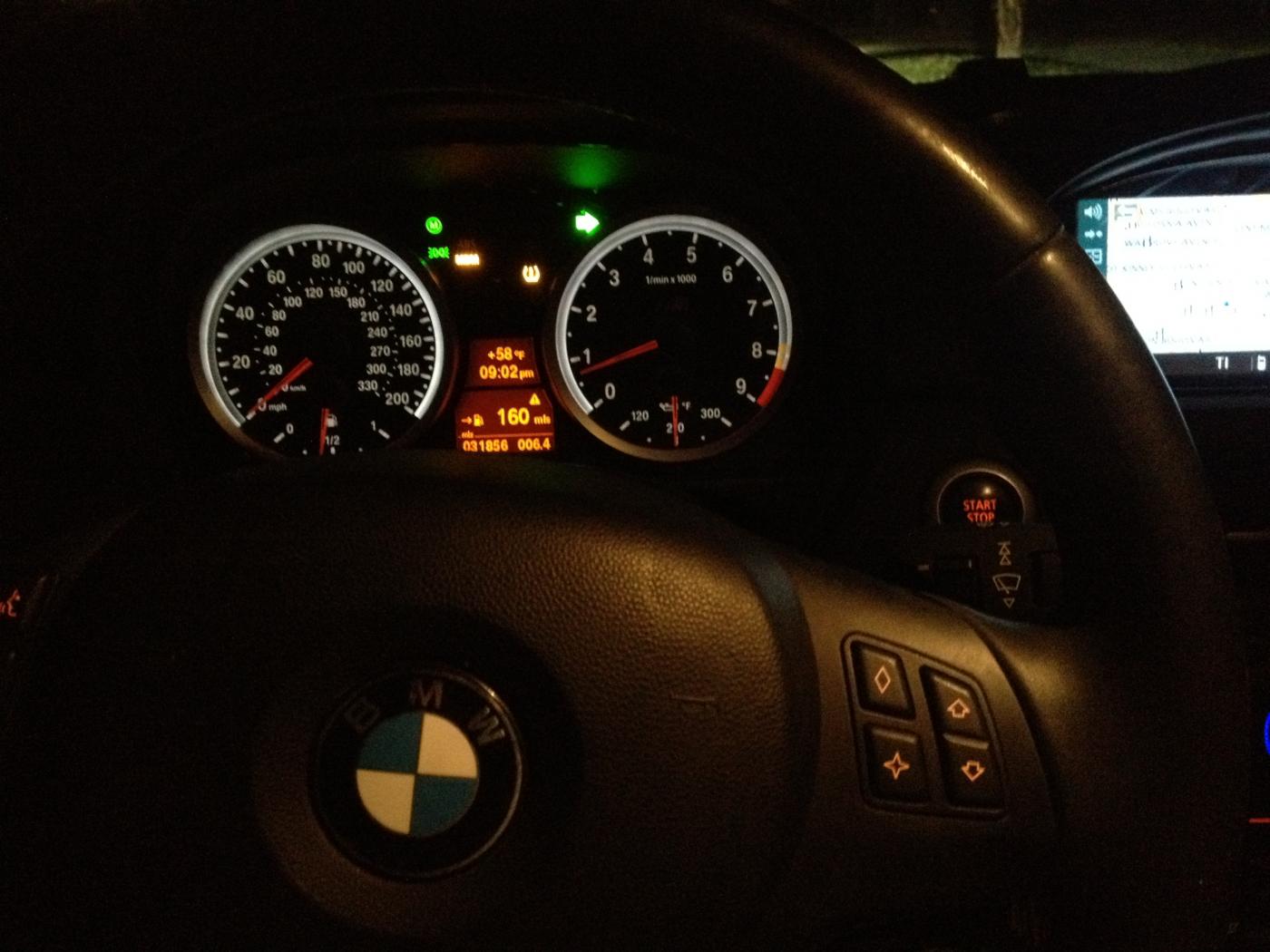

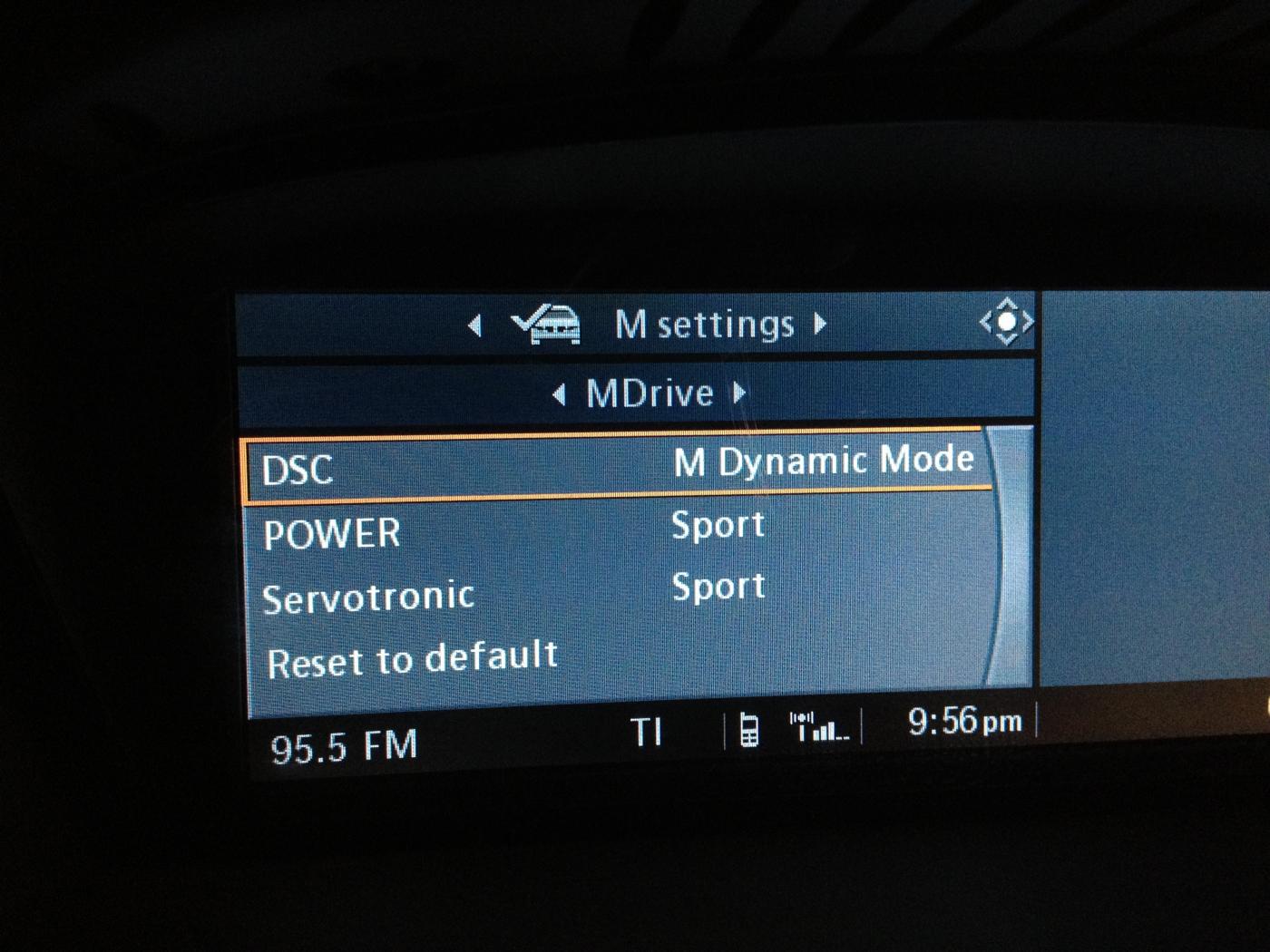

First successful M3 M-drive (including MDM) retrofit
My car was a very stripped down 2008 e92 that shipped without M-drive. No sport plus throttle, no servotronic steering, no M-dynamic mode (MDM).
Thanks to the technical assistance of Andy (BMWM.D.) and the coding brilliance of Mike Benvo, I am pleased to present a fully functional M-drive retrofit.
It has been a long day (and I have a track day in the morning), but more details to come. If people are interested in the retrofit, drop a message as we are going to try see about making this available to more people
And also thanks to Mike for his additional coding of:
- Euro MDM
- door chimes removed
- key gong removed
- welcome lights changed
- amber corner delete
- double high beam flash
- double emergency flash
- economy drive indicator
- auto-door unlock
- remote mirror folding
- auto-door unlock
(and anything else I may have forgotten)
Photos for proof below (sorry for the size; I'll try to resize and reupload later):

Frequently Asked Questions
1. How much does this cost?
Retail on the necessary hardware is ~$700, but is available from vendors from less. I have also talked to a BMW dealer about possible group buy pricing. Otherwise, there is always the used market.
You also need to pay for coding and calibration.
2. Does the servotronic steering work?
Yes, everything works. The only differences are software (besides what is outline below; there is no steering rack difference).
3. Do you need an "M" button?
No. By default, the top button (the diamond) is the "M" button and the remaining button is still programmable (same as a standard M-drive car). One could replace it with an actual M button but it is a purely cosmetic change; the current button functions identically.
4. What hardware do I need?
That depends on if you have a rain sensor or not.
If you HAVE a rain sensor, you need: 61 31 9 123 060
If you DO NOT HAVE a rain sensor, you need 61 31 9 123 061
5. Do I need I-drive?
Undetermined. You may need it just to change settings, but this still needs to be determined.
I would say the first step is for someone to check the above part numbers against a 2011.5+ model and ensure they are the same (or if not identical, that is not just an issue of superseded part numbers).
6. Do I need anything besides the hardware?
Yes, the car requires coding and calibration. You will need to contact Mike Benvo on the forums for details on how to get this done.

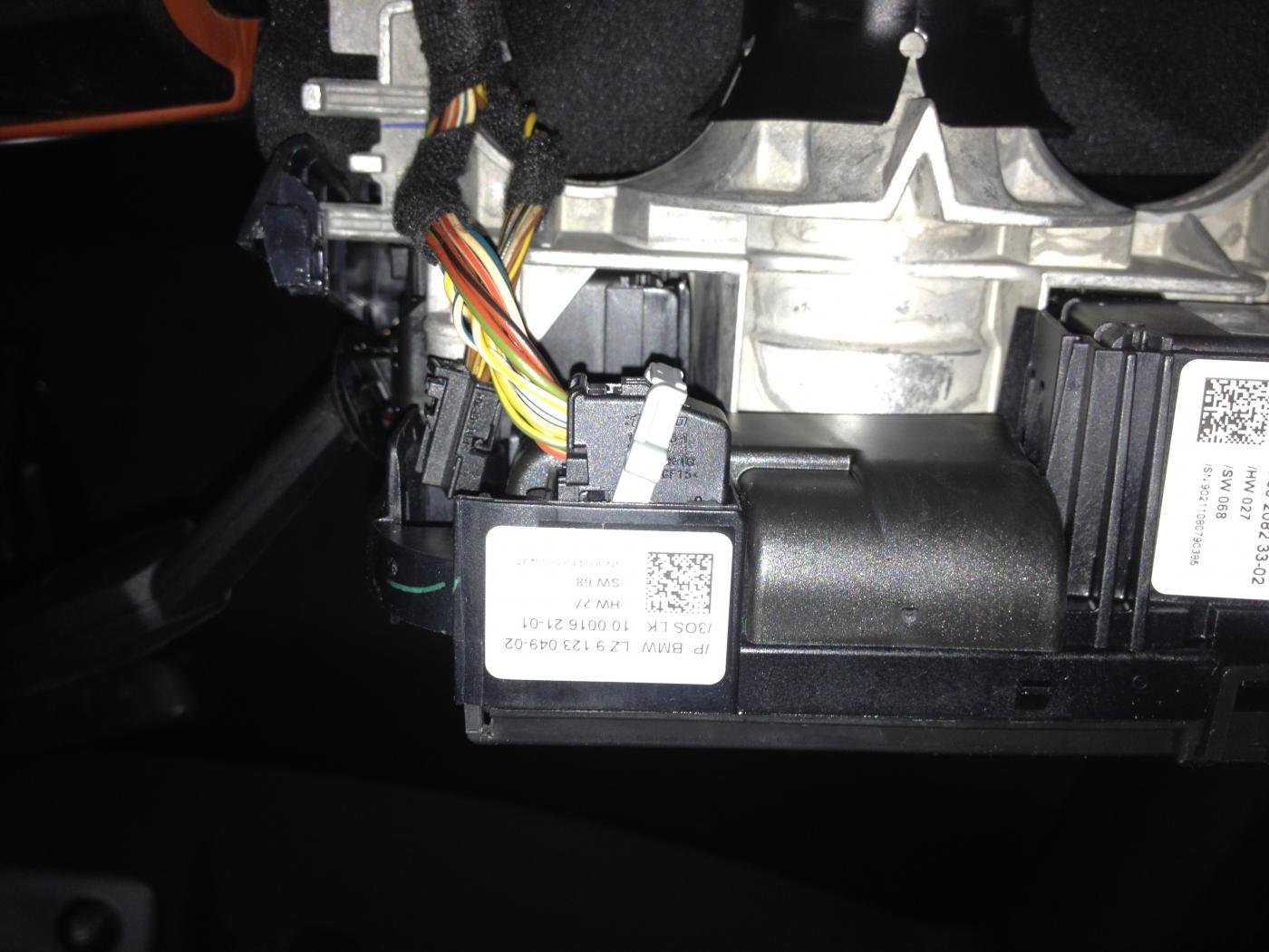

HOW-TO (HARDWARE INSTALL)
Please be warned that upon completion of these steps, you WILL have an error code! The system will warn you of a DSC error and calibration (as well as coding) by Mike Benvo will need to be done to remove the error and enable M-drive. The car is still fully driveable at this point, HOWEVER DSC will remain OFF until calibrated/coded! So no worries about doing this in advance, but don't drive like an idiot until Mike works his magic
99% of this process is simply following doba's performance steering wheel install DIY, which can be found here: http://www.m3post.com/forums/showthread.php?t=242963 If you are interested in changing wheels, this is the perfect time to do it.
Otherwise, we are not worried about all the electrical rewiring steps which makes this even easier.
1. Disconnect your battery.
2. Jump to Step 9 in doba's guide ("remove your airbag")
3. Continue following his steps THROUGH Step 14.
Now, the careful reader will notice doba's warning in bold: "Make sure not to pull the whole assembly out of the column. Very Important. Unclip all the clips and remove just the Coil spring cartridge and nothing else".
We are going to ignore that warning

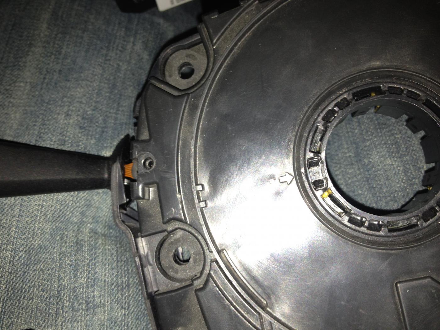

4. We have one more clip to undo (note: some things look like clip but do not need to be removed/cannot; if you cannot remove it easily, leave it and make sure it is required). On the bottom of the steering wheel switch column, near where you already undid the small black connector on the right side, you will see another black connector with a grey switch over it.
Rotate this grey switch off and you will be able to remove this connector (this is the easiest of them all to remove).
5. Remove the steering wheel switch column.
6. Replace it with your new M-drive enabled unit. Note that it has these two arrows on it that I believe are supposed to line up. I haven't tried NOT lining them up, but I assume it will screw with wheel calibration later. Maybe not, but do it to be safe.
7. Follow all the steps in reverse, making sure not to miss any connectors along the way! I found that putting the airbag back in was easiest by clipping in one side by pushing, and then using the screwdriver on the other side.
That's it!! Now you just need to call up Mike Benvo (hopefully you have already reserved his services prior to starting all of this... ), he will code/calibrate your car and you are ready to rock!

This is the part that is asinine as there is no reason to have more than TWO varieties (since I assume the rain sensor does require additional hardware). The pricing is identical across all four. You can see these here: http://bmwfans.info/parts/catalog/E9...eering_column/
So my car shipped with 61 31 9 123 049 -- no M-drive but with rain sensor. I swapped in 61 31 9 123 060 (M-drive with rain sensor), did the necessary coding (well Benvo did!), and voila!
I can't see why it wouldn't work on a non-iDrive BMW, with the caveat that you may likely need to pick hard-coded settings (that is, until someone donates an M3 GTS or a 2011.5+ model for Mike to play with). That is something that will need to work out with Mike, however, as the non-iDrive does make it more of a pain to double-check whether things are working, etc.
So tell us, how does it feel to have this functionality now that you have been so accustomed to driving an M3 without it for all these years? Do you now immediately hit the M Button when you get in the car (which I assume you have left set to MDM, Sport, Sport as show in the pic)? Do you find Servotronic Sport much more suited to the car? What about Sport+ "Power" have you tried it?
It feels like the car I always wanted it to be. I actually had pretty bad buyer's remorse for awhile solely due to this issue (I was not aware that iDrive with no M-drive was even an option... uneducated buyer ). The servotronic steering is kind of overrated. I went to the track yesterday and while it feels heavier, it mainly just made my wrists tired faster But I can see how it probably smooths out steering inputs so I will leave it.
I haven't even tried Sport+ as everyone seems to say it is too sensitive. Plus I am so used to regular Sport, that I don't really want to relearn throttle control (I leave it on Sport all the time as even going back and forth between Normal is annoying). It does seem like it would be easier to rev-match... but not sure if that is worth it being touchier. I'll have to experiment with it.
The MDM though is really the bread and butter and worth it alone. I got used to driving with DSC off on the track, but there are certain SoCal tracks that are not particularly safe IMO and having that extra insurance is nice. And on the street, DSC on is fine a lot of the time (i.e., sitting in rush hour traffic on the way to work), but there are times where you want to get on it a little bit and the complete power cut off DSC ruins the car (and I don't turn DSC off on the street).
And what about the button on the wheel? Have you considered or investigated getting one that says "M"? And were you able to choose which or the two "wildcard" buttons was to be transformed into the M Button?
The top button automatically becomes the M button and only the bottom one is a wildcard. I could get one that says M, but that really is the only difference... the label I need to replace my trim anyway at some point due to a cosmetic blemish, and if I do then I will look into it then. Otherwise I'll have M-drive sleeper mode
