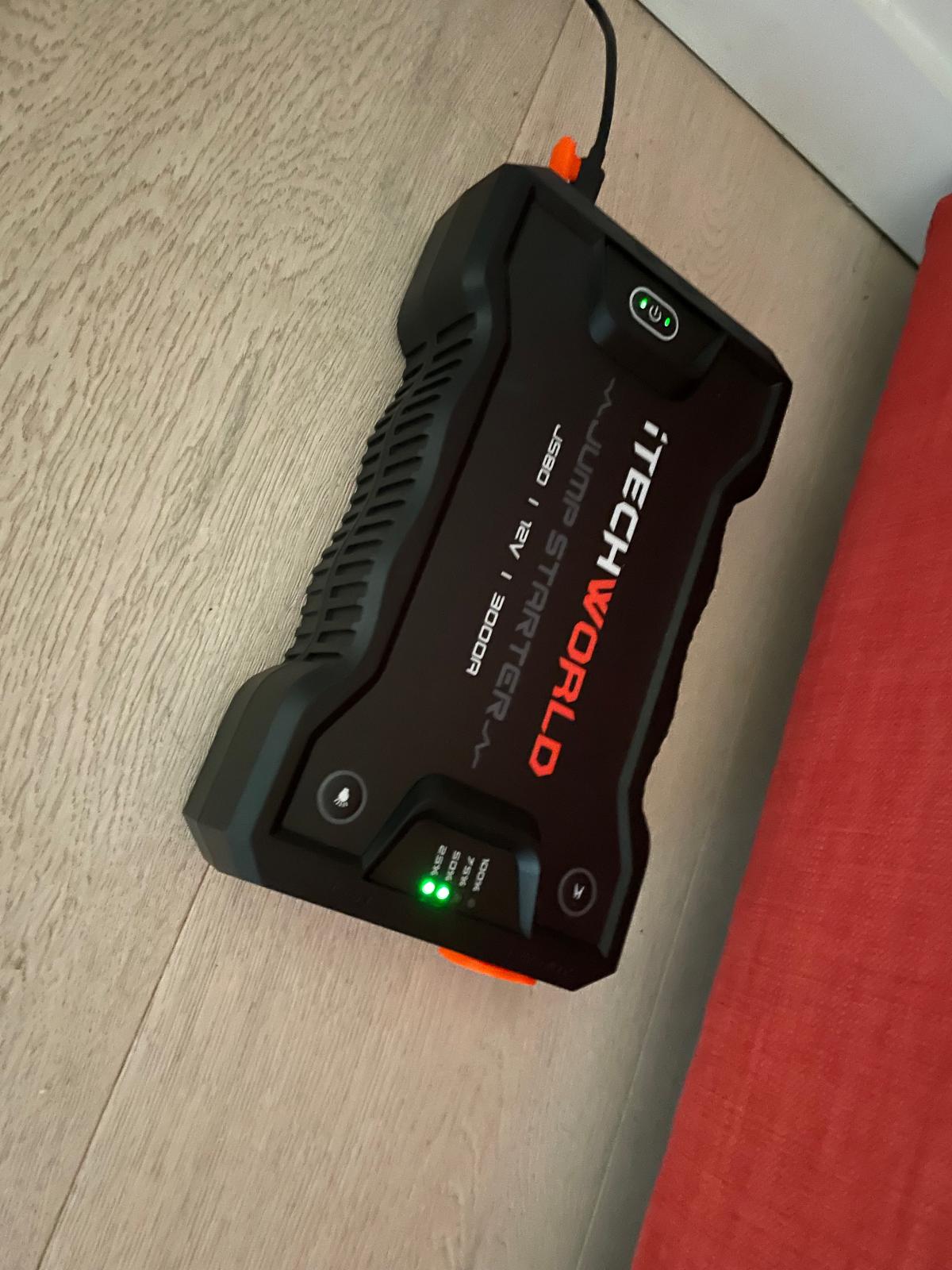

Hi I was away with work for 5 months and my E92 was dead as a door nail when I returned, not unexpected. I live in an apartment complex so a trickle charger is not an option unfortunately due to no power outlet in the parking bays in the complex.
It was that ‘dead’ that I had to use the manual key to open the door and the car wouldn’t even power up, even the interior light was very very dim.
However I did get one of the lithium battery jump packs and used that on the terminals under the bonnet (hood) and it fired up almost instantly. The battery is only 18 months old and is an AC Delco battery and seem to have recovered and the car starts and runs fine now.
I’m not sure if the jump pack I got is available in North America as I’m in Australia, but if so I can highly recommend the one in the photos. If not just get a decent one and biggest one you can afford.
Cheers
