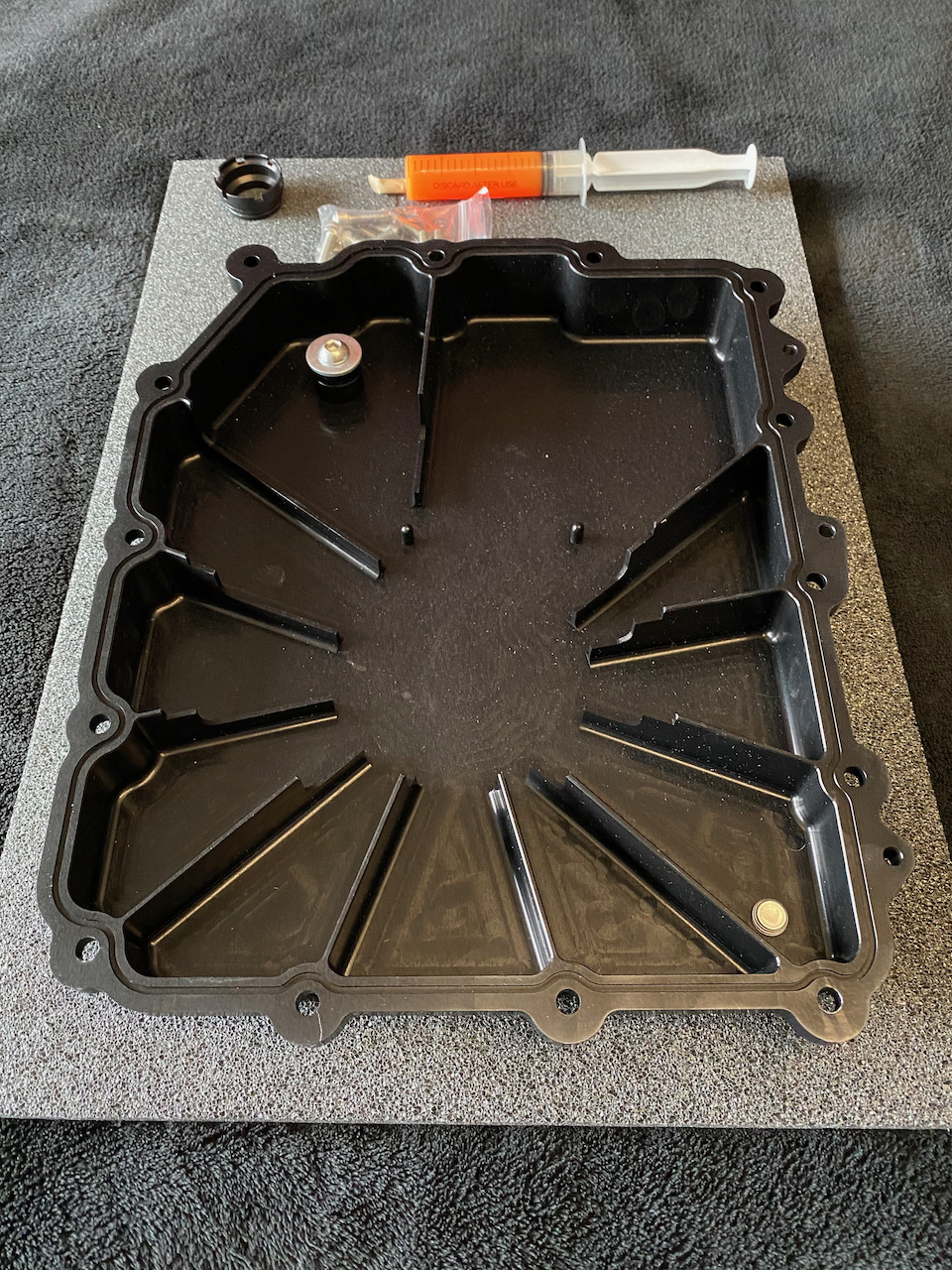

I just wanted to provide some info about the Fall-Line DCT pan that I just installed. When laying flat on the counter, the pan is 48mm tall in the front and 34mm in the rear. When installed, the bottom is level and sits just above the x-pipe tubes. Previously I was running a BMS pan that was 52mm front and back, which made the rear sit below the x-pipe when installed. In order to run the BMS pan, I cut out the center of the felt transmission undertray. The Fall-Line pan is now almost exactly flush with the opening in the undertray. You may be able to fit the undertray over the Fall-Line pan, but I suspect you would need to trim the front edge of the undertray which has a radius edge.
The Fall-Line pan is beautifully milled and the o-ring design allows the pan to sit flush against the transmission case. The BMS pan used the OEM gasket design, which in theory give a bit of cushion if the pan bottoms out but takes up a few millimeters of clearance.. Unfortunately i lost about 0.5L of capacity going to the Fall-Line pan, but we are moving to a new house where the neighborhood has rediculously high speed bumps. While I have never bottomed out on speed bumps with the BMS pan, I donÂ’t want to think about it ever time I pull into the new neighborhood.
I could not find where I packed the OEM pan, but I would estimate that the Fall-Line pan gives you an additional 0.5 to 0.7 liters of capacity over the OEM pan.

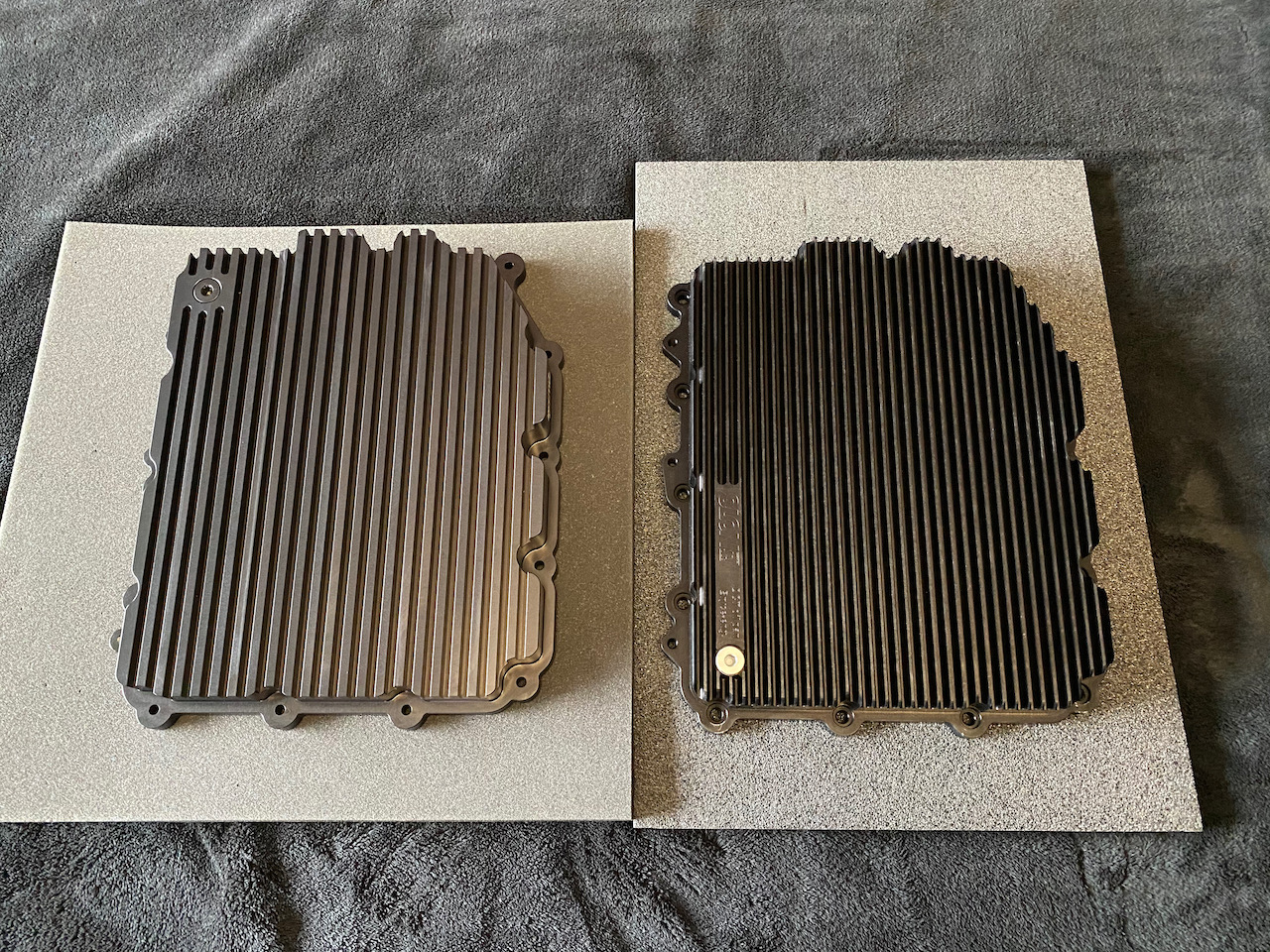

Here are some pics comparing the Slon vs Fall line.
I measured the Slon pan to be 3mm taller in the front and 2mm taller in the rear.
Both pans have the same interior depth front and rear.
