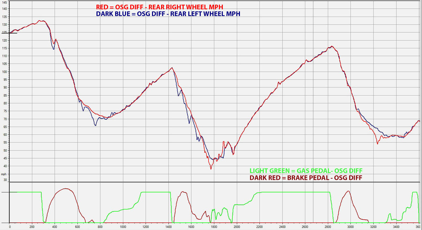

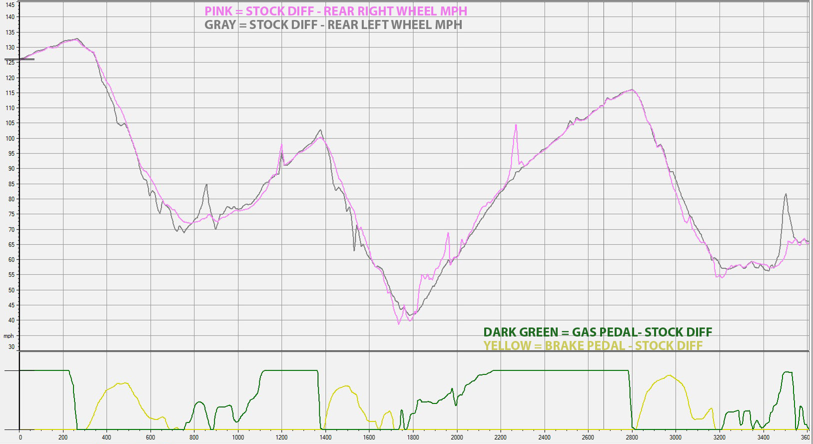

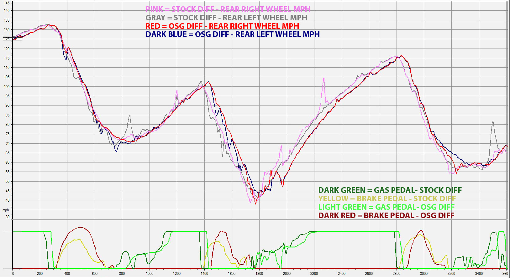

Originally Posted by dparm View Post
Are you looking at wheel speeds to determine this? I assume some sort of math channel could be built to determine how much locking is taking place.
On the E9x M3, an AIM Solo DL that's tied into the CAN bus is able to log the mph spinning speeds of all four wheels independently. So, yes, I'm just overlaying the rear left and rear right wheels on top of each other on a chart to compare the spin rates. There's no fancy calculations.
Here are a few examples of what I posted in the diff write up on my build thread. I posted AIM charts of two laps of almost identical lap times. I'm not going to delve into them here since I did that on the build thread. But it doesn't take much analysis to see how much the stock diff spins up the inside wheel before it locks versus the OSG Superlock locking quite quickly-----just look for the spikes in speed that appear on the stock diff chart lines.
