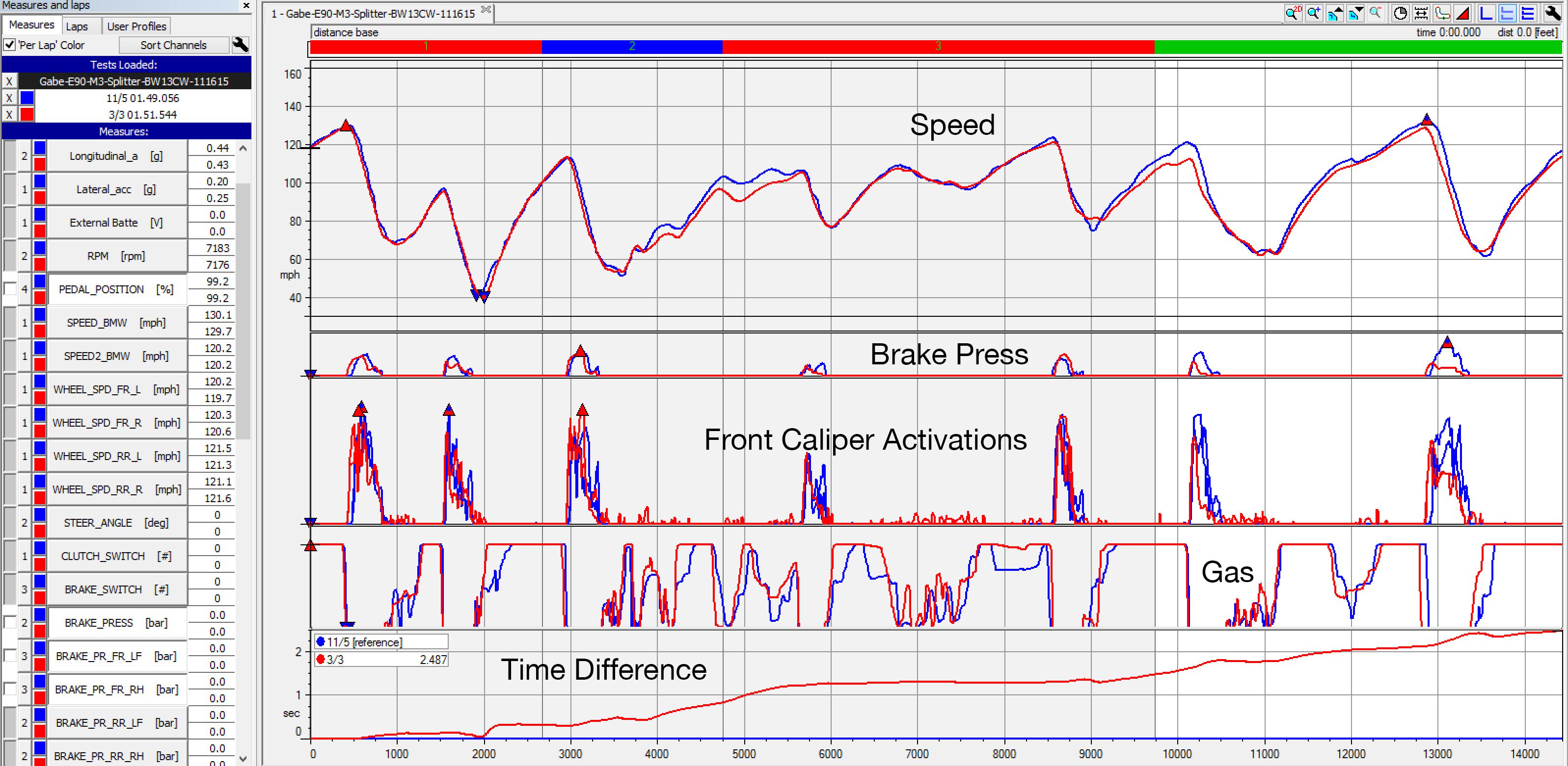

I used Euro MDM on track for 4 years until the end of 2015. I drove every track in California with it. And I watched its behavior with an AIM Solo DL. I think it's fair to say I know it's characteristics.
When you push hard on track with the E9x M3's traction control system. The two main tools it uses are:
-dabbing a single front brake caliper to prevent oversteer in sweeper/rounder parts of the track.
-holding back power if you mash the gas too soon on corner exit. And then allowing the power to be applied by the engine smoothly and gradually when the car decides it's safe to do so after the corner. (This second tool is sneaky and it's harder to know when it's happening. You only really realize what it was doing when you turn off DSC and then experience the full rush of power when you press the gas and then finally understand that DSC was holding the power back. You just hope that you don't spin as you are realizing it......)
The yellow DSC logo on the dash doesn't always flash while DSC is doing it's thing.
While traction control usually works in the background and does small things to try to prevent crazy situations, we have seen videos of it pulling people out of tank-slapper situations that most people would not be able to overcome. (This can occur if you dropped two wheels off-track and then try to save it. The car hooks as it comes back on track and things get ugly really quick. We've seen DSC save that. Amazing.) Being able to grab individual brake calipers is a powerful tool. The system may have been developed over a decade ago, but that doesn't mean it's crap. I think it's main limitation is that you can't specifically program or tune it to act how you want it to act. (A Motec ECU has like 10 levels of traction control that can be fully tuned to do whatever the heck you want it to do.)
If a person wants to drive with DSC off, I highly recommend they spend time on a skid pad sliding a car around and learning how to effectively countersteer. Most of traction control's intrusions are done to keep the rear of the car in the rear. Traction control doesn't necessarily keep the car on track. It doesn't know where the track is. It's trying to stop you from spinning. So, learning the basics of countersteering-a-slide is the first step to driving without traction control. The second thing you can learn on the skid pad is how to apply the gas pedal. By purposefully applying too much gas, you can start to understand what the car feels like as the rear is breaking loose. Understanding that feeling is important. Different tires offer different traction. Different turns offer different amounts of grip. You need to learn what it feels like as the tires are losing grip so that you can adapt to the situation in each turn with whatever tire may be on the car. It is best to learn these lessons in a low risk environment like a skid pad where it's safe because experiencing them on a race track at full speed for the first time has way more risk. And a race track has so many other variables going on with other cars around and various track conditions, that you may not be able to concentrate on the nuts-and-bolts skill building while the car is sliding. You're too busy freaking out because there are other cars and walls around. Plus, most event organizers these days don't allow drifting. If they see a dude hanging the ass of his car out there repeatedly, he's getting called in.
An autocross course can also build good skill. But I would still HIGHLY recommend a skid pad where you can just go crazy hanging the ass of the car out there over and over and over. (Doing a wet skid pad is fine, but for learning purposes, I prefer dry pavement because that teaches you more what a regular dry track will feel like.) There is no substitute for understanding that feeling as the ass is about to start to step out, countersteering it, and then learning how to apply the gas pedal to keep the car going. As you do it more and more, you start to develop a Spider-Man sense for when it's about to happen. Porsche drivers who drive without traction control have an advanced Spidey-sense for when that tail is about to step out.
The other lesson you need to learn as time goes on is that countersteering has to be appropriate to each situation and to the speed you are going. Countersteering is not just a generic response. A skid pad countersteer at slow speed requires one amount of input. But a 90mph countersteer requires a different (less) amount of input. You have to feel your way through it. I bring this up because I watched a video recently of a driver who spun in a high speed left-hand turn and couldn't figure out why. My conclusion is that the rear stepped out just a little bit in the high speed turn (not even noticeable on the video). But he countered with a huge countersteer---like more than a full turn of the steering wheel. It was such a large countersteer, that the front tires grabbed and the nose of the car was moved noticeably to the right, and the car immediately came around to the left.......he spun instantly into the rocky dirt......In a high speed situation like that, you want smaller movements to keep the rear in the rear. At slower speeds, you may need to countersteer more. But again, you have to feel these things out. I think a racetrack is the last place you want to be feeling these things for the first time. It's the highest risk place to be experiencing it. What you want is a low risk place to do it for the first time.
I had an experience at Buttonwillow a few months ago that's related to this. I have a supercharged E90, so the car has a lot of power. Exiting the Esses at Buttonwillow at full throttle in a supercharged E90 is challenging, but it is possible. But you can't do it all the time. The condition of the tires affects whether you can stay full throttle. So you have to feel it out based on the condition of the tires. On this day, my Spidey sense was telling me that with the scrubs on the car, I could not stay full throttle on the exit of the Esses. But I wondered if I was really sensing the situation correctly. So, I pushed harder on a subsequent lap and the tail got a tad loose at 120+mph on the exit of the Esses. The tires weren't good for it. My Spidey senses were correctly interpreting the situation, but I was doubting them. From that experience, I am even more willing to listen to my Spidey senses now. At that speed, it was a small amount of inputs that brought the tail back. If I had gone wild with some freak out countersteer, the situation would have resulted in some kind of spin.
The last thing I will recommend is that, if you have been driving with MDM on track for awhile and you want to drive DSC-off, back the speed off a bit, and then slowly work back to your full pace. There will be some "ah ha" moments where you feel the throttle come on immediately that will surprise you. At a slower pace, you can deal with that.

This MDM discussion is good. I'll admit I've been driving with euro MDM on, winning some HPDE trophies (really low-level TT stuff) and running in advance groups keeping my shit together.
I've had friends ride along and get the "why don't you turn it fully off? you're reacting correctly when things go sideways and it's slowing you down" and may make the leap soon. Will step down run groups to something like a high-intermediate (fast advance > slow advance > high int > low int > novice) so I can dial things down to a few notches in pace and get comfortable. I think I've hit a wall in driver development with euro MDM.

Were talking 10+ year old DSC technology here, it really isn't that good.
I have to disagree here. It is not some rudimentary first-generation traction control system from the 1990s, but there are definitely newer/more sophisticated setups.
MDM is quite effective at keeping the car under control and can of course do things a person cannot, like braking an individual wheel and detecting/responding to wheel slip in a fraction of a second. There's a reason a lot of racing series have banned or heavily restricted these systems: they give an advantage. Hell, even the auto magazines talk about how some of their fastest lap times are actually set with these things turned on.
If you guys are faster with it off, more power to you. There is no shame in letting the computer help you out. I'm not out to impress anyone or set track records, I just want to have fun in a safe way. But let's not overgeneralize about "LOL nannies".
Quick read for anyone who thinks these "old" systems just slow you down (note the year and who is driving)...

Interesting, however... He's fastest in mode 4, which fully disables yaw control. This is purely traction control modulating power through the rear wheels. He was slower in every mode where the car is controlling slip angle. The fact he's faster with TC and torque reduction when were talking about 600lb/ft of torque and 600hp going through the rear wheels isn't exactly surprising. This is effectively the same as pressing the ESC off button in a Pcar.

Interesting timing on this discussion. I'm finally at the point where I'm comfortable with my input smoothness and ability to safely react to loss of traction that I'm going to start driving with DSC off. With the normal MDM, it was fairly evident fairly early that it was getting in the way - I think the sensors especially didn't like how the car reacted with KW clubsports. I have been enjoying Euro MDM for a while now. The biggest difference is how it does not intervene over uneven terrain. And you can get the rear end out quite a bit with it still on. But it wasn't until recently that I was finally able to notice the small interventions in corners where I'm really starting to try and push the limit. Obviously like others have said, I'm not going to jump right into the same level of pushing the first time I turn it off, but I'm curious to see how it will (hopefully) let me push past my current limits. I feel like my driving ability has really started to improve but my lap times are only improving at a sluggish rate. Not that lap times are king, but it's my main metric since I don't have data logging.
Sounds like we need to organize a group buy for https://store.m-world.us/products/ai...=3738872676392

American apples to German oranges. 2012 Corvette vs 2008 BMW systems. And the sample size is one corner. Will modern traction control help even pro drivers go faster? Yes. Will they hamper your driver development? Also yes.
Maybe, but the C6 was in production since 2004. PTM did get some revisions over time but it's not like that system is drastically newer than an E92. This is at least something objective. So far all we have in this discussion is a bunch of people providing subjective opinions on said technology.
Does anyone here have lap times of the same M3, on the same day, with the same driver using [Euro] MDM vs DSC off? What is the time differential? Also, I think a mostly stock car on a street tire is probably the most reasonable approach since that's what the DSC system was designed around. There is a valid argument that the system's utility decreases on a heavily modified car.
Again...show me the data. The more of it we have, the better. I'm more than willing to admit when I'm wrong.

Does anybody know the exact inputs (e.g. Yaw rate/accel/jerk, roll rate/accel/jerk, pitch rate/accel/jerk, etc.) and their associated response functions? Intuitively, it would seem that mods which could control body rotation around the x, y, and z axes (accel/jerk particularly since they may provide some foresight to the future state of the vehicle's orientation) better than stock may actually reduce intervention.

As I said before, I ran for 4 years with Euro MDM on. I even went one step beyond Euro MDM and altered the WERT setting to allow even MORE slip angle. I pushed the boundaries of MDM as faaaaaar as I could.
In November 2015, I went to Buttonwillow 13CW (technical 2.7 miles long course---not a high speed course) on a semi-exclusive day. I was there all by myself. The weather was ideal conditions---started at 52ºF and the high was 58ºF. This visit was to test out the ultimate setup on the car up to that point---fully gutted and caged, full aero, brand new BFG R1S. I was there to go for it.
I started the day with MDM on as I always did when I wanted to go for it. The fastest lap I ran with MDM on that day was 1:51.5. That was a new personal best for me. But MDM was intruding EVERYWHERE. You could feel it grabbing brakes in rounders to prevent any chance of a spin. You could tell the power of the engine was being held back when you pressed the gas. I pushing like hell, and the car was pushing back. After a few sessions of MDM on, I decided I could not go any faster. I had been driving Buttonwillow for years. I knew the track very well, and I was pushing the car everywhere. I am comfortable telling you that 1:51.5 was the fastest I could ever go with MDM on fresh R1S----ideal weather, open track, etc.
So, I took a break and decided that I had reached the limit of MDM. I let the car rest a bit. I decided that this was the day I would turn MDM off and "go for it" with DSC off. (Remember, this was not my first time with DSC off. As I mentioned before, I had practiced on the skid pad and I had spent about 25% of my time driving on track with it off for about a year. But I just had never gone at maximum pace with DSC off.)
I got back out there and started turning laps with DSC off. I immediately matched the 1:51.5. By the end of the day (9th session on the tires), I had run a 1:49.0 with DSC off. Same tires, same day, same open track. So, the tires were a bit older and I still ran 2.5 seconds faster with DSC off versus Euro MDM.
It was just a simple function of being able to get on the gas earlier, and the brakes not impeding my progress on rounders.
Since 2015, I have run even faster tires like new Pirelli DH. I have continued to reduce my lap time at Buttonwillow 13CW to 1:47.2. I would bet the car would not get much faster than a 1:51 with MDM on, even with slicks. It would reduce your pace on rounders and you'd still be waiting around for the power to be available on corner exit. The slicks would be wasted in terms of going maximum pace.
Here is an AIM chart comparing the two laps. Red lap MDM on. Blue lap DSC off. I don't have time to analyze the whole chart right now, but I wanted to put it out there so you could check it out. (I'm on vacation. Need to run out right now.) Anyway, there is a LOT of information to see in this chart. A couple quick things. Look how much the calipers activate with MDM on when I'm not pressing the brake pedal. Look how much higher the speeds get in the second half of the track with DSC off. Take a look at the chart and let's see what kind of conclusions people can draw from it. I'll try to check back in later tonight and go through some conclusions. Hey---I just gave everyone homework!

I'm not here to prove you wrong or right, but you asked a question, and I do have what I think is a legitimate and solid answer----probably the most solid answer you could get on this topic.
This is good stuff, man. Thanks for sharing!
What jumps out the most in those graphs is how your gas pedal application was much more "binary" when MDM was on. Not sure if that was intentional or not, but the blue lines have a less-steep slope. You're actually at full throttle much sooner with MDM on, though. Could be down to driver confidence? Would be curious to hear your subjective thoughts.
Does AIM let you graph the DSC or TCS activation? In Pi Toolbox, there is a way to do it because the ECU sends a signal when it is actively intervening. Unsure if BMW ECU does it.
