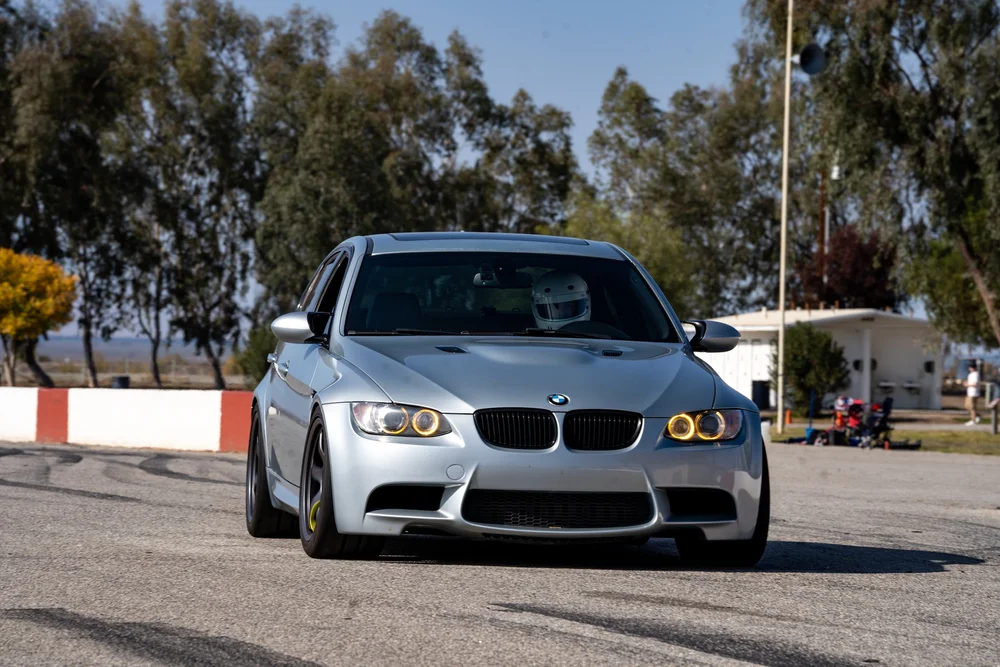

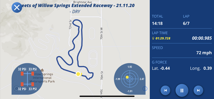

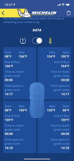

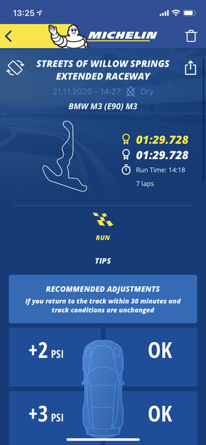

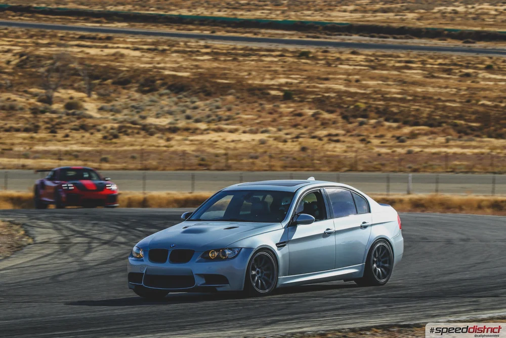

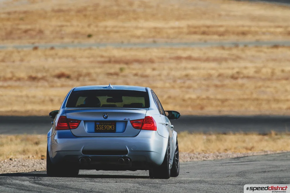

Finally finding some track time as the weekends get a little less busy, or as I merely put off projects. The car is fairly well sorted with some recent updates to the suspension and tires. Bimmerworld lower control arm and trailing arm sphericals installed. Updated front and rear Swift springs for slightly stiffer rates at 10kgf/16kgf. Car has been re-aligned, balanced. Michelin Sport Cup 2 (240) Connected tires were fitted to the Titan7 T-R10 wheels along with the little temp/pressure sensors. I have the Motion Control 2way shocks set up nicely as well.
These Michelins are interesting in that they are a Sport Cup 2 tire but in 240 tread wear. The tires are quite soft still, similar to a regular Sport Cup 2. Hoping for some longevity out of these, as I get some new wheels sorted for track use. The Michelins are also the new “Connected Tire” which means they have a small pocket on the inside for a sensor that measures pressure and temp. The sensor comes with a separate 500$ package that is 4 sensors, receiver and a phone mount. The idea is that the sensors are paired to the Michelin Track Connect mobile app, giving you real time temp and pressure data. The data is collected while you are on track with real-time feedback as to state of tires relative to their sweet spot. The app is much like a lap timer, giving you lap times (GPS based) and a course map review of what your tires did and where. Its interesting seeing the temps go up as you run the session. The lap timer is nice but more importantly - you just get a quick readout for temps and pressures.
One of the track events was the Shift-Sector half mile event. This is not the car for it but still fun to stretch it out some. With poor start traction and relatively low effort on my part it ran 135mph or so in the half. To put things into perspective, the McLaren 675LT we bought out ran 187mph at 1000whp and our Porsche GT2 flagship runs 205-208mph consistently at just over 1400whp (6speed to boot)
Two weekends ago got to Streets of Willow at Willow Springs Raceway with SpeedDistrict and the shop, which was sort of the first time the car was set up right. Good tires, shocks tuned with the stiffer springs and etc. This was my first time being at Streets and was a great time learning the track and getting a handle on it. Managed to just dip into 1.29s - lots of work left. It was quite cool and the track took a bit to warm up - this is where that Michelin app came in handy - you could see how the tires were taking a bit to get up to temp. Looking forward to the coming weekend at Big Willow and more California track (I’ve been in SoCal 3 years and its time to get out and drive)
The Brembo GT-S holding up great, though Im nearing the end of the Ts-20 pads. Shocks are always there and the car just deliveres. 167k Miles and counting!
Overall the car handles great. I need to look at mitigating body roll somewhat and setting up with a track-only set of wheels and tires so I dont kill the street tires. Keep tuning the dampers and just get more seat time. Really want a set of seats and harnesses, but maybe just harnesses. Getting flung about is tiring.
Images by CaliPhotoVideo for SpeedDistrict

Good update! What tire size are you running?

Tires are 265/35 and 295/30

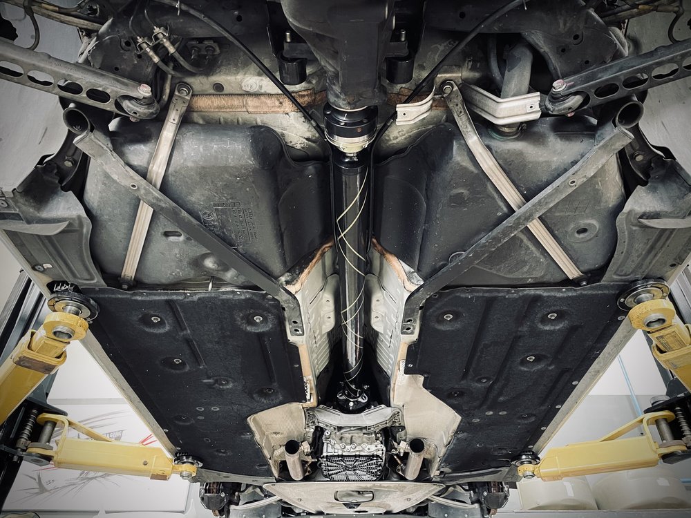

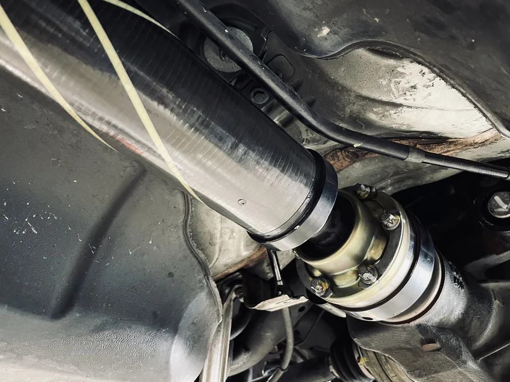

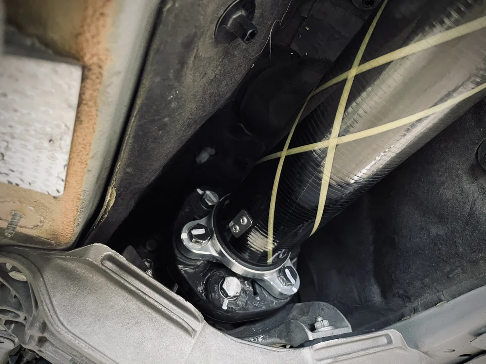

Mfactory CF Driveshaft fitted finally.
Easyish install and the result is great. More direct, no slop. Dont think was needed but got a new guibo installed as well.
Its lighter so less rotating mass and less work for the engine.
The engine bay got a quick degrease. Got a quick snap of it being lit up by the LED work light in the lot.
What's your opinion on it's value: must have or nice to have?
I did it as the Oe driveshaft was making noise.
I figured I’d be part of the way there with trying to service it
With the same issues coming up later.
With the build MO in part is to simplify so the new driveshaft did that too.
Weighing the option- seemed like a reasonable thing to do.
The end result is worth it iMho. There is a reason the f80s came with CF units as well. I’m just infusing later gen tech into earlier cars.

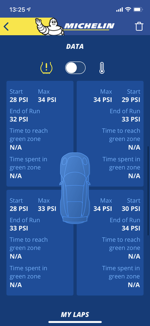

The Cup2 Connect stuff...is it just recommending pressure changes? Nothing about camber?
Steve::::2012 AW E92::::IG - @sjs0433
      01-13-2021, 09:21 AM   #121
dmitriyo
overnight engineer
250
179
Drives: 2010 E90 M3
Join Date: Jan 2011
Location: LA
No alignment settings.
That you can look at tire wear and gauge.

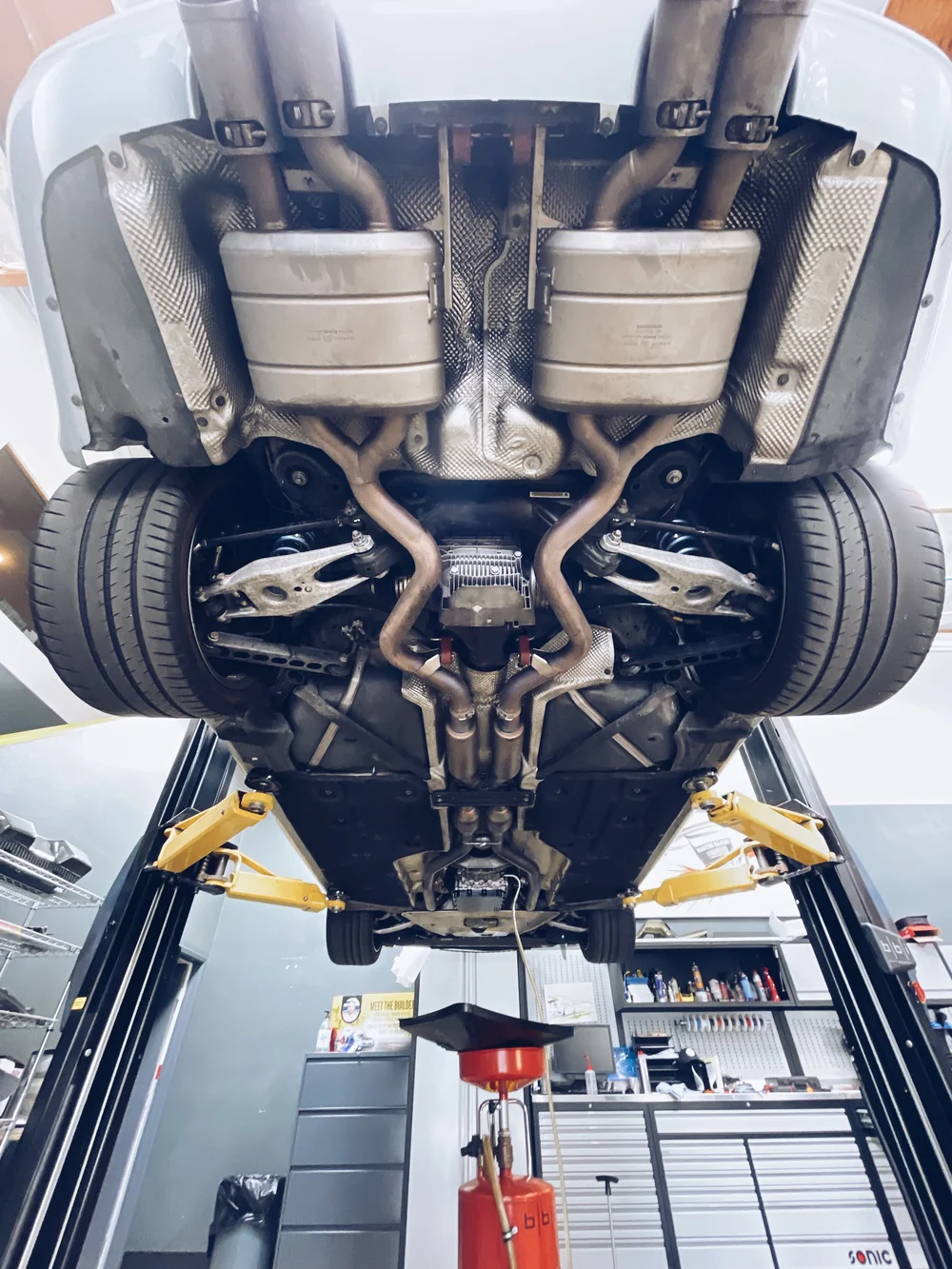

A few updates since last post.
Finally picked up an Akrapovic system, coupe version! It does fit and does so nicely without modification. Just a tad of tension on the middle hangers but great fitment otherwise.

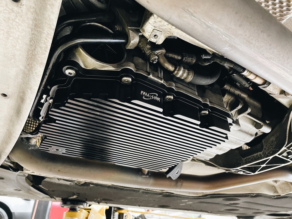

DCT pan started leaking again some 40k miles since last service. Seems on par for the OEM part. Came across the Fall-Line Motorsport pan via IND and picked that up. Billet, strong and with more volume. More importantly, the viton o-ring is great. Should be a lasting seal.
Interestingly, the Motul DCTF that was drained out looked great. I did change filters and refilled with fresh Motul DCTF. Some Adaptation and clutch relearn afterwards and it shifts great.

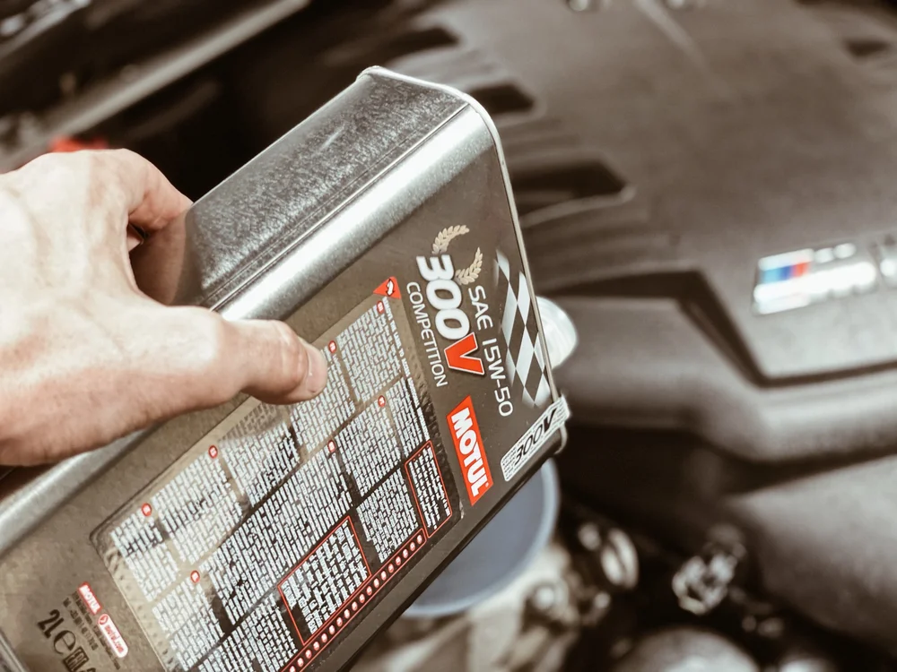

Moul 300V engine oil change as well. 165k and running strong, track days and all.

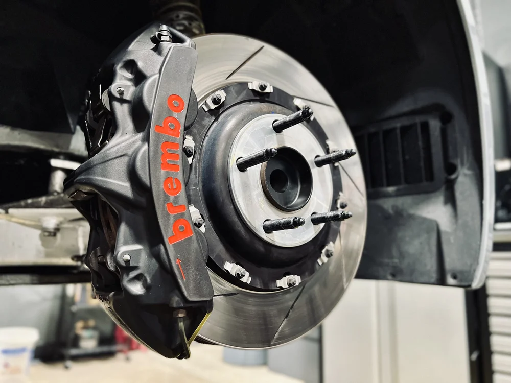

The Brembo GT-S System was put on about 80k ago and I've only serviced the fluid. Front pads are almost done, rear still have 50% life and rotors are pretty good too. Its been flawless with no issues though track days, canyon runs, daily driving and rallies.

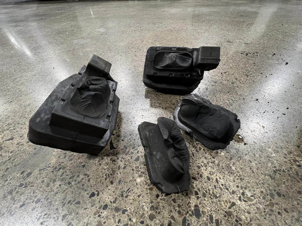

Fun experience on this rally is there was a street with unmarked and rather agressive speed bumps. I hopped one, slamming the underside of the car on to it. After the slam - felt as if my engine was hard mounted!
Upon inspection - turns out that the Fall-Line DCT pan took the hit phenomenally. The force of the hit was such that my trans mounts were ripped clean apart. Aside from scuffs and the oilpan is perfectly in tact and really saved the driveline. Would've been rather ugly to be stranded there.
Brembo GT-S System, now with new Motorsport Hardware stud kit

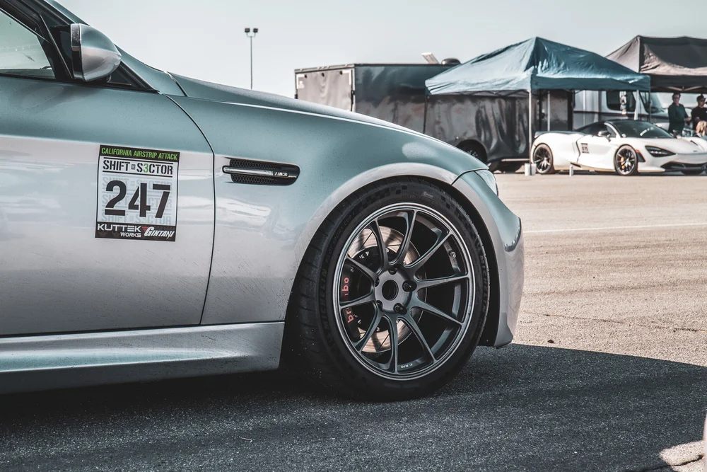

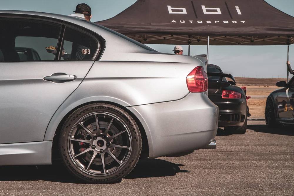

I continue to hammer the car at track days. Weather now is great in the LA area.
Im still learning it and pushing it, but it continues to prove to be a phenomenal machine. A sedan that packs a bunch of stuff and that goes round and round on track - cant beat that.
Running the RT660 Tires currently and they perform well. Feel like they have a lot of grip and dont get squishy too fast.

With some more miles on the CFDS, what are your ongoing thoughts with it? Any downsides, NVH, etc.?
slcook541870.50
      11-25-2021, 11:50 PM   #129
dmitriyo
overnight engineer
250
179
Drives: 2010 E90 M3
Join Date: Jan 2011
Location: LA
Great stuff as always!
Its been great. No issues! Nothing out of the ordinary.
