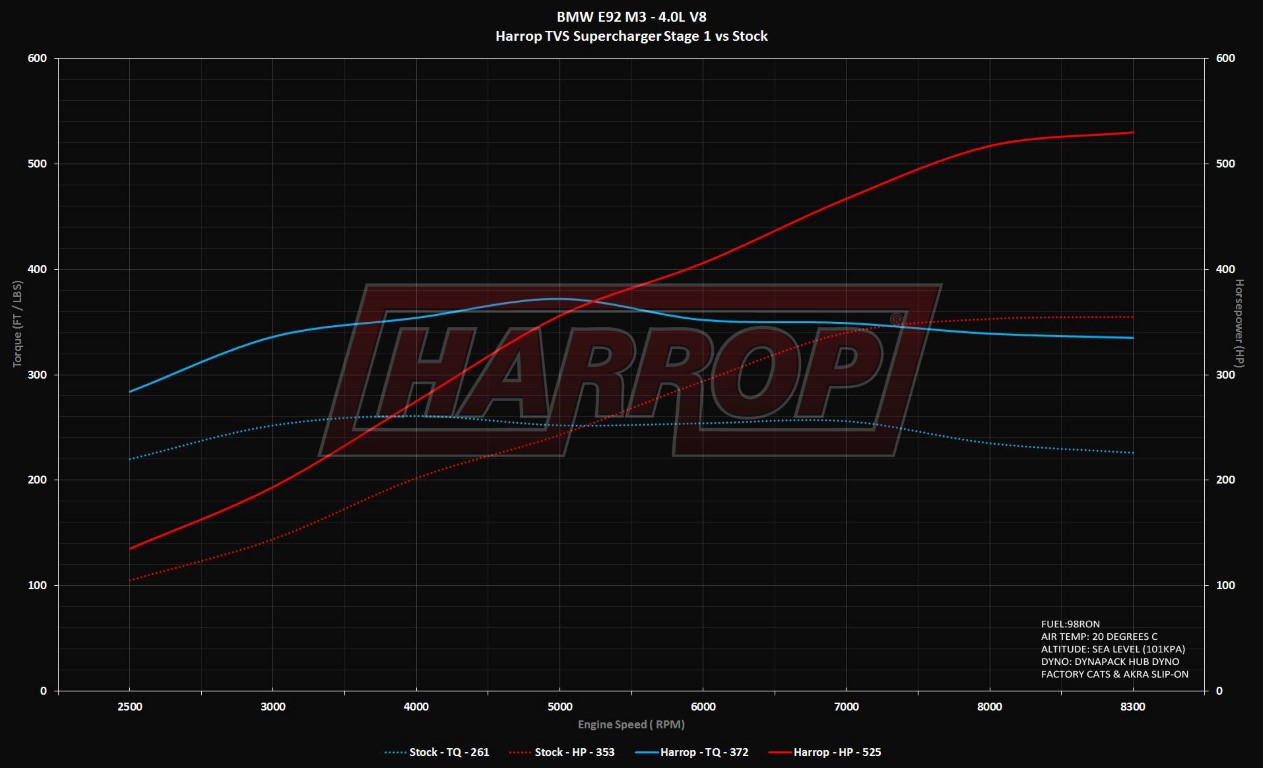

Official Stage I Dyno Chart has been released:
We've had a lot of inquiries about Stage II and will be sure to update this thread with any developments. There is no estimated release date as of yet.

Damn that area under the curve... This kit is beast.

530-ish RWHP isn't bad for stage 1.
Any plans for a TVS2300 or maybe a whipple 4.0L ?

That is not on a dyno jet in sae. One dyno jet dyno in sae was posted and showed around 500 rwhp if I remember correctly. The big advantage is the low end -- it did 300 lbs rwtq at 2500 rpm. That is impressive on one of these motors.
