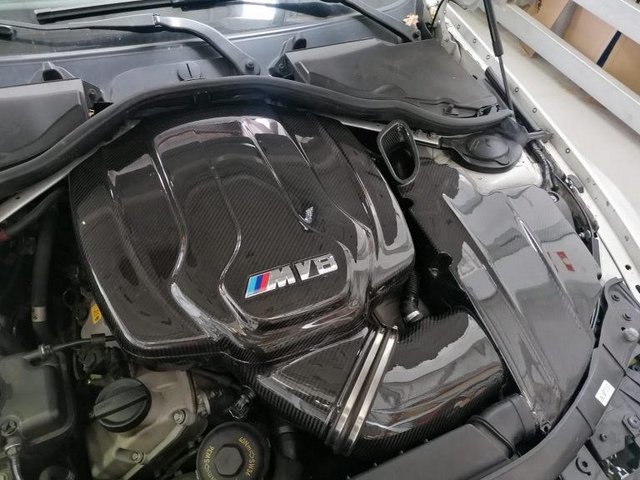

I just purchased and installed a full Karbonius setup (pic below) from an honorable member of this fine forum. I'm running MPE and stock mid pipe and am blown away. Sounds incredible at all rpm ranges. The install however wasn't totally trouble free. I completely agree with the OP's description of fitment of the airbox lid and his description of the issue was spot on. I have the same issue. I do however have two other issues.
The first is I'm getting a CEL and not sure why given I'm very sure all connections were and are solid. Maybe it's a coincidence and an O2 sensor has gone bad somewhere?
Second thing isn't really an issue but an observation. I took the car out today and did a very aggressive run. Lots of WOT and redline pulls because that's where the setup screams as we all know. I observed something that I can describe as a skittering sound coming from the plenum, my windows were up. Essentially wide open in first to redline, then same thing in second. The skittering sound occurred mainly during second gear pulls to redline and began at 6k and on. The best way to describe it is how your car skitters as it seeks traction and TC is intervening. And although that was also happening I don't think that's the issue. I tried many pulls at 3/4 throttle too to try to prevent TC from kicking in and the noise didn't go away. Maybe something is loose with my install? Or maybe this is just inherent in the Karbonius? It's dated from 2019 fyi. Any insights are appreciated.
What's your error code?
It says the dreaded increased emissions

Update: I took everything apart and started again. The install was fine except the worm clamps were not tightened enough and gases were escaping. Problem solved and CEL gone. The stuttering sound between 6k and redline when hard on the the throttle remains however. I'm thinking it's the nature of the Karbonius and the resonance it produces. This may simply be the cost of using after market products, there's always unknowns. Sure wish there were OEM CF pieces like this because the fitment of that airbox lid is very sketchy. Anyway the car still sounds epic and I think I can live with that slightly odd sound. If I can set up my iPhone I will try to take some video. Can't be heard with windows down only windows up.

The fluttering you're referring is mentioned in the video below (play at 7:23). Sound waves are produced by vibration, more vibration = more volume. Factory plenums are rigid, means no vibration = no sound. More vibration can be achieved by lighter layer of CF. The side effects, however, is flutters at high RPM and between shifts which disrupts airflow. Haimus might be the stiffest of all of them, but offers almost no sound benefits but claim HP gains. Eventuri is very stiff as well, best of both worlds in stiffness and sound, no gains. I haven't personally handled the version that you have.
