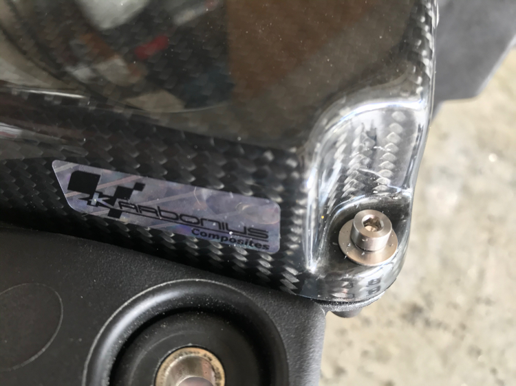

I finally did this and it worked well. My inserts are a little delicate, but they seem more durable than the plastic threads and oem screws. I used titanium hardware for extra bling and lightness.

That looks great! I recently changed air filters and my threads are still holding tight.

thanks! when i was testing the first one, i had the anchor back out once i got it pretty tight. now they are just snug but pretty secure.

i've had my airbox out probably about ten times for various tasks since i did this. i just started to have some minor issues. one of the anchors broke and fell out, and i have another one that is coming loose during fastening and the bolt is pulling it up out of the seat before it gets tight. i just have to press downward as i'm tightening it to encourage the anchor to bite.
other than that, the lower airbox is holding up well.
