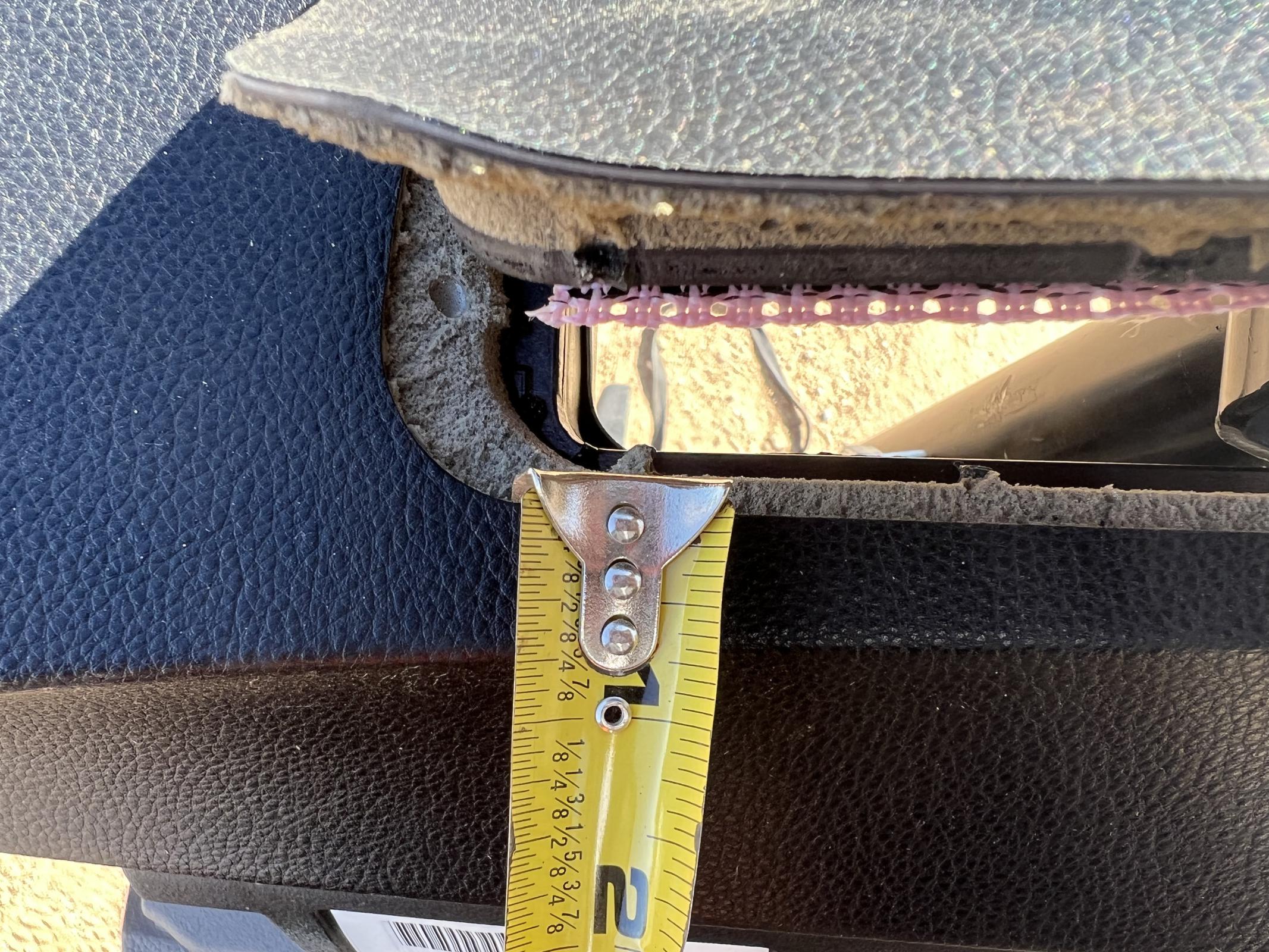

I have an E90 dash with a deployed passenger airbag.
I will try to get some photos and measurements for the thread.

      02-22-2023, 11:06 AM   #10
Serf27
Serf27's Avatar
2091
3,693
Drives: E90 335i
Join Date: Apr 2018
Location: Sitting in a BMW.
Photos and measurements of a few areas.
This dash had idrive. It should be the same location as non idrive.
chocstraw395.00
