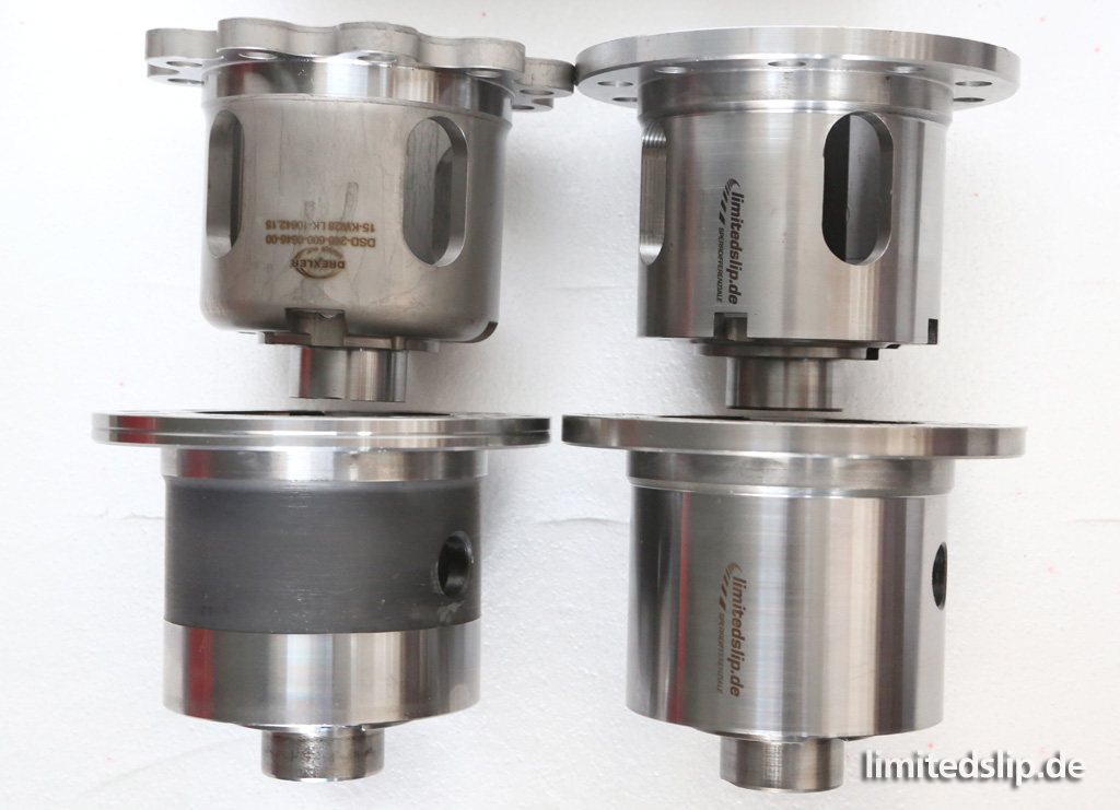

as i get more and more questions concerning the difference between "my" lsd core and a drexler core i took some pictures and try to explain here...
the lower left is an old ZF OE lsd core.
the lower right is a modified ZF unit to fit E92/E46/E60 M applications.
the top right one is a heavily modified unit with improved oilflow, lightweight and more space inside the casing for additional clutches.
the top left one is a drexler bmw motorsports case.

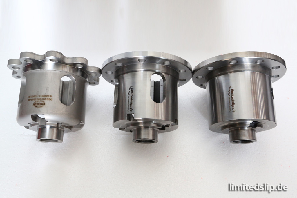

here are the three e92 units in detail again:
concerning performance it always only depends on the setup. with the modified units you can improve/upgrade the old zf cores to fit even racing needs. i can put any setup you want in any case you prefer. the internals of all four units are compatible and can be exchanged.
i think i wrote it already somewhere: the performance depends on the setup, not on the core used!
some setups can only be built with the two upper units as they offer more inside space/depth.
but the best value for money is the bottom right unit which can still host a very good racing setup that fits all traction needs while still reacting smooth and predictable... and will last one or even more seasons of racing. for non-competition environments it will even last several years before a rebuild is required. i would say this unit can last over 50k miles without feeling a letdown of performance. and it will still lock quite ok beyond that mileage.
so i hope i could clarify this a little...

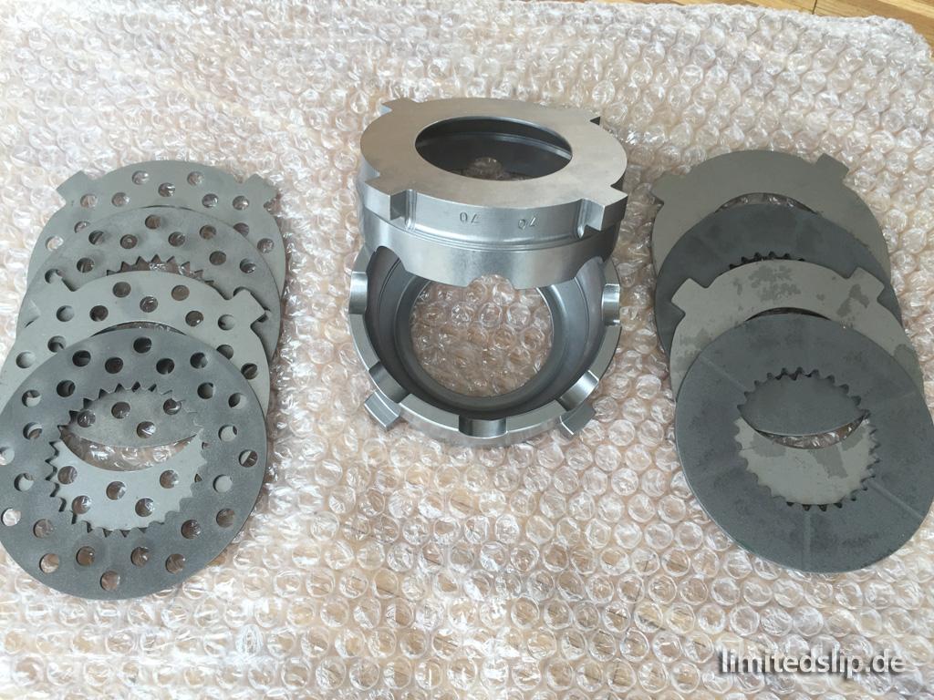

here is a picture of these items.
on the left side you see two drilled (highend) clutchpacks, on the right side two grooved ones (the zf oe clutches had no holes or grooves at all, i don't use them).
in the middle is a 70/70° rampset which would lead to ~40% lockup combined with 8 clutchpacks. a pretty perfect street unit with hardly any downsides at all (except price).
although for a "fun/sideways" setup like you are aiming for i would go a little more shallow to have a higher lockup.
DrFerry10035.50
