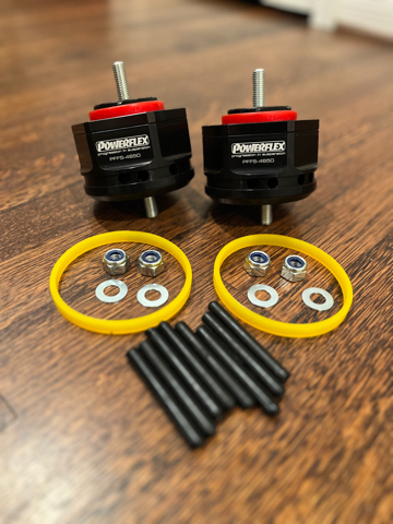

These mounts look great, and even came with new nuts and washers, problem though in that I can't get the black rods to go into the holes. May call Powerflex today to see if they have any tips for doing that, a little disappointed it's not easier to do.

Mine could slide in without any problems. Use some lube maybe?
Appreciate the info and I do suspect some grease would do the trick. After reading a few more reviews and considering my own previous comments on the Turner 90a mounts I decided to try without the pins at first after all, went ahead and installed the mounts today! Will do a test run on the street over the next few days and have a track weekend scheduled weekend after this one, will definitely report back with my thoughts.

Powerflex Mounts - Pins Out Street Review
Guys, these mounts are legit amazing on the street (and surely the track as well). Have driven them for a few days on the street now and totally transforms the chassis and braking versus OE mounts. I'm really impressed. Also, Powerflex UK emailed me and their pin making machine may have been off, they are going to check it and re-configure it and send me a new set of pins at a later date. Awesome support, they actually went and checked on things, feel like most companies would assume customer error (I did myself, hah).
For street/street use I will say that the other reviews are spot on, there is a little bit of steering wheel vibration at a stop light, but truly minimal compared to some of the other mounts I've tried like Turner 90A's and AKG Poly. Then once you are moving it's just good things, no added vibration. The engine exhaust note is slightly improved, DCT shifts a bit firmer. For the street I would say install sans pins and be done.
2-day track weekend this weekend, will report back with my track thoughts after.

Still loving my powerflex engine mounts, many track days in now and all good things both street and track.
Powerflex did also send me replacement pins but I have not used them, probably will stick with my current no pins setup.
