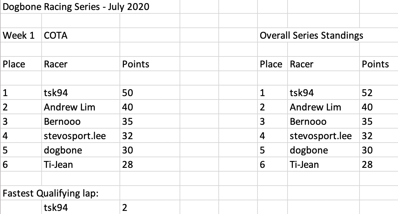

Week 1 of the July 2020 Dogbone Racing Series is complete! Visited COTA. It was a night marked by restarts. Normally, I don't restart races......buuuuut, two race restarts were required. The first restart came from someone logging into the server 4 turns into the race. We all decided to start over to include him so we restarted. Then after the second start, during the middle of the race, the game server mysteriously booted 4 out of the 6 people from the race....never saw that happen before.....so we restarted for a third race, but with less laps. We got through the 3rd race.
The M3 E92 GT2 is new to us and is an interesting platform to drive. When I first started driving it, I hated it---especially with no ABS. Once ABS was added onto the car, I was liking it a whole lot more. I'm fine with it now.
tsk94 continues to drive solidly. He won both qualifying and the race.
(Ti-Jean got disqualified by the game because he cut the last corner and didn’t have time to slow down to serve the penalty before the finish line. I’m giving him 6th place points because we had so many restarts, who knows if that would have happened in an earlier race.)
(I’m considering moving the results of the online racing results to a new thread over in the Sim sub-forum.)
