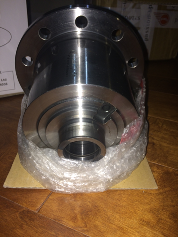

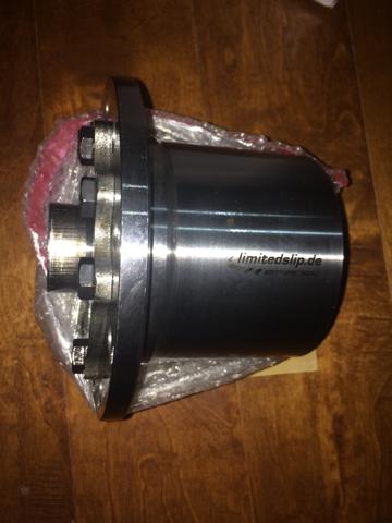

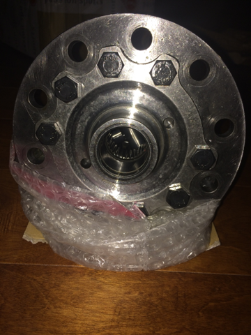

Finally US Customs released the package and this beauty showed up at my door steps Saturday.
Will be a while before I get it installed, and will post results when I do.
The unit is solid to say the least. Housing is machined and feels nice and sturdy.
