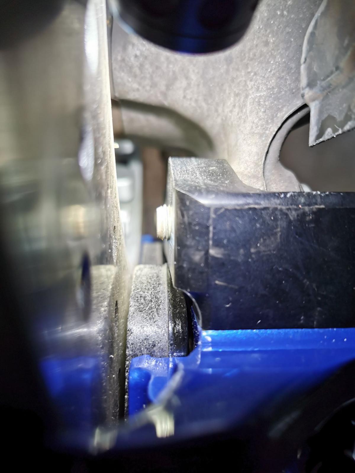

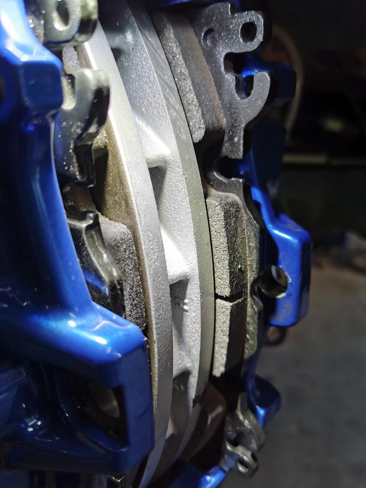

The calipers I had I wasnt happy with the logo (I asked for red they were delivered more like a orange colour) he didnt offer me any assistance after waiting 4 months for them. I decided to sell them then buy a 2nd set which he was going to engrave and powdercoat the logo in red but after 6 months never delivered with no excuse even to this day
I sold my original calipers, now the buyer has issues fitting them the pad clashes on the caliper mount/brackets..
(see how the right pad doesn't sit into position properly like the left pad)
(right pad is clashing with caliper mount)
Had to get a machine shop mill out a relief for pad clearance. This is ridiculous considering this is a pnp kit and it wasnt exactly cheap.

I think it's a good thing that he's been blocked from this forum so this shonkster doesn't waste other people's time and rob them of their hard earned money for his poorly manufactured kits (that's if they ever received them!)...

That sucks. I would imagine Slon ran one batch of brackets that were all the same. Mine was plug and play, no bracket modification needed.
Regardless, you've gone through enough regarding these brakes, sorry you ran into more issues.
Is this person running the 380mm F8x rotors? If so, he needed to use the included spacers.
Is he using the correct brake pad size?
Edit: That brake pad shape looks like it's for the 380mm setup. Pad shape D1426, so make sure it's getting installed on a 380mm rotor with the bracket spacers. Your second picture should show a spacer between the caliper and bracket.

He use to offer all kits as a modular bracket, this had a spacer which allowed you to run either 360mm or 380mm rotors.
I specified i was using 380mm F8X ///M rotors and he sent these brackets which he said wont require any grinding etc they'll fit better for 380mm rotors

so about $500 (less than that after rotors) for a crucial safety part from a ghost with a track record of sending janky parts that don't fit correctly.
i don't think i've ever seen a more poorly executed critical safety product on these forums. he makes great dct pans, he should stick to that. if i had to guess, he's pairing calipers from cars he thought to be compatible. however, small changes to the model were made and the oem spec for the caliper changed ever so slightly.
