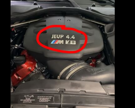

BAD NEWS!
So before I did anything else I wanted to look at the filter after yesterday’s run so pulled the filter out... and it’s bad news. When I replaced the oil 10 days ago the screen was clear when I washed it in gasoline. Just a few bits of gunk/thicker oil. Also the oil pan has metallic drain plugs just in case. So from the to now either the lifter has collapsed or a bearing is going. It will be dropped off at the BMW tech tomorrow for investigation. I have contacted the original engine builder and let him know that there is something happening in the engine and it maybe rod/bearing related...
Shiite, looks awful. Really hope you get the engine builder hooked up and you nail the issue. Keep us posted.
I really hope I'm wrong . But from the situation (metal shavings) in your pics it's already too late ...
Agreed. With what's in the container there are metal, aluminum and copper colored flakes so it's at least 1 rod bearing!
No good mate . Just be prepared for the worse . I'm sorry man .
OFC I wish you the best of luck !
