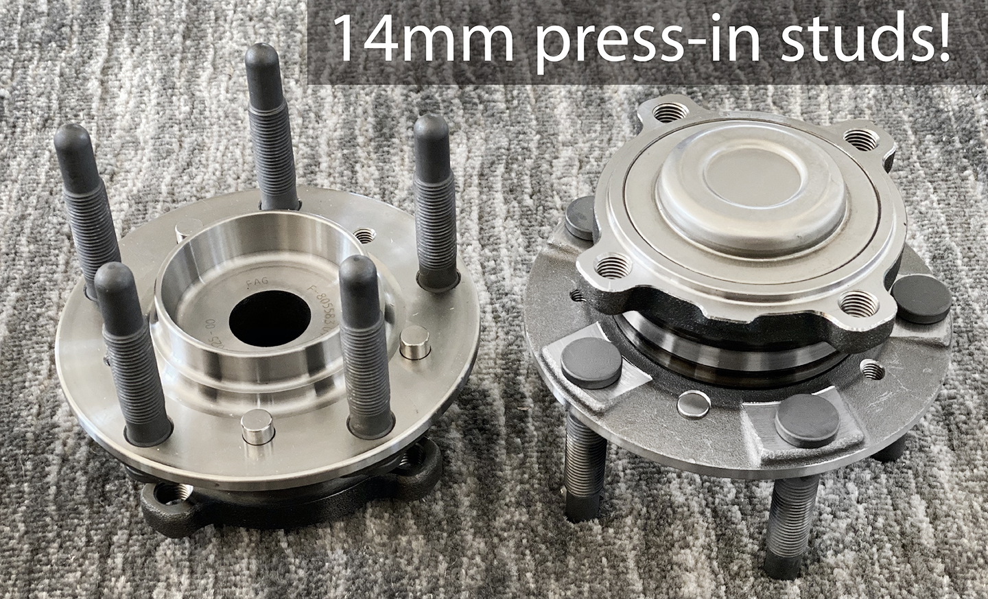

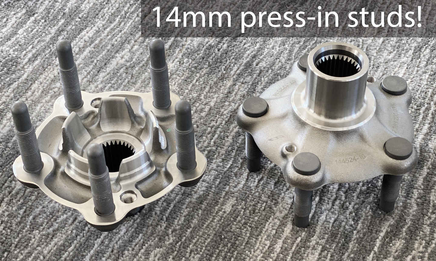

I've been sitting here wondering if I should keep posting about race car stuff with all the craziness going on in the world. But then I figured, we're hunkering down and looking for things to pass the time......what's a better way to pass the time than talking about our hobby!?
As you know, I've been on the hunt for the best/strongest possible solution for attaching wheels to an E9x M3. I believe I've found the strongest solution to date: 14mm press-in studs. I asked Core4 to investigate the topic of 14mm press-ins for our platform and Tom (the owner) decided to do the homework and see if it was feasible. After a bit, he came back and said that it was possible and that he would make a set. I am very happy to tell you that I received these babies recently, and they look awesome! Check them out below!
These are F.A.G.-brand E9x M3 front hubs that have been drilled out to accept the MSI 14mm press-ins. And the rears are F80 M3 hubs that were already 14mm that have been adapted to accept press-ins. I've been using F.A.G. hubs for years. They've been great. They're the OEM supplier for front hubs for our platform.
So why press-ins? Press-ins alleviate pressure in the spot where many people break studs----inside the hub threads. A press-in doesn't have any threads in the hub, so they don't rely on thread tension in the hub to hold the whole wheel system together. They have a large flange that simply puts pressure over a large area---around the hub hole---on the back side of the hub. They don't have to reduce the thickness of the shank with threads in what appears to be the most critical spot. The shank thickness inside the hub hole of these MSI studs is 14.7mm!!! If you look at the actual shank thickness of a 14mm stud---meaning accounting for the reduction in shank thickness due to the threads, it's around 12.5mm. A 12mm stud shank is even worse at around 10.5mm......The press-in offers 40% MORE METAL DIAMETER AT THE HIGHEST STRESS POINT than a threaded 12mm stud!!!! And around 18% more metal diameter than a threaded 14mm. In my book, the more metal you throw at this, the better. The F.A.G. hubs take the drilling without issue----and if you look at the back side, you can see each hub hole is already reinforced with additional steel. The press-ins are quite happy sitting there.
And as far as cost, the whole solution with 4 hubs, MSI studs and lug nuts is less expensive than the Future Classic solution without studs/nuts.
So, there ya go----strong and reasonable cost!
I'm sticking my neck out here with my opinion------if you drive an E9x M3 hard on track with high grip tires, aero and other go fast bits, I do not think 12mm threaded studs are the correct solution for this platform. Many many people have had problems. We're not all morons. We're not all doing it wrong. Heck, the F80 M3 moved up to 14mm. Would the 12mm press-in studs from Core4 be enough to resolve the situation? Possibly. Core4 claims they have never had a customer break a 12mm press-in stud yet----even with multiple cars in 25 hour races, one of them being a big 'ol Nissan GTR. But I wanted what we could consider to be the ULTIMATE solution, and I believe this is it. (If anyone else is interested, they are available now.)
The original plan was to install these in early April and test them in Texas. (My car is sitting in Houston right now.) But, with the world in chaos, everything is up in the air, so we'll have to wait to see when is an appropriate time to put things in motion again.
Here's a quick video that shows the process of swapping press-in studs. Pretty easy.

The last question we need to answer with this setup is with the rear hubs: Can the rear studs be swapped on an E9x M3 without removing the parking brake? Don't know yet. But given the size of these studs, I may try to go two seasons with the rears. So, it's not something that will need to be dealt with very often.
Anyway, I'm excited about these hubs/studs, but I'm not the expert. I may ask Core4 if they can come on here and clarify anything I may have goofed on.
Stay healthy everyone.

i'm surprised at how easy the press-in stud install is. for some reason, i was under the impression that the hub needed to be removed.

yes, please keep posting. we need this normalcy.
That install was one of the easiest things I've seen, and completely did not expect it lol
Yup, no loctite. No having to use an Allen hex key on the stud trying to get to 20 ft lbs, and then stripping it. No having to double-nut studs to 40 ft lbs.......all that stuff is history with press-ins. No waiting around for loctite to set.

-install the Core4 14mm press-in stud hubs.
