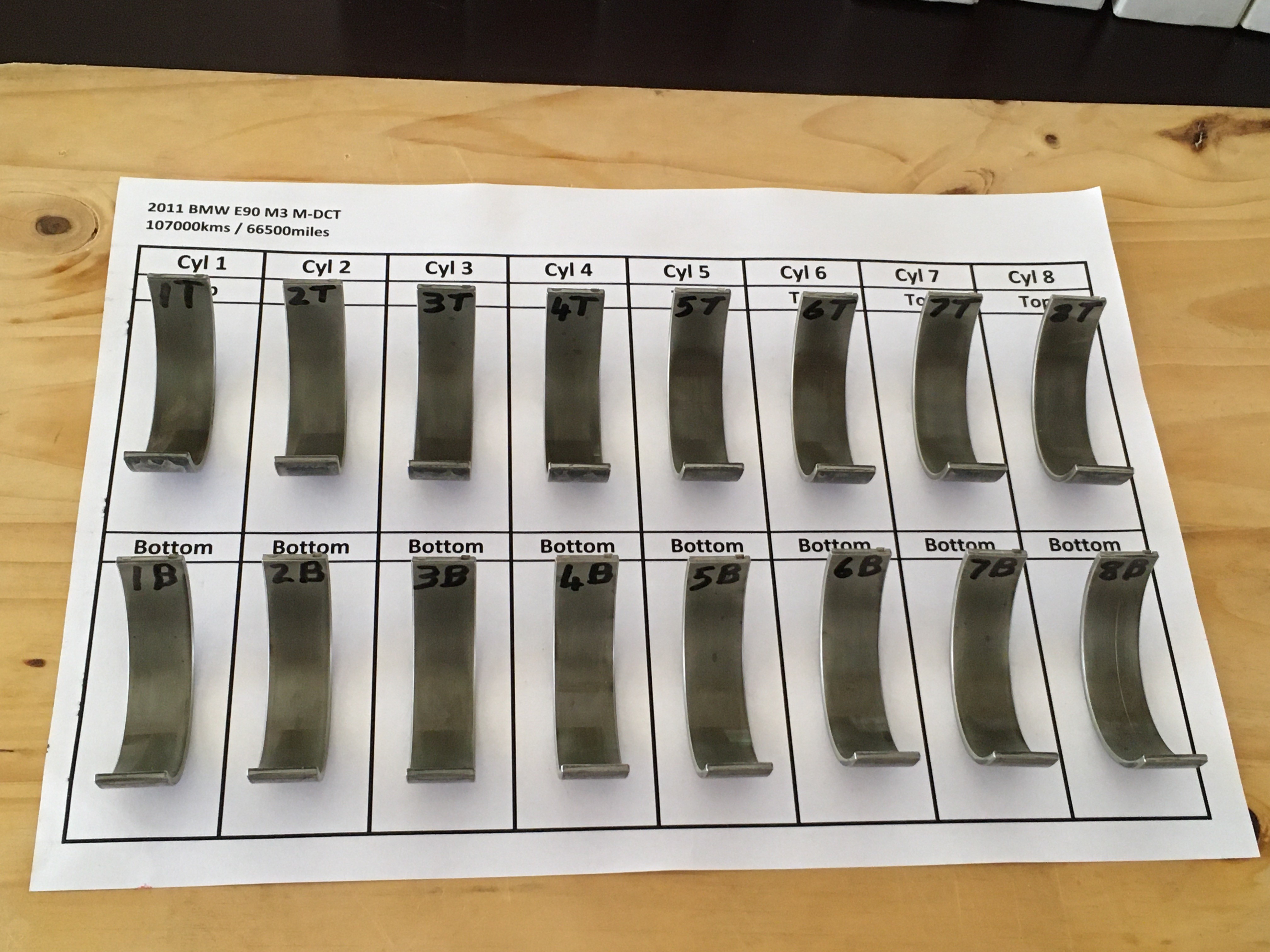

I replaced my rod bearings in December 2019:
[IMG]http://www.bmwfanatics.co.za/uploads...2316922585.jpg[/IMG]
Year and mileage at change? Not sure if you posted that info earlier. Those bearings look clean but the photo is not the highest quality.
Paper says 2011, 66.5k? Yeah, looks clean.
That is correct
