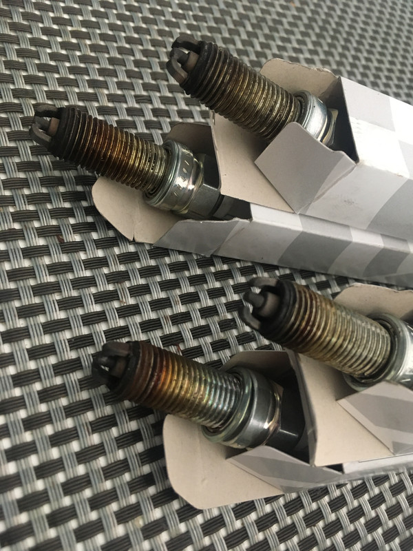

Changed my plugs because I forgot to do so for a lonnnnng time. Some wonkiness on downshifts that I thought was maybe my transmission leak was actually just ancient plugs added the helpful BMW sticker to the inside of my hood to remind my dumb ass to not wait 70k+ next time
Car sounds (and pulls) a lot better!
Managed to do it just fine without removing the plenum or anything other than the airbox. Was a little tight, but took me about 4 hours doing it my first time, mostly because my extension set is old and loose so I had to keep trying weird things to get the damn spark plug head off the plug for the back 2 cylinders on each side.

Originally Posted by fatalelement View Post
Changed my plugs because I forgot to do so for a lonnnnng time. Some wonkiness on downshifts that I thought was maybe my transmission leak was actually just ancient plugs added the helpful BMW sticker to the inside of my hood to remind my dumb ass to not wait 70k next time
Oil on the thread of old plugs it is not good as for me...
Maybe the valve cover gasket should be changed?
The S65 valve covers have a tendency to warp once you get up there in miles (per Malek and another guy who I go to who specializes in M cars). They're on my to do list - mine are definitely leaking.

Originally Posted by pbonsalb View Post
That gap opened up a lot. It actually opens up a lot in the 37k mile recommended change interval. Probably 25-30k is better given that knock control is through the plugs in these cars.
Yeah, this was probably close to 90k by the time I changed them. Far from ideal. Valve cover leak is very light but I'm not surprised that the plugs looked this way given how long they were in.
Previous owner did not record the change but the selling dealership said they were done recently, but when I finally had them pull the records, that was incorrect (which was why I did this immediately). Stupidity on my part.
I generally keep good self service records but I wrote down that I did it when I had not. It was planned and I did not indicate that as I normally do in my notes so when I took it to a specialist for another engine service I misremembered that it was done. Dumb, but the engine seems to be doing fine and is definitely smoother on starts now.

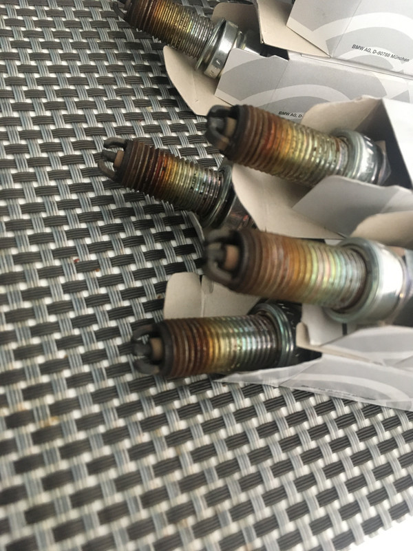

Also decided to change sparks, the old ones looks like this (37k km):
