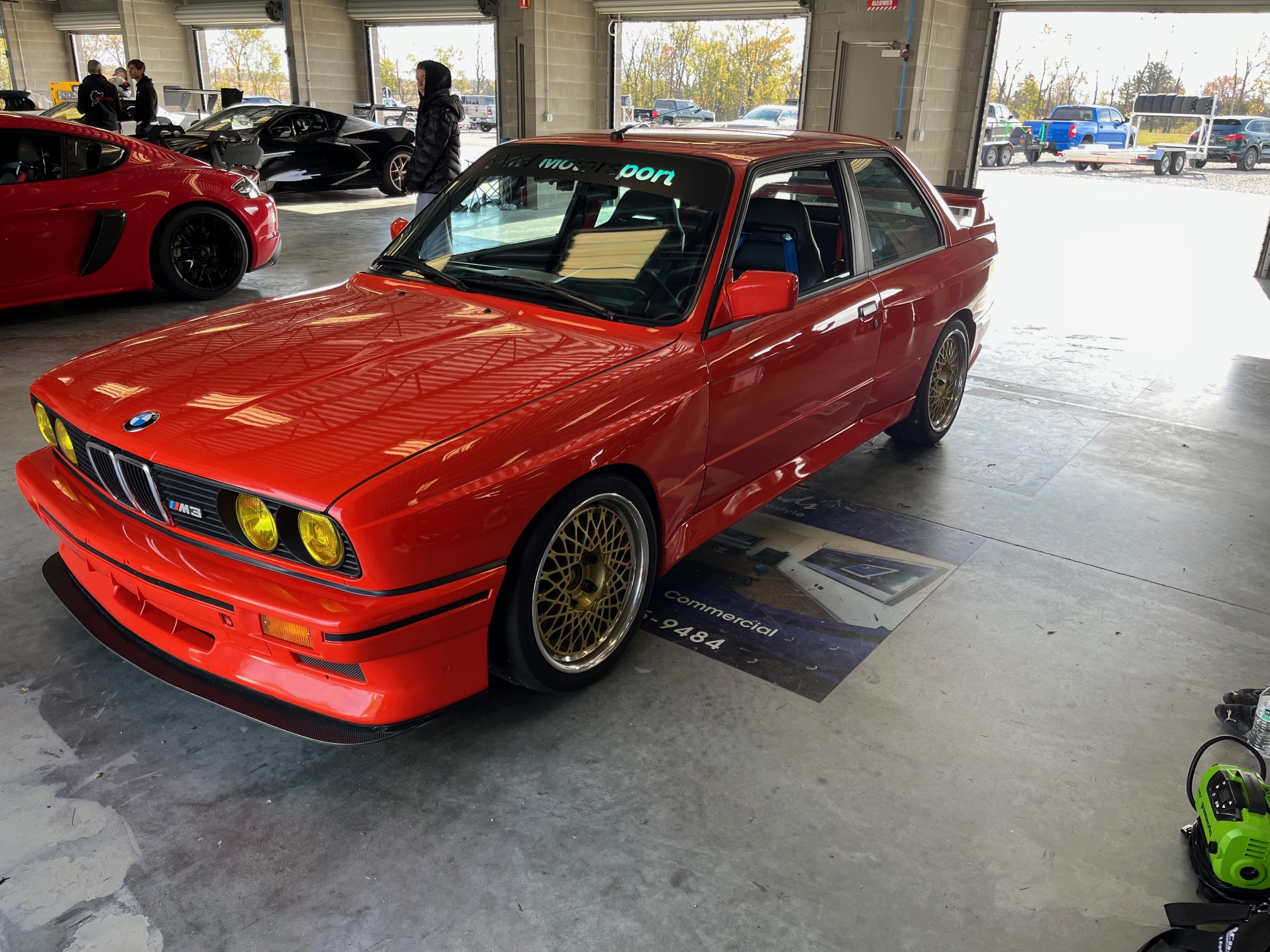

I was working with KW Motorsport for my E30 M3 Group-N track build as well, they offer an inverted monotube setup with the hard to find, all new front spindles.
I ultimately went with the original Bilstein motorsport shocks though, as I wanted to keep it very period correct with the motorsport valved inverted shocks from Bilstein, but KW was nice to deal with regardless. Their willingness to build whatever I wanted was nice, whether it be V4 or V5.

Beautiful E30! My dad and some buddies built a Group A/DTM replica build back in the early 2000's - had the 2.5L S14, dogleg box, carbon body panels, modified suspension pick-up points, the works. Seriously quick for what it was. I'd need to ask them what they ran for suspension, but I thought it was some sort of custom Bilstein's...
I do often forget that Bilstein does offer custom motorsport dampers, like KW's program. You just often hear even less about it. But their off the shelf Evo R and Clubsport stuff is very nice. I was quite close to getting the Bilstein Clubsports for my original M3 build based on this thread..!
