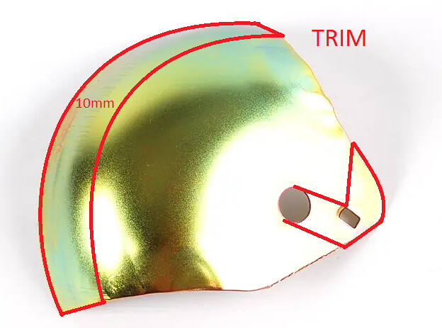

Well. replaced my mounts with OE replacements and this time around decide to add a protective shield to see if it will help "prolong" the life. I believe premature failure is due to heat. Headers are right there.
Oddly enough the e36M and e46M both had shield on their mount, they also had mount failures but I seen reports on e9xM fail as soon as 35k-ish miles.
I ordered e36M shields and modified them, see below. https://www.ecstuning.com/b-genuine-...e/11811138228/
enough said, here are results:
[img]https://live.staticflickr.com/65535/...aa32dbc315.jpg[/img]mount3
[img]https://live.staticflickr.com/65535/...6eb01ee6_z.jpg[/img]mount1
[img]https://live.staticflickr.com/65535/...37fbc3c0_z.jpg[/img]mount2
[img]https://live.staticflickr.com/65535/...1b7ce047_z.jpg[/img]cover1
[img]https://live.staticflickr.com/65535/...82027c53_z.jpg[/img]cover2
Cut
