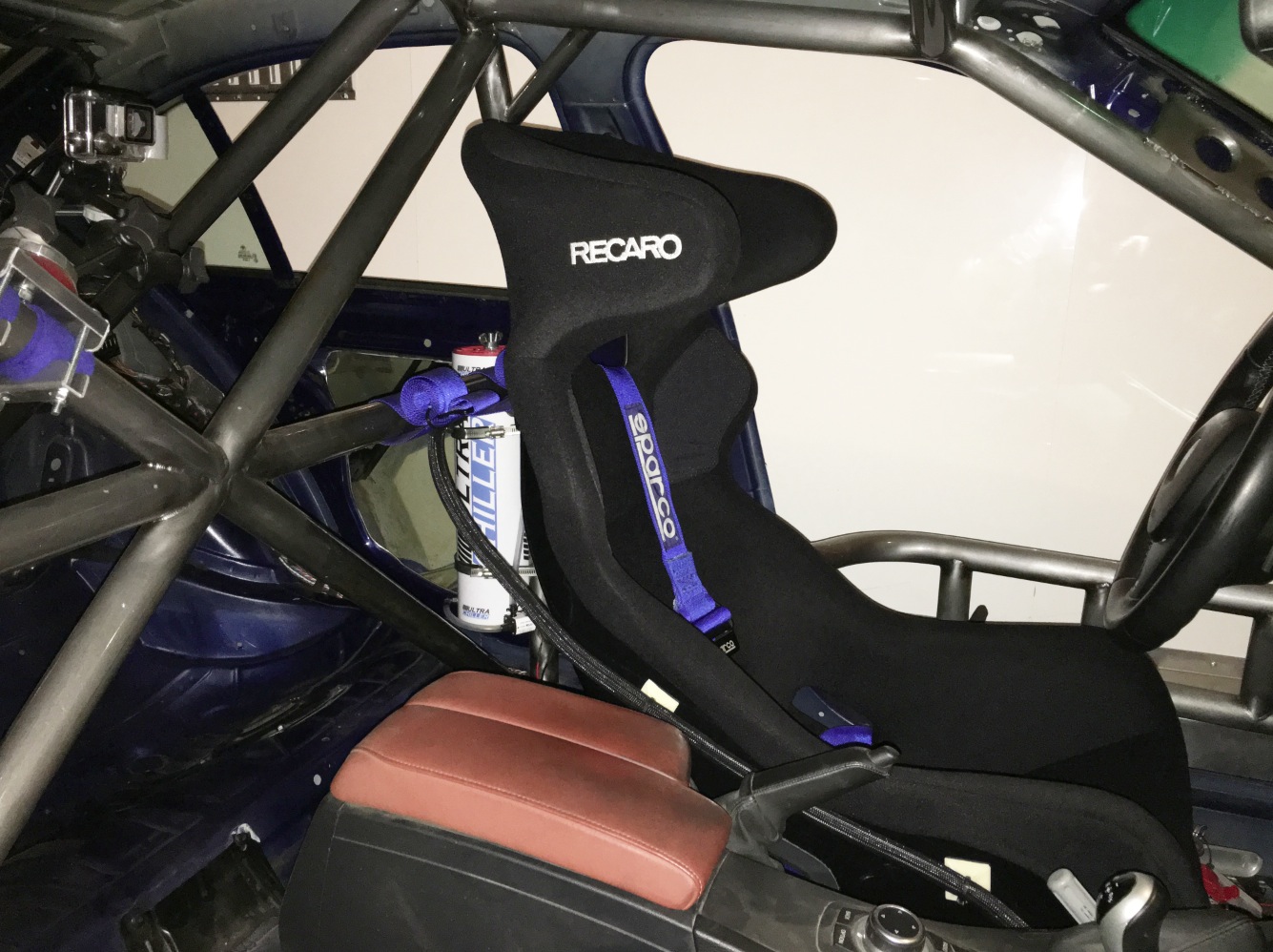

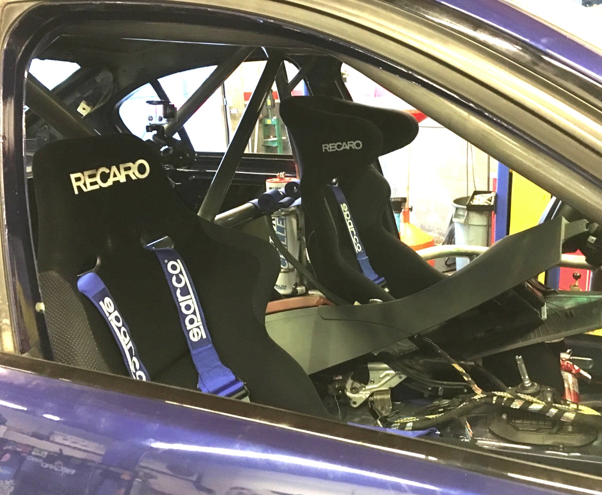

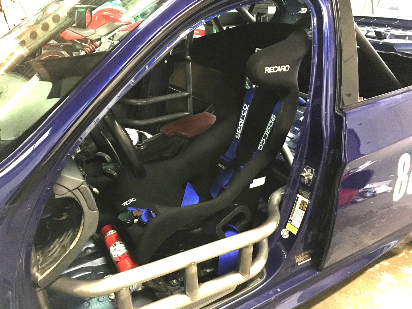

Mod 1: Halo seat. This past summer, I bought a Recaro SPG but it was not a Halo seat. I have felt that the Halo feature was the last piece of the puzzle in terms of safety that I was missing. So, I bought a Recaro Pro Racer SPG Fiberglass. They call it an SPG, but it's not really the same seat. I had assumed it was an SPG with a Halo added on. Wrong. It's narrower than the SPG, you sit deeper because the sides are quite high---or at least the sides feel higher because the padding is thinner, the shoulders fit tighter. None of this is bad. It's just different. Honestly, I don't know why they gave it the "SPG" same. The one thing I like I REALLY do like about it is that the slot between your legs for the buckle/anti-sub straps sits 2 full inches further away from you than the SPG. This keeps the straps further away from your crotch which was a welcome change. Also, compared to an SPG, the Halo seat mounting holes sit you 1 inch closer to the steering wheel than my original SPG, so we had to readjust and move to different holes in the floor bracket.
Getting in and out is noticeably more difficult with the Halo feature. I don't have a removable steering wheel, and I don't have rail sliders. It's fine, but more difficult. I have tried to avoid rail sliders because I wanted everything locked down. And switching steering wheels is a bit of a pain because I want to keep access to the "M" button. Apparently, the "M" button has a special coded signature, so you can't just replace it with a generic alternative. Ultimately, we may look at moving the "M" button to the carbon fibre blank panel so a removable steering wheel is possible. That's a project for another day.
Anyway, I am very happy overall with the look, feel and safety of the new seat. I'll be on the track with it in 2 days. Looking forward to it!
Mod 2: Passenger seat. I installed the SPG over to the passenger side for now. I don't think I'll run a passenger seat all the time, but I figured I'd put there for now. It's easy to remove. The passenger seat adds about 30 lbs to the car….

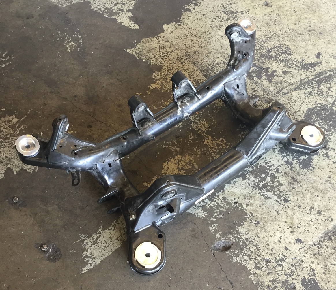

Mod 3: Rear Sub-frame bushings. Ok roastbeef don't get too excited! They're in!! I went with Macht Schnell aluminum bushings. These things are SOLID chunks of aluminum---no holes, no gimmicks to make them lighter. Man, what a crazy job. I watched as the guys at minicorsa removed the subframe. Wow. That is a LOT of work. This is an expensive and very involved mod to the car. I haven't driven it yet, so i can't tell you what I think of it, but I'm curious. It's scary to see the underside of your car with nothing but heat shields….

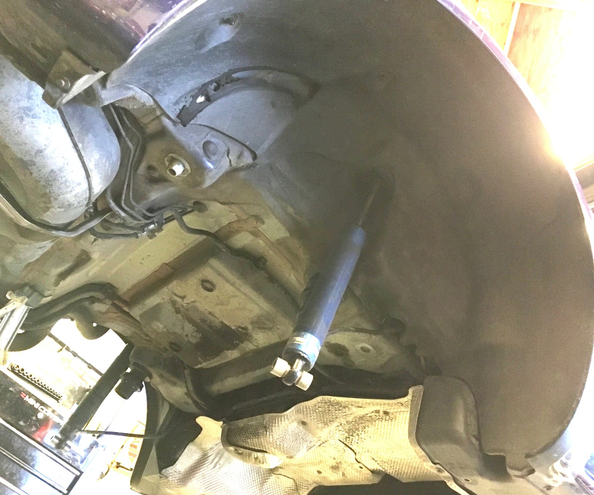

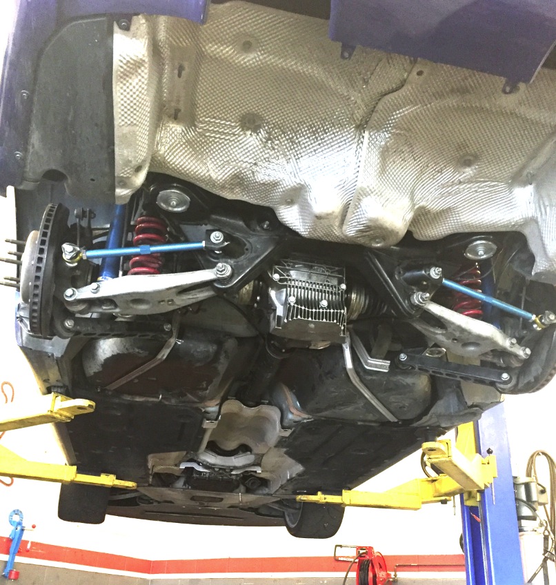

Mod 4: Rear Toe Arms. Because we lightened the car so much with the gutting, the suspension pushed the car higher, so we had to lower the car to get back to an appropriate height. As we lowered the car, we were struggling to be able to dial in the toe we wanted. So, we put in Rogue Engineering Rear Toe Arms. They're the blue arms in the pic.

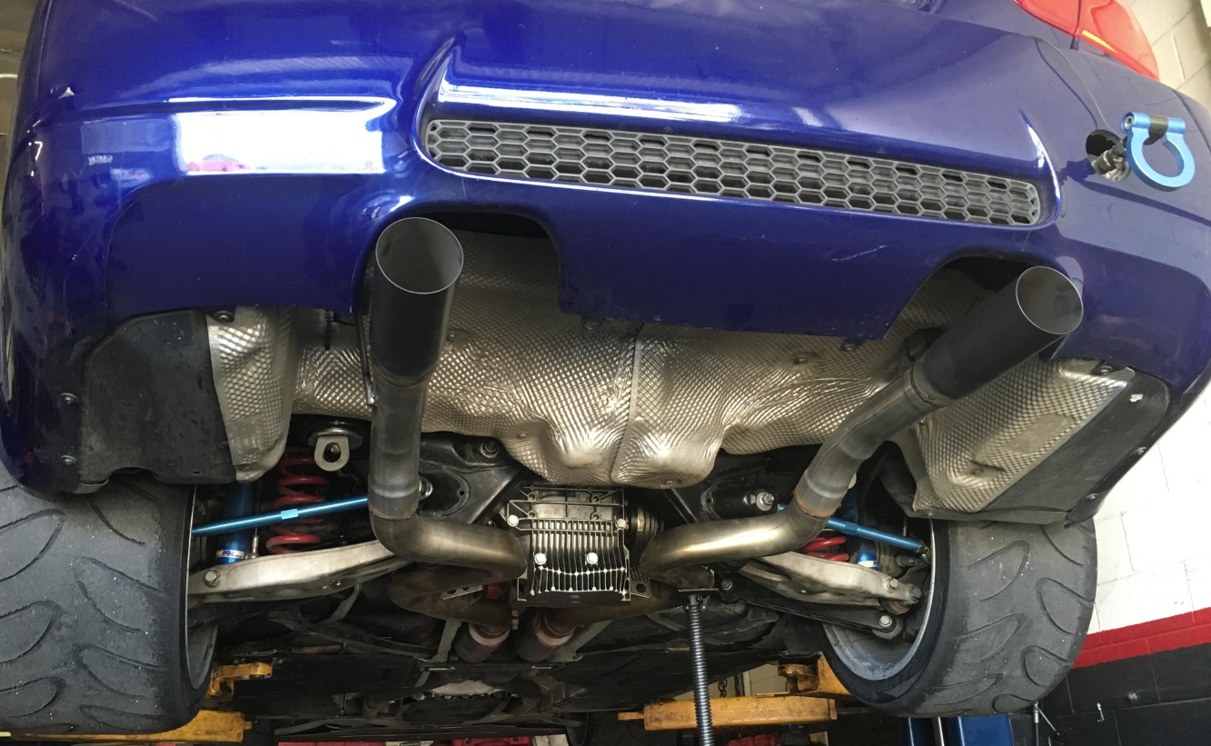

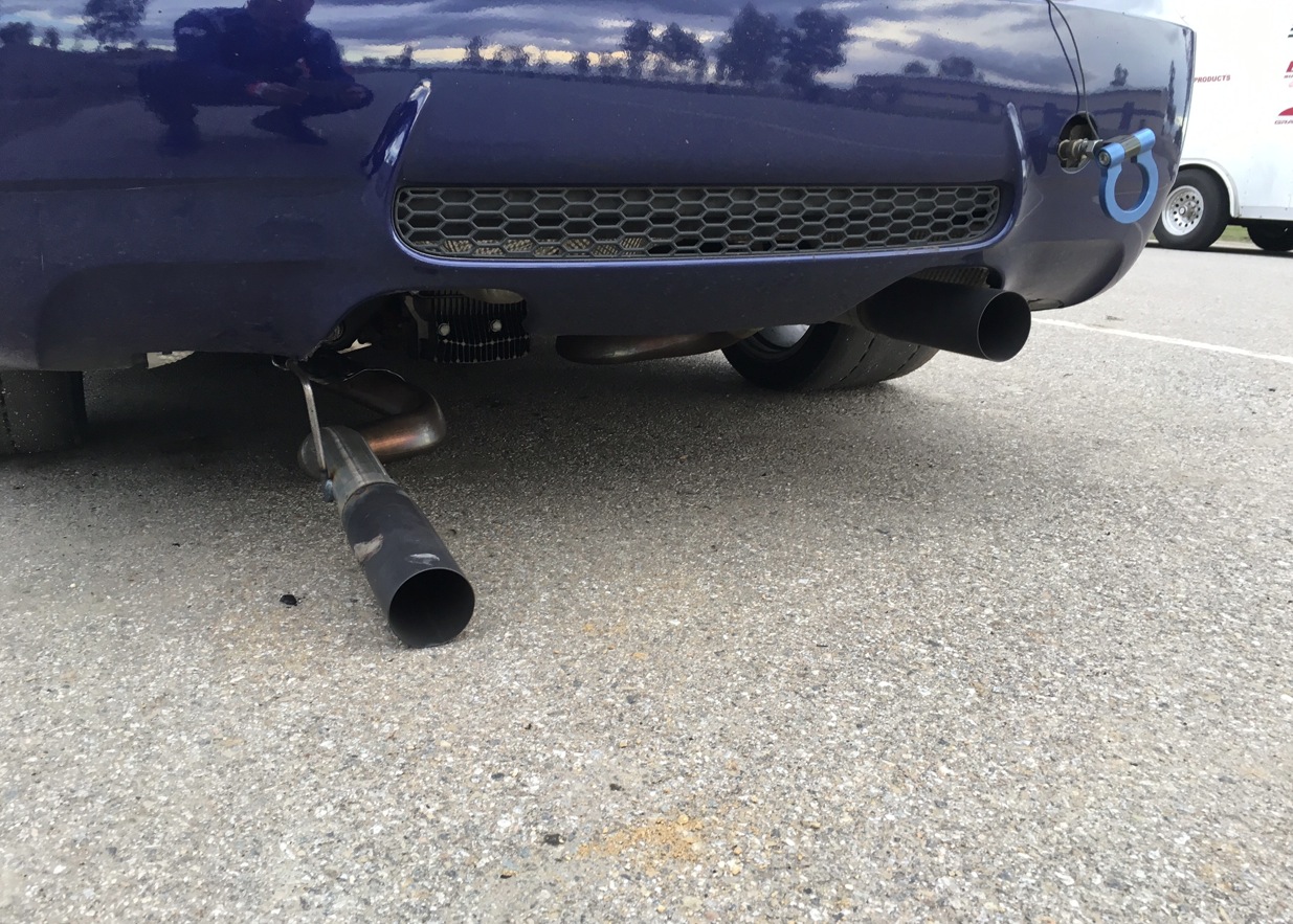

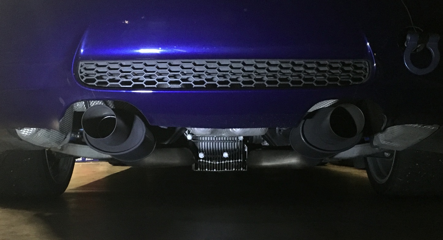

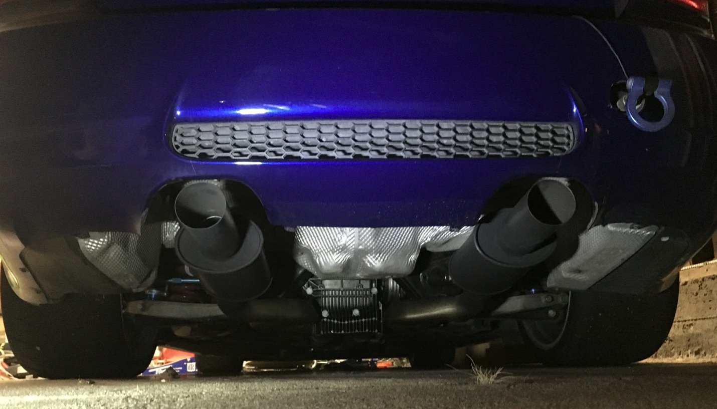

Mod 5: Exhaust. Everyone always laughs because my car is so heavily modded, but when you looked under the car, there was a stock muffler sitting under there…..hehe….I have to admit, I never really cared about exhaust much. I know that's everyone's first thing to mod. Well, in my case, it is literally the LAST item I've changed in a very long list of mods. And I didn't do it for sound or looks. I did it for weight. I decided on this first round attempt at exhaust to go as light as possible---straight out of the Akra x-pipe, to two EAS tips---no resonators, nothing. The whole exhaust, after the x-pipe, is around 14 pounds. (Stock rear section was more than 52 lbs) It's loud as hell hahahaha. And the car vibrates quite significantly at low RPMs. hehe we'll see how long I can stand it. My guess is that I will be putting some resonators in-line to smooth it out. My friend has a supercharged M3 with the same Akra x-pipe as me. He built his own muffler setup and it sounds very nice. I'll probably go that route. But it's worth hearing what this is like!

1. Halo seat: I like the Recaro Pro Racer SPG, but it really is a different seat than the none-halo SPG. It's tighter in the back and shoulders, tighter around my hips, less padding on the butt, you sit deeper into it. And because the sides are so high, the lap belts can't be propped up on the sides of the seat as you're getting in. This means you need to get into the seat and then fish them out from under you, which is an enormous pain in the ass since the seat is so tight. I'm going to have to figure out how to put some velcro on the lap belt straps and then have the other piece of velcro on the seat edge or something because I'm not going on a fishing expedition for those lap belts every time I get in the car.
As far as the actual halo feature, I found that it doesn't get in my way AT ALL. The neck restraint only lets you turn so far, and the neck restraint's limit is before the halo gets in your way.
Conclusion: Thumbs up, but will require more setup.

3. Rear sub-frame bushings: I like them. My car was already pretty stiff with the cage tied into the car, so for me, there was no night-and-day difference here. I found it to be subtle. This mod added a little more predictability to the car as it starts to go sideways. Having driven it now, I'm not sure it's the best bang-for-the-buck mod for a mostly stock car. People with mostly stock cars talk about this mod all the time. This is an expensive mod. I think your money is best spent elsewhere until the car is modded more.
Conclusion: It's fine, should not be high on the list of a mostly stock car.
4. Rear Toe Arms: Fine. No drama.
5. Exhaust: ugh, this one was a thorn in my side all day. It is damned loud. And it's not really the decibel loudness. It's the resonance that is the problem. The resonance goes RIGHT THROUGH MY GOD DAMN HEAD at all different RPMs. I had ear plugs. They did nothing. The vibrations would resonate my entire skull. ugh, my ears are still ringing today. Plus, the left exhaust had a bolt that loosened and fell off, so during the middle of the session I had to pull off because I could hear it scraping. And then, I had the awesome walk of shame through the pits dragging my exhaust. I promise no one noticed my exhaust dragging on the ground through the ENTIRE paddock. Nope no one noticed at all……..
I was planning on removing the exhaust and doing something else….I think the car wanted that too and tried to shed the damn thing. So, it's back to the drawing boards.
Conclusion: Thumbs DOWN. What? I can't hear you!

As I mentioned before, our first attempt at exhaust didn't quite work out……actually it was sort of a debacle. WAY too loud, WAAAYYYYYYYYY too much resonance at every RPM----every time you pressed the gas, you were punished with sound going right through your skull, the connecting pipe bolts that hang on the diff fell off, the rear part of the left exhaust fell and dragged on track, both tips were too close to the bumper and were melting it. Let's just say it was back to the drawing board….
I present to you-----Exhaust 2.0!! (cue music fanfare! Lots of horns! Very heroic!!)
So, the whole exhaust setup was re-setup, from the knuckles that fit on the Akra pipe to connect to the stock connecting pipe, to the resonators that are in line now, to the locking nuts for the connecting pipes, to the placement of the tips. It's basically a whole second try. And I have to say I'm much more hopeful for this setup.
It's still going to be fairly loud which I'm fine with, it will drone to some extent while idling which I'm also fine with, but at higher rpms I think this will be much more controlled. That's the main goal here: I want that INSANE resonance to be removed. And from what I can tell, the resonators will be able to do that. The tips are now slightly lower from the bumper than the first try, and they're in the center of the tips cutout in the bumper, whereas they were on the outer edges previously.
If this doesn't work, I'm tempted to slap the stock exhaust back on there……we'll see!
