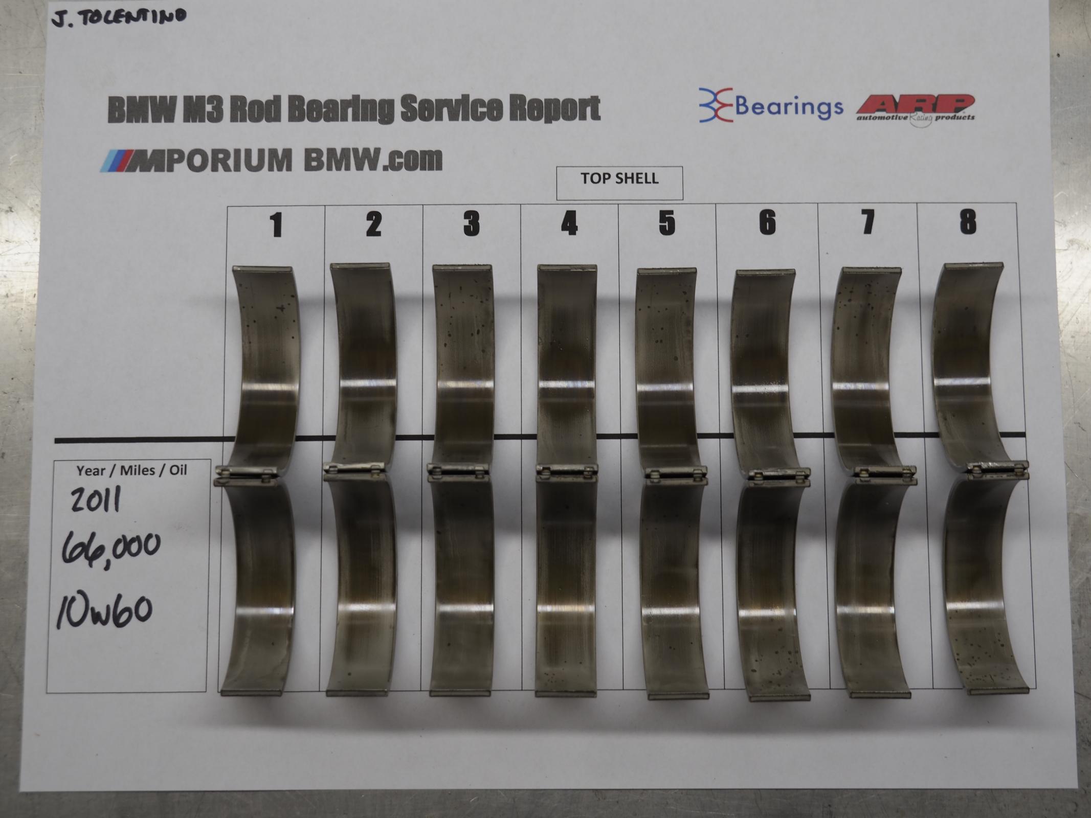

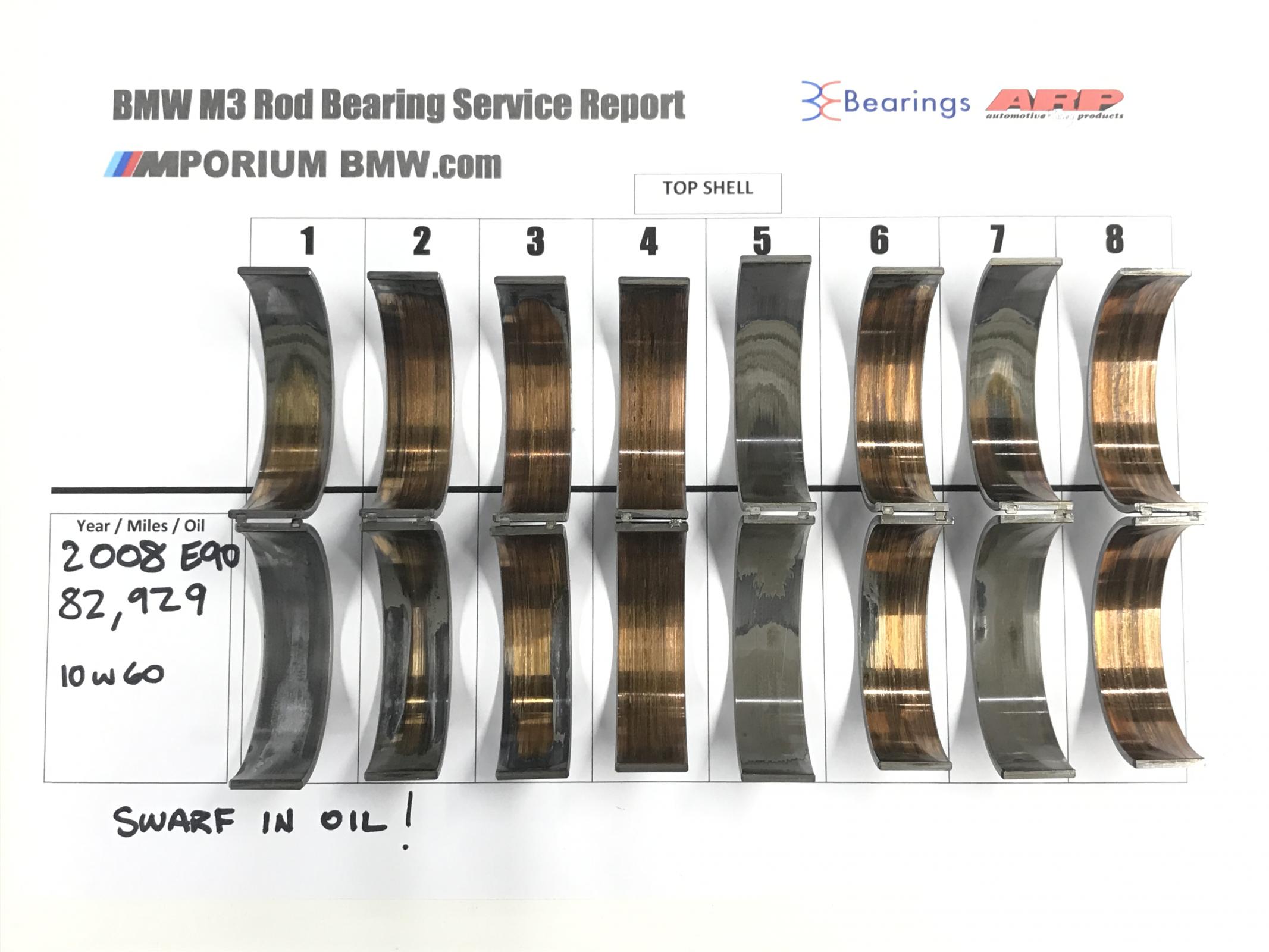

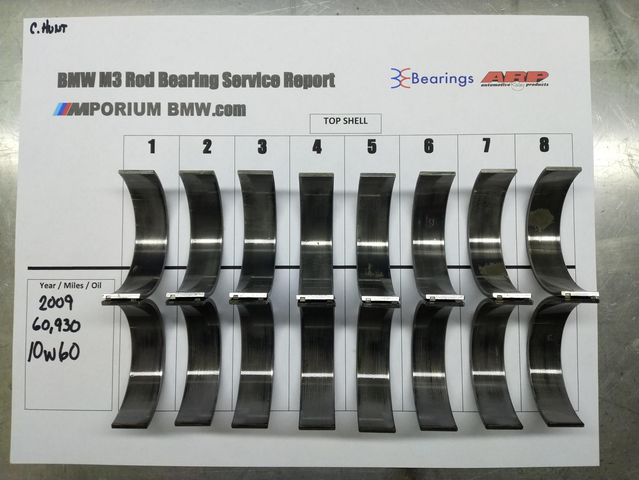

Some recent ones. The last one came in with a slight knock and metal in the oil.
CSBM53159.00
IamFODI609.50
Last one wasn't pretty. The other three sets looked quite fine on picture though, would you agree?
      09-24-2019, 09:21 AM   #1205
deansbimmer
deansbimmer's Avatar
4324
3,023
Drives: 2011 E93 M3
Join Date: Nov 2014
Location: DFW, Texas
iTrader: (17)
1988 E30 M3  [0.00]
2006 E46 M3  [0.00]
2024 X7 M60i  [0.00]
2011 BMW M3  [0.00]
Fine? No. Typical of the poor wearing S65 bearings we see most? Yes.
The engine from the last picture has to have a full teardown and rebuild now.
Definitely not good.
