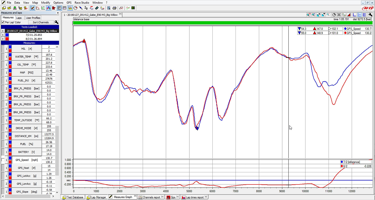

Let's file this one under---I SWEAR I'm not crying in my spilled milk.....I promise! Well, sorta....... Seriously though, this video shows the best driving I've done at WSIR until I encountered the Mustang at Turn 9, so it's worth at least a quick glance. (I mentioned before that my GoPro battery died before my complete PB lap, so this is the only vid I can produce that shows the same-or-better speeds.)
The lap ended up as a 1:26.8, even with with having to pass the Mustang in Turn 9. Up until I encountered the Mustang, the lap was a 1:25.5 pace.
Here's what it looked like in the AIM software. You can see in the time delta chart at the bottom that the lap was faster than my PB of 1:25.85 (that I had just set 5 minutes prior) the entire time until I came upon the Mustang.
It's interesting that Mustangs have blocked a new PB fast lap at WSIR on three separate occasions. No other vehicle has ever blocked a new PB lap at Willow Springs, and yet somehow, a Mustang has been in my way each time.

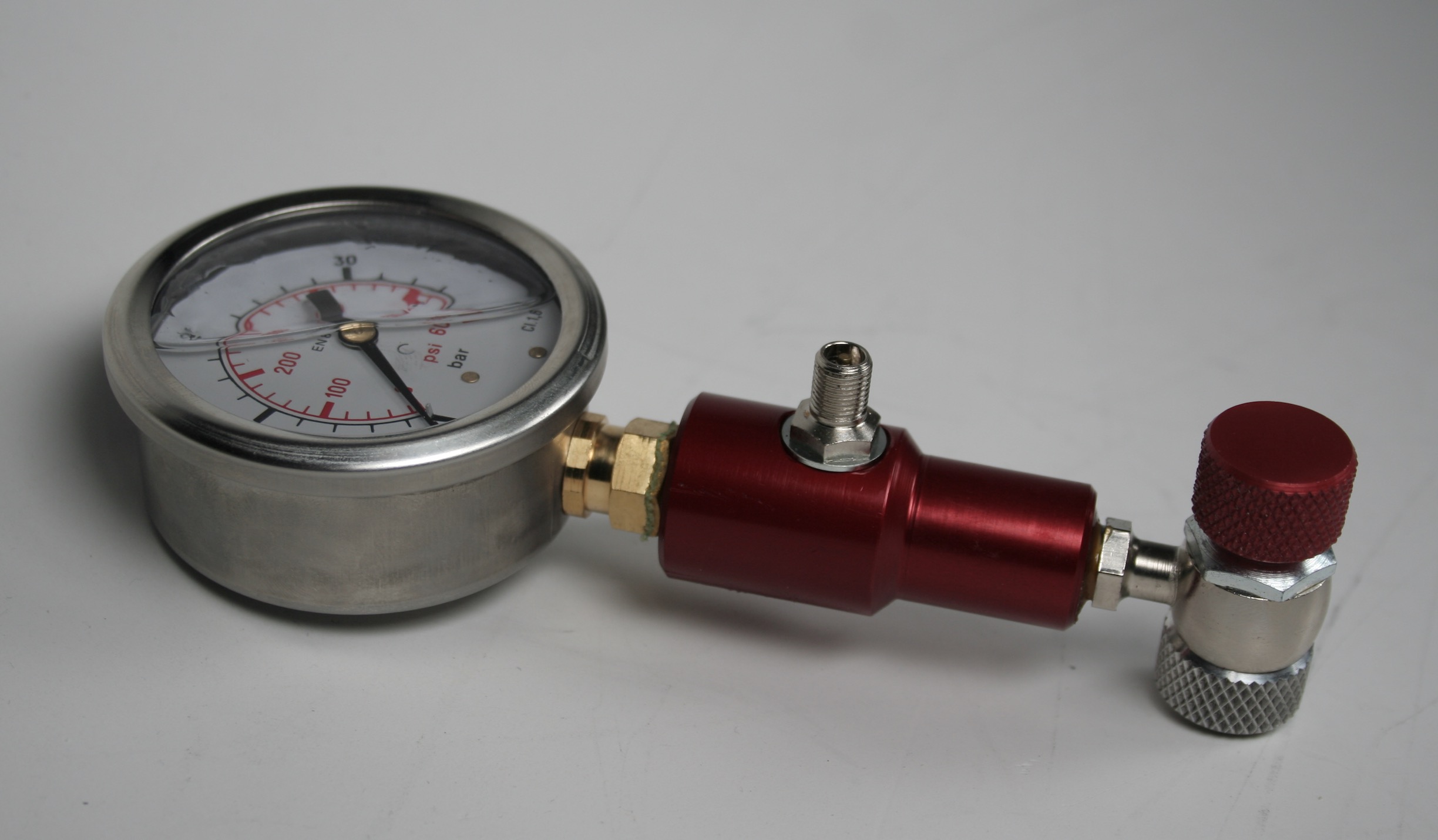

ummm the nitrogen rig as it is setup right now is not super convenient for quick tire filling.
The schrader coupler pictured below is a necessary and excellent part of my nitrogen rig for suspension filling. However, it does not allow you to fill a tire quickly. It requires you to it turn the lower nut to screw it onto the Schrader valve, then you need to use a wrench to make an air-tight seal, then you need to rotate that plunger on the top to actually depress the spring loaded valve in the Schrader valve. Then you need to turn the handle on the regulator to allow nitrogen to flow. Then you need to reverse all those steps to disconnect.....it's a lot of steps to disconnect, and then you need to move on to 3 more tires.......not very convenient. Especially, not compared to a ball chuck that you can just press onto the Schrader valve. That's instant.
Now, if you wanted the rig to do double duty, I guess you could put a quick disconnect on there, so when you need the rig for the suspension, you put the Schrader coupler on there, and when you want to fill tires to swap to the ball chuck. But I have found those air quick disconnects to leak a bit at high pressures and that would not be ideal when working at 300 psi on the suspension.......
I see you've been talking about nitrogen for tires on some other threads. For me, it's just not practical. To get all the oxygen and moisture out of a tire, and just have nitrogen in there is a pretty big commitment. It's not just a simple matter of installing the tire and then putting nitrogen in. Remember the tire has "regular" ambient air sitting in it once it's installed. You have to have a special bleeder that can allow you to fill a tire with nitrogen while simultaneously pulling the "old" air out. And a tire has a MUCH larger volume area than a tiny suspension canister. And sometimes, they have to put a LOT of air in a tire to get the beads to seat. So you're going to go through a LOT of nitrogen.
And then the biggest issue for me is that I don't leave tires on for very long. For instance, just yesterday, I flipped the rubber on a set of rims after just 5 heat cycles. I want the tires to last as long as possible, and since Auto Club is SO PUNISHING to the outside edge of tires on the passenger side, I had the tires flipped. All that nitrogen setup in the tires would be gone after 5 runs......
Sure, from a theory standpoint, nitrogen in the tires could be great----you'd get better consistent pressures....that's why they put it in suspension canisters. But in tires, it's really only practical for a racer who has very solid support because someone else is dealing with all that crap. For a hobby guy like me who shows up to the track and does my own support, it's just way too much commitment.
Your question is timely for me. I'm actually in the middle of write up on my nitrogen rig and my approach to nitrogen in suspension canisters. I am super slammed with moving right now though, so I don't know when it will be done. I promise though, once it's done, it will solve ALL known cases of insomnia!
I have that same lossless valve and stripped mine today, the nut spins but doesnt' necessarily unscrew. Then I had a few of the schrader valves get tight to the lossless chuck and pull out of my coilovers so I had to loctite them in and start over.
There has to be a better connection tool than that lossless chuck. I did buy some extensions that can help, but I have adjusted my shocks a few times, filled my tires nitrogen and that chuck is junk already.
A lot of the shock filling tools out there use that very same piece that you're having problems with. (I would have recommended Powertank to you, but they use that same piece! I think the MCS tool uses the same piece too.) My tool hasn't broken on me, but I do replace it every couple years. It did remove the JRZ canister Schrader stem once. I re-installed the stem and it hasn't happened again. I have found that you don't have to super tighten the filler tool to the Schrader valve. Just a modest amount of torque is enough.
JRZ used to make a shock filler tool that I think you would have liked. Here's what it looked like. I don't know if they make it anymore. As I recall, it wasn't cheap. I can't find it anywhere now. You might want to contact JRZ directly to see if it's still available.
